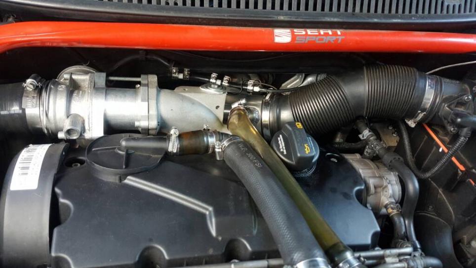

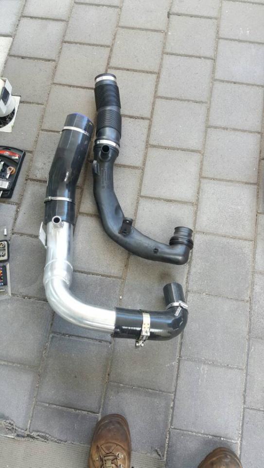

                            Finally have the time to install the TIP on the car
                            Couldn't get the hose the gose to the MAF to fit at the correct angle because there is an fitting issue with the alloy pipe
                            To fit the alloy pipe as designed the ASV can't be reinstalled(need to be removed to fit the TIP), so I had to turn it a little bit on the bracket and used the the old plastic pipe to connect the MAf and the alloy pipe
                            This is how it ended up
                            Might need to go back to the catch can routing again because the angle of the inlet is changed
                            Already see some oil seeping around the filler cap

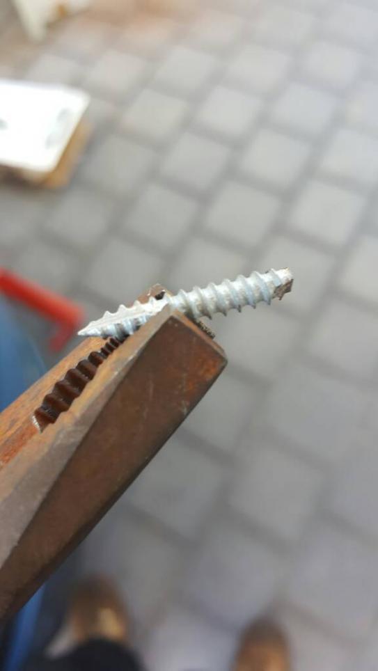

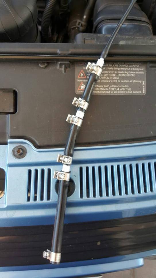

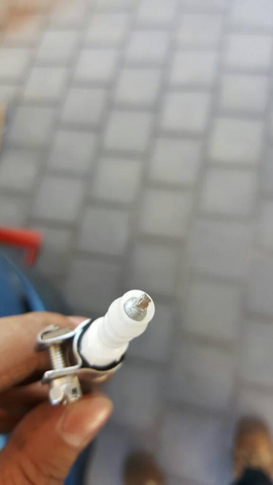

                            Solved the the boost gauge needle rattling issue with some self tapping screws and vacuum hose joiners
                            That is 2 extra joiners and 5 screws in place as dampeners, and I already have an inline restrictor near the gauge!!
                            That turbo pulse is crazy
                            Also serviced the car while I was at it
                            Gave it an engine detox and intake decarb as well
                            I think the really freed up some moving internal parts because now the car is very responsive in low revs
                            Happy driver again (for now)
                            06 Polo TDi
