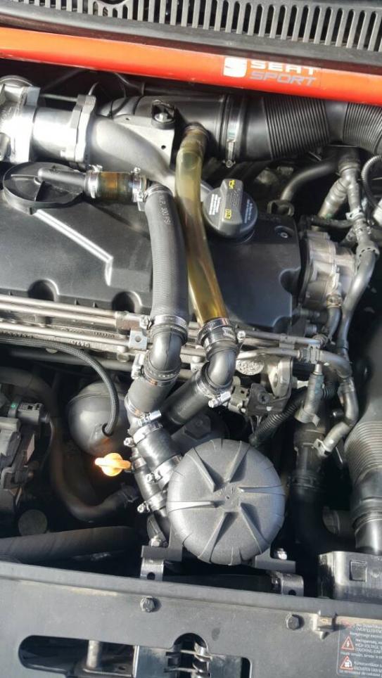

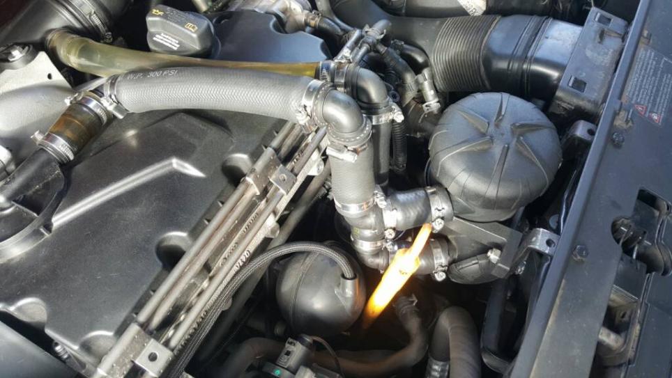

            • Finally found a good place to mount the ProVent 200 without getting the way of other component
              Two mounting brackets from Bunnings and it's done
              Also changed the filter element as the system is starting to bypass after 41k+ kms of driving
              06 Polo TDi
              • Originally posted by TDIfan View Post
                I just saw on the news that there's a shortage of 30mm Jubilee clips in Perth, No anything about that??
                Good work though.
                • Haha thanks Gavin
                  The diesels have loads of blow by so kinking the hoses are not going to end well
                  Unless there is a batter routing solution, those clips are staying with me:p
                  06 Polo TDi
                    Haha thanks Gavin
                    Just having a bit of fun. Hey, on the clear pipe have you an extra clip around the fuel pipes?
                    • Originally posted by h100vw View Post
                      Yeah that one is supposed to go on to the TIP joint
                      Don't worry it's where it should be now
                      Only realise that after taking the photo
                      06 Polo TDi
