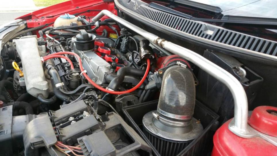

              • Got my cheapo SAAs pod filter and silicone elbow to make a pod in a box, for no other reason than to make whooshwpppsh noises.
                • Finallt got some TT Ronals on.
                  Sorted the bay a bit more as well.

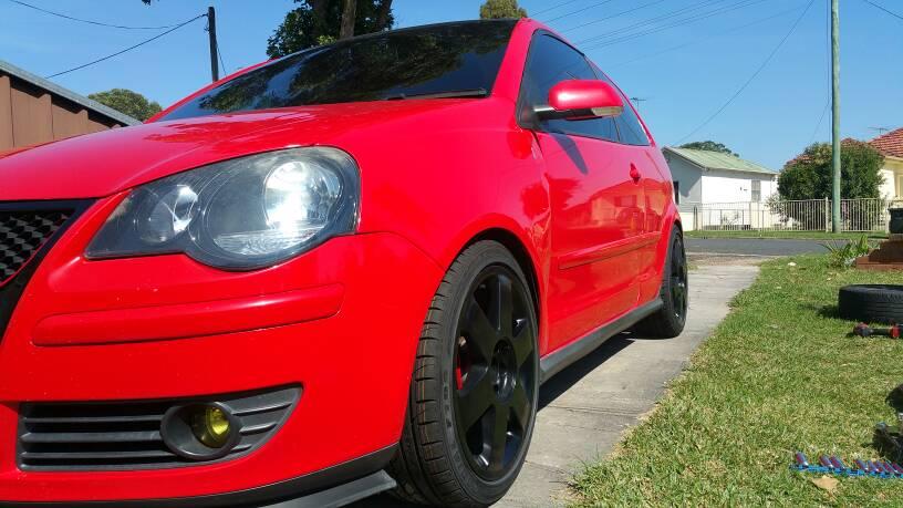

                          • Needs lowering but the TT wheels are on.
