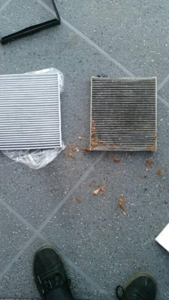

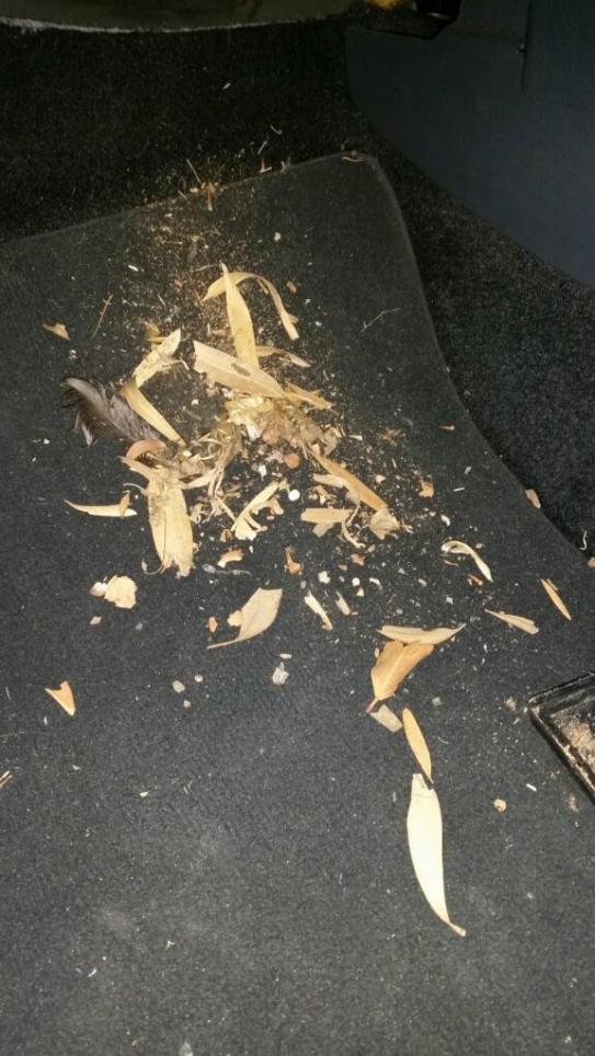

    • Part of my polo service done. Did the cabin pollen filter. 8 years (i suspect since new) of rubbish is now gone
      06 9n3 Polo GTI

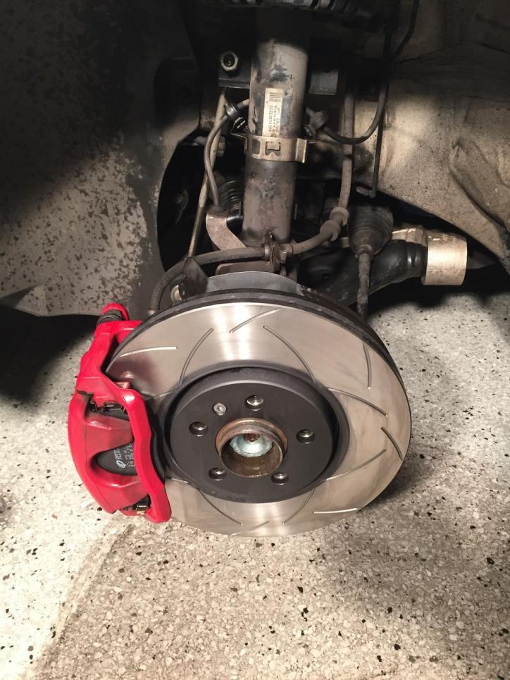

          • Fitted dba rotors and remsa pads
            Getting the suspension looked at tomorrow. I'm hoping they say it's rooted, you'll have to buy new coilovers.
            08 9n3 Polo GTI
