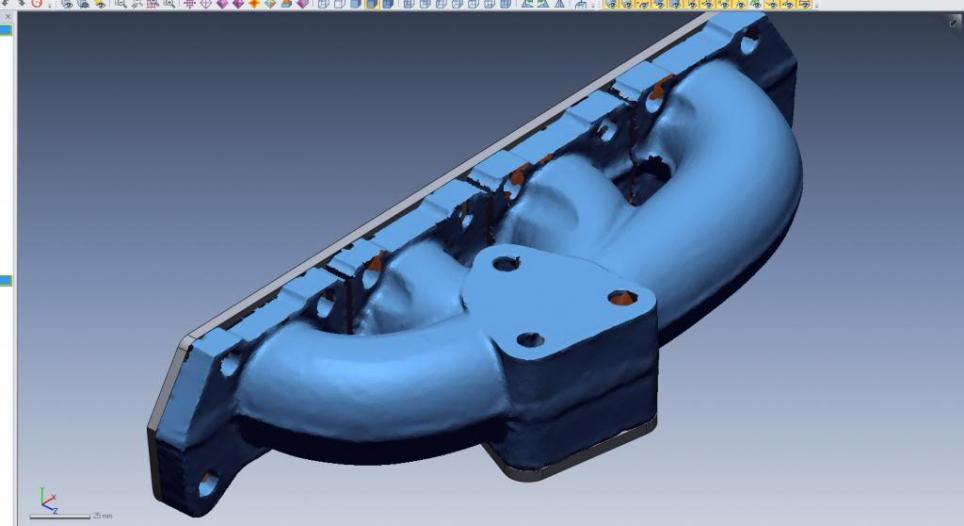

        • I can't imagine it getting much worse. I probably should have milled out the pockets for the nuts so I could get a socket on them. Not sure if its going to work out in even the remotest, but I'm going to try and design a new manifold. I'm hunting down a metal sintering printer at the moment to cost a prototype. The latest SLS printers can print at 90% density, so 304/314 stainless is certainly possible in impossible shapes, galleries etc. it'll be a fun design exercise if nothing if else. Here's a RE shot of the franken manifold in RapidForm RE aka Geomagic Design X.
          • Nice mate, don't forget the runner separator in the collector like the OEM manifold. Badger Bill has done a heap of testing on back to back manifolds like the FT, Kinetic, JBS and OEM manifold and found a ported stock manifold performed just as well but had superior pulse scavenging due to the separator iirc.
