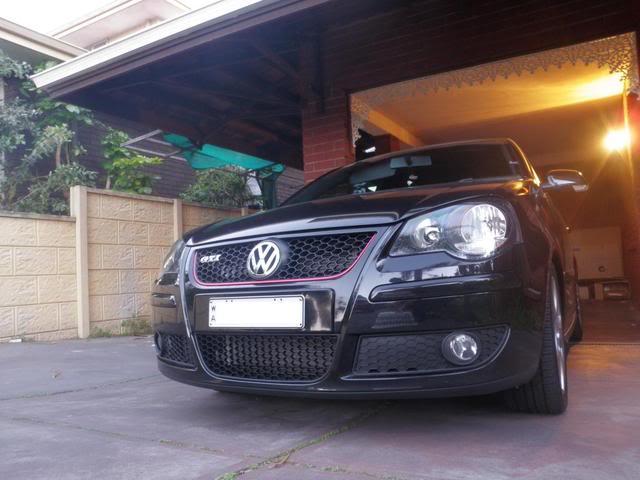

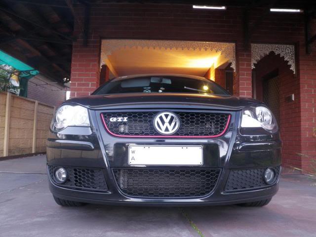

I used a standard drill with a wider drill bit to put 4 or 5 small holes into each honeycomb shape, then got the dremel in there to clean it up into 1 honeycomb shape (if that makes sense). Then used a bit of sandpaper to clean it up, took a little while but still better than paying $200+ for the proper ones.
