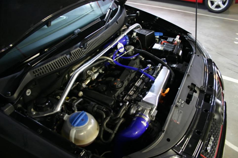

                  • Finished painting my valve cover, also got the polished manifold on a week or so ago.
                    Removed all the N249 stuff to, car seems to be running better, boosting harder
                    Changed the plugs
                    Need to finish polishing throttle body
                    Waiting on a Audi R8 Oil Cap

                      Looks great!
                      What's the benefit (and procedure for) of removing the N249?

                      • "The N249 system allows the ECU to open the diverter valve if it wants to. The DV is a mechanical system that does the same job, and removing it can smooth out the power delivery"
                        I think all it really does is allow the car to dump boost and not over boost, along with the N75 and other things. Too much crap on the car that is not needed
                        A lot of threads on Vortex about it, most saying it is not needed so i thought i would have a go
                        Car seems to boost a bit harder (higher spike)
                        Im sure Noone will chime in
                        It does throw up a code as some of the sensors are unplugged, most people just solder in resistors, so the car thinks there is a sensor there but there isnt

                            Come on, I've been really good and not posted 50 times a day...
                            The N249 does exactly that, its the bit thats on the other end of the diverter valve vacuum tube.
                            Bypassing the N249 removes the ECU's ability to bleed boost for whatever reason it decides. This was very popular with the Mk4's, there are also a lot of guys running this setup on the Polo UK site. I bypassed this for a few hundred kms about 6 months ago and did not notice any benefit, so I reconnected.
                            Each to their own, if you remove, you are potentially bypassing a safety mecanism, but there are plenty of bypasses running strong, so its not likely to cause issues (don't take my word on that).
