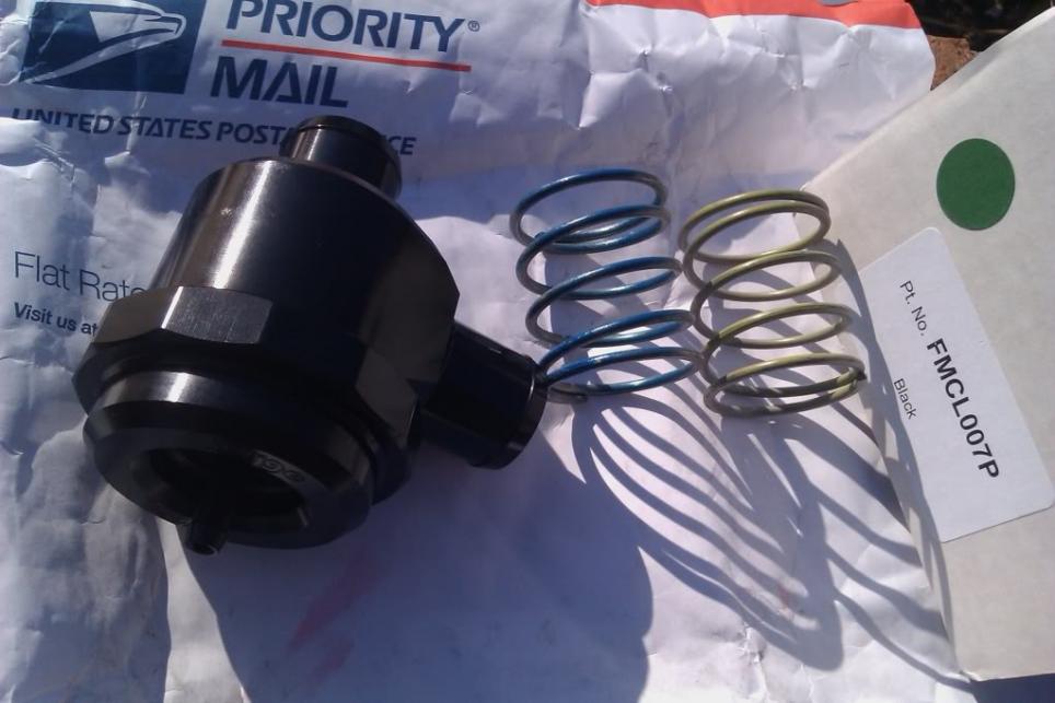

                      opened it again to find

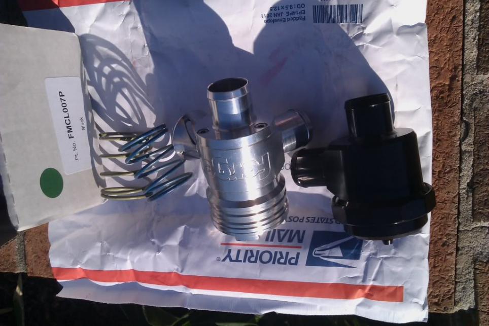

                      old vs new

                        how do u find the new one versus the old one? will u miss the PSHHH! noise

                        • since i set the splitter to full atmo for fun last week its been dumping too much air out of the system causing it to run extremely rich and forcing the ecu into limp mode. went for a quick drive around this evening and throttle response is alot better compared to the splitter. it is kinda sad i have no more PSSHH! but at least i can go on full boost again. maybe when i get a bmc cda kit fitted i might get a slight PSHH! back, but till then i'm still happy

                          • thats no good
                            ive got mine set to around 20% atmo (about the 7th click of 34) and the rest back into the box. Although ive heard a few different stories going around similar to yours! might get myself an APR R1 instead
