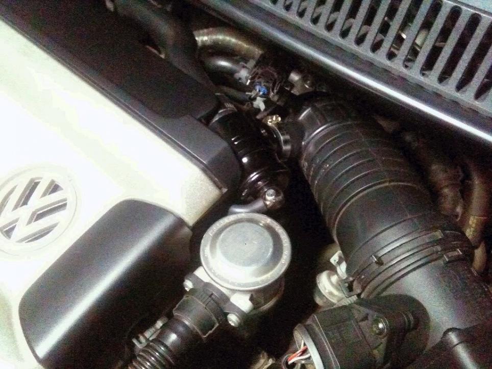

      As I said I have it on the hardest setting so most of the air goes back into the intake, and no engine lights have come on the dash yet... If anyone has VAG-COM in brisbane and wants to scan it I'll drop by, but I'll get Jimmy to have a look at it in a couple of weeks

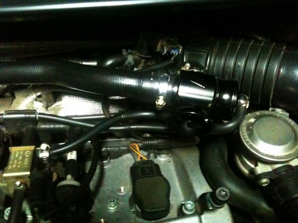

      • Some install photos.. Not the best as taken on camera phone:
        I have noted that there is a very slight backfire on 3-4 gear change at part throttle, but nothing too drastic.. Still no check engine lights and I gave it a real flogging around Mt Nebo this morning

        • Spec83 - I purchased that same Turbosmart compact and thought all was good, no check engine light but it will log a diverter valve error using a vaglink, I didn't realise until the guys at CVWC checked out my APR tune, just something to keep an eye on, but apart from that you get a hiss setting it up that way and a flutter setting it up the other way, so just wondering which was is the appropriate installation???

                  • The reason I think things will go into limp mode is because the ECU is expecting to see a certain amount of air back into the system when the throttle closes.. If this is not sufficient, then the ECU will have a checksum error and throw a code. Also, if the spring on the BOV is not sufficient and leaks boost, the amount of air in will not equal the amount of air delivered at the manifold and a code will be thrown because again things don't add up.
                    The install as per the pictures is the correct one if you follow the Turbosmart directions.. You get a flutter on part throttle and a woosh on full throttle. Car was pinging and running like a dog when it was the other way round.
                    I'll get Jimmy to check for codes in a few weeks when the car is serviced and report back then, but so far so good
