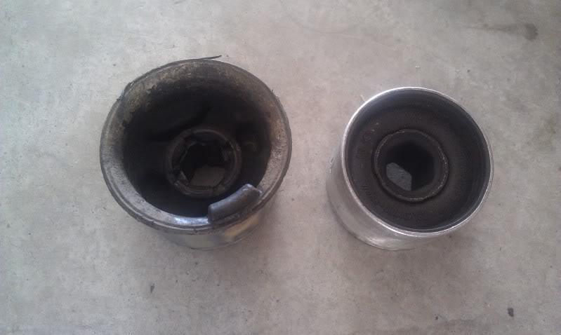

Superpro bushes, ordered Tuesday.

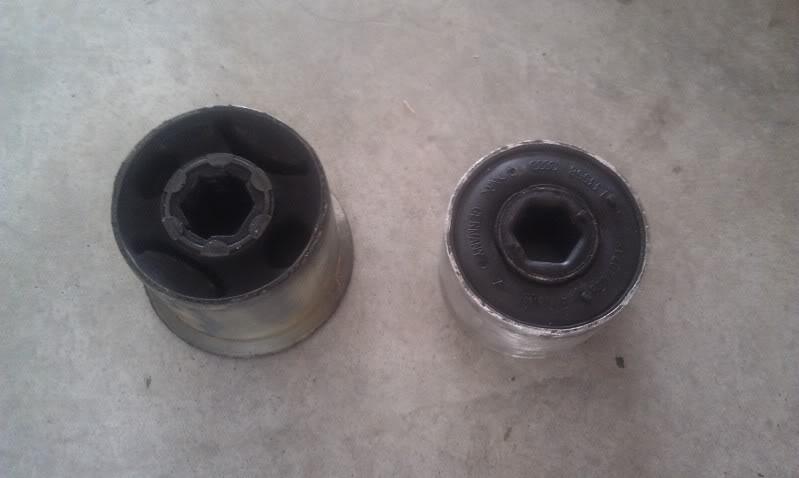

Of course I wasted no time and fitted the pair of them in an hour! No test drive yet but TBH they can't be worse than standard VW ones. What the f were they thinking when they fitted them? The Seat ones should have been standard issue FFS.
The Superpro one are listed as being anti-lift but if they stay pointing straight enough to not scrub the inside edge off the left tyre I'll be happy.
I am not a big one for taking photos during the job, so sorry this is all I took.
Nasty VW V Seat

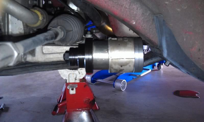

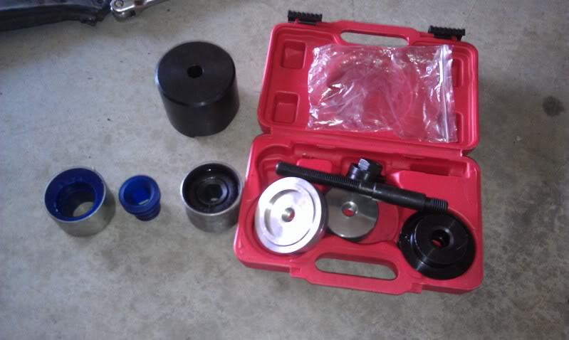

Bought the tool to remove and fit with the subframe in situ.

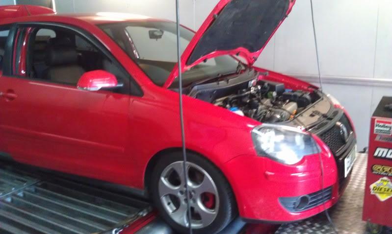

Anyhow, onto todays fun and games. Up earlyish after a late night at work, beat the dyno boys in this morning..
3 runs, just to see the 'differences' in the 3 states of tune I can magic up in the Polo. I ran std from the AMD one click, tuned from the one click, it is in fact a few clicks but that would be splitting hairs!
Then last, a swap of ECU to run Phase 1.
FYI the car is factory, paper airfilter and ebay DV. The next nearest thing to a modification to the motor is a piece of 3 inch duct to the airbox. You can see a little filter on the old SAI pipe connection.

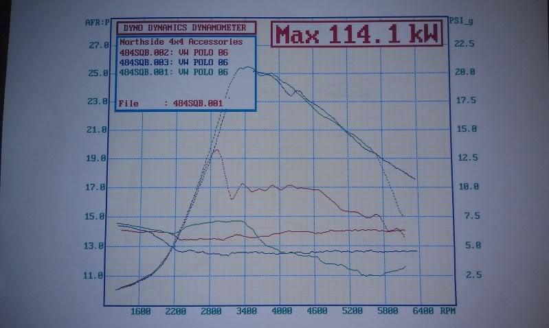

So here's the plots to fight over for a while.
CC looks more linear and a fat/safe AFM reading
Stock afm bang on stoich (I'm not saying that is good just an observation)
Heaps more boost for the custom maps
Where were you taking the AFM numbers from? Exhaust tip or sensor?08 9n3 Polo GTI
Mods: heaps
Stock AFM is good for the cat
You can certainly see why there's no benefit to revving past 6000rpm with breathing modsResident grumpy old fart
