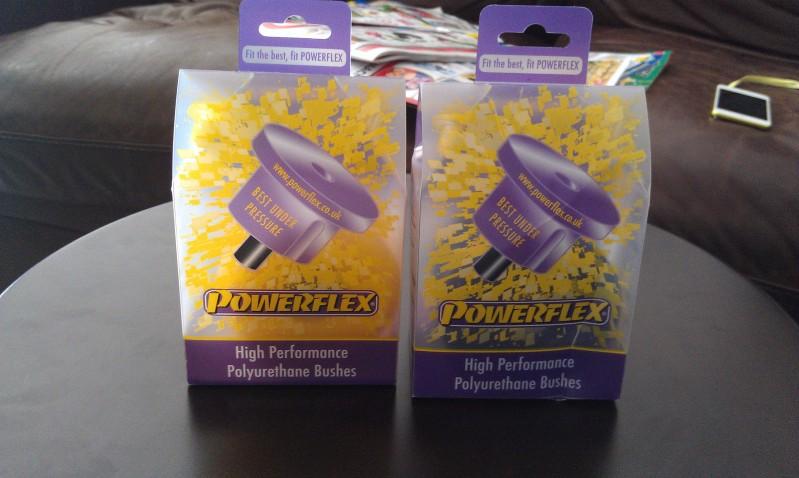

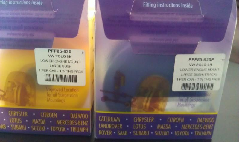

            New delivery today......
            Going to do the track one and see how that goes first. If I can tolerate it, I'll leave it in for good. I have a stiff one in the S3 and TBH it's no buzzier than the previous one.
            Job for tomorrow

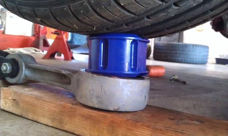

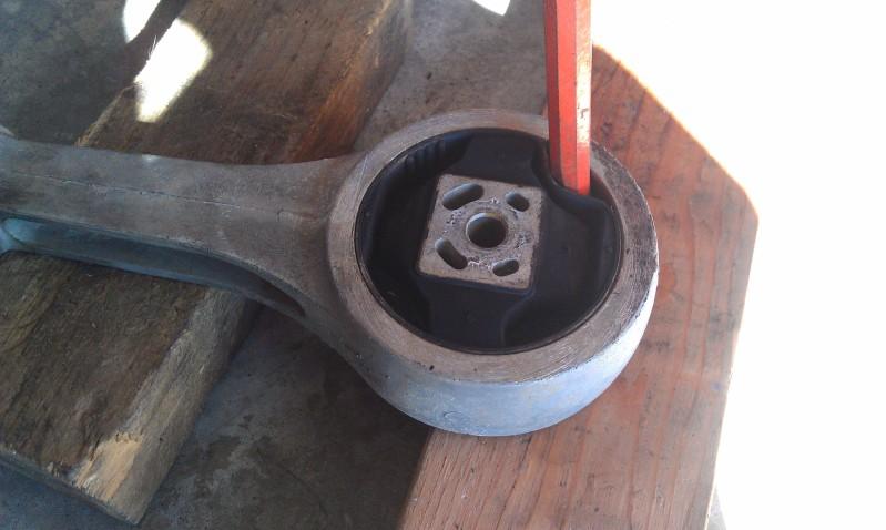

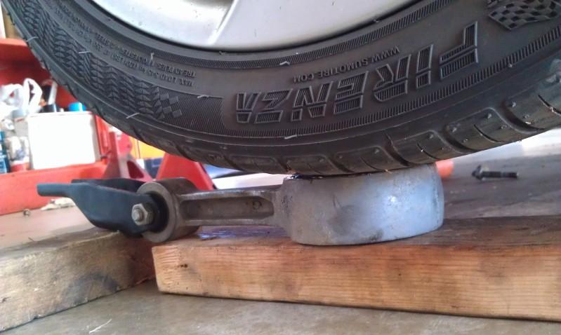

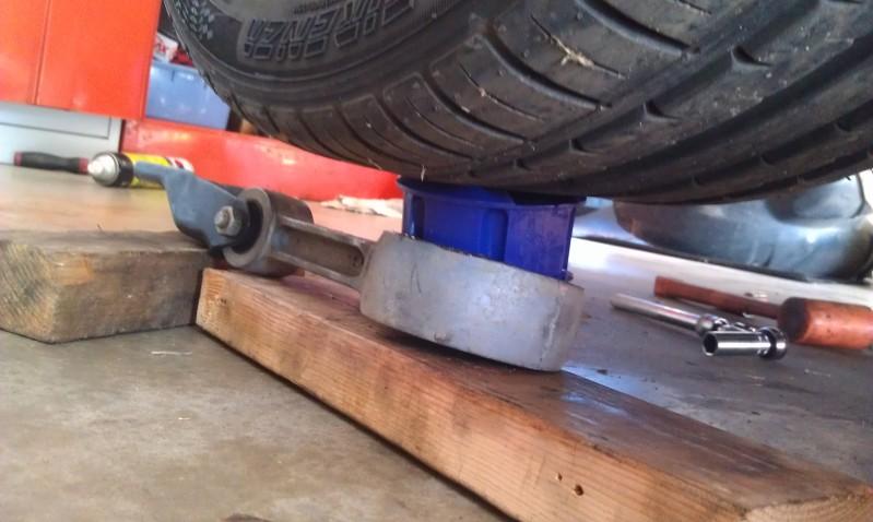

                          So this afternoon I fitted the Track dog bone mount insert. Not driven it on the road. Too many cars parked behind on the drive.
                          The dash isn't buzzing like a swarm of Bees so I reckon it'll be ok.
                          Out with the old, in with the new
                          A press would be a welcome luxury, but not even having a bench to put it on, I'll use a handy car instead.
                          • #88
                            True garage mechanic style there.
                            Good to know it isn't vibrating the heck out of the dash.

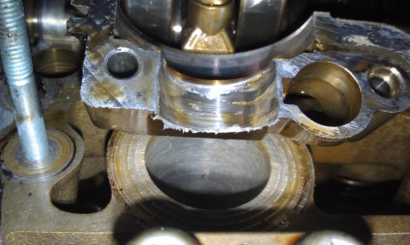

                              So the Polo had thrown a d VVT/cam timing code a couple of times. Net research pointed at a tooth out on the cambelt or with the timing chain between the cams. I was sceptical about the timing belt as the car ran so well. I couldn't see any reason for the cams to be a tooth out either. No reason that the cams had been out of the head.
                              As predicted, the belt was timed correctly and the there was the correct number of links between the marks on the cams..... Arse, that then pointed to the actuator being duff.

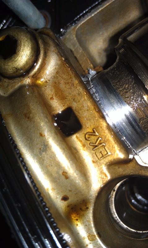

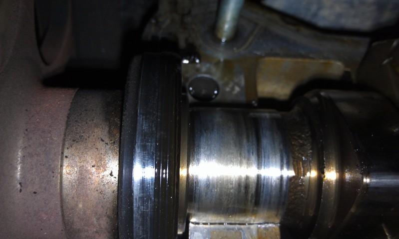

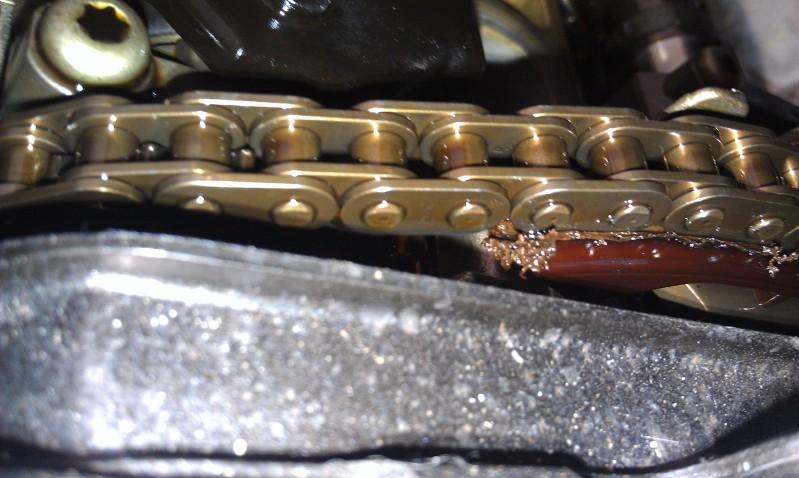

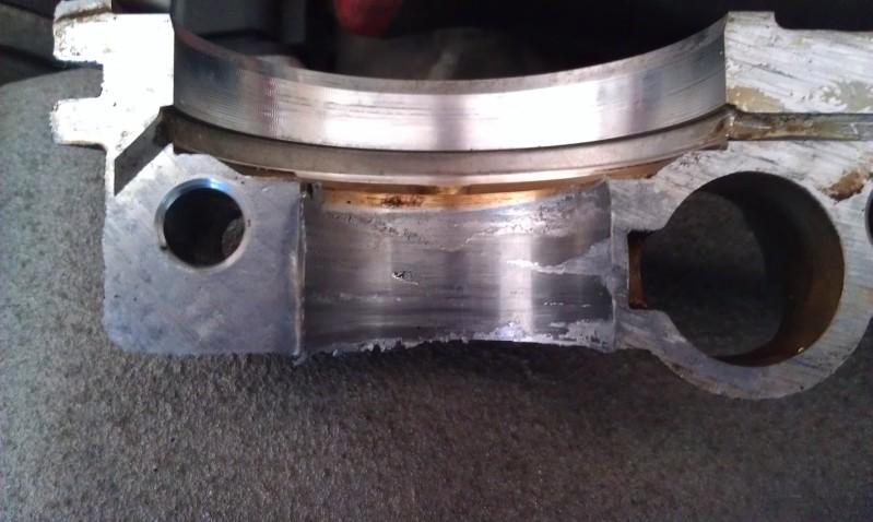

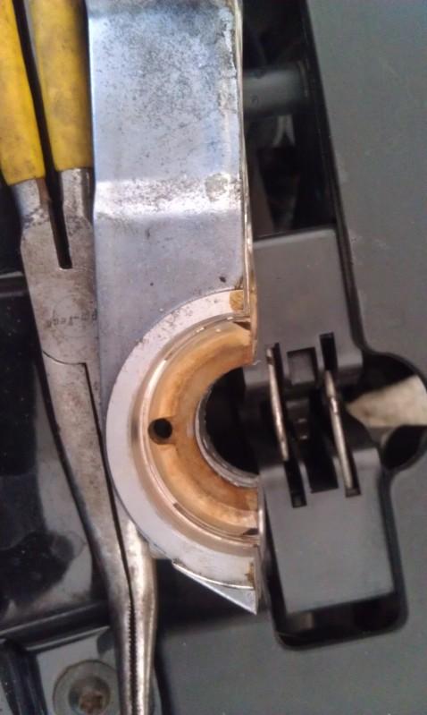

                              Then something caught my eye near the pulley on the exhaust cam.
                              Shiny aluminium
                              The result of oil starvation maybe? Belt massively overtightened?
                              The pad wearing away on the actuator, resulting in cam phasing fault.
                              So with the head essentially being scrap now...... What to do next? Replacement std head, AGU big port or something?
