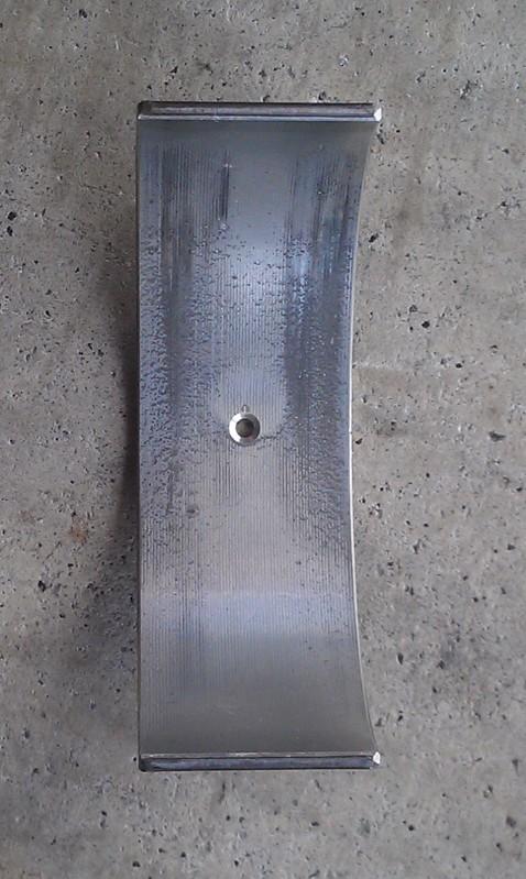

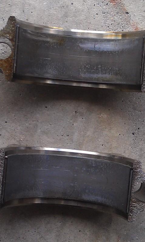

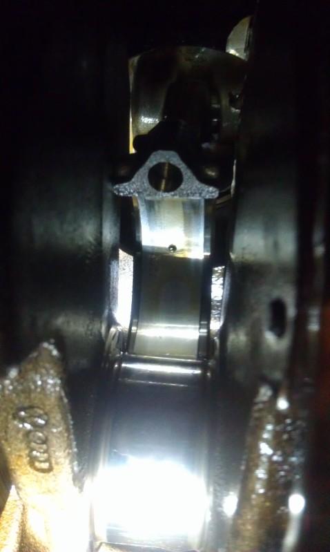

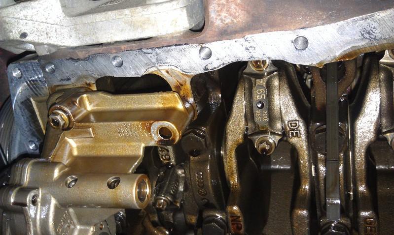

                    Today's instalment. Sump off, easy job. done it before.
                    Bearing caps not so easy......
                    FFS VW whats the problem with using hex head bolts mate? They have worked for centuries! SO off to the shops for a set of torx sockets. I got the Special Ribe tool for the headbolts while I was out too.
                    Lower bearing from #4 no white metal left so well close to doing the crank.
                    caps for 3 and 4 opposite end to the pump.
                    Crank looks sound

                          • enjoy the cracked caps mate? Think if you kept running it the exhaust cam would just stop and you would see some intersting carnage, be a good read!! still be no good stuck on the gateway though Gav.
                            Serioulsy you are at the point where you could go a step ahead of most Polos here now Gav with the opportunity to have a stronger bottom end BJX or not if you know what i mean
