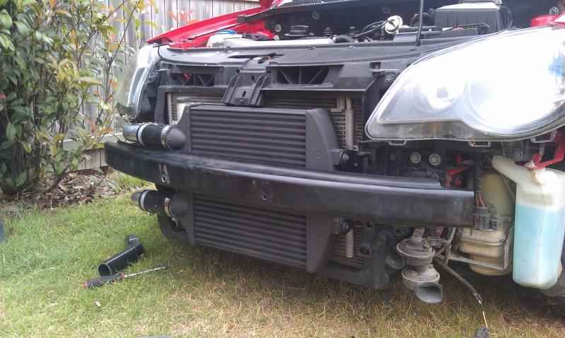

    Anyway, with the engine swap now push back, I thought I'd get on the FMIC install instead. Probably a 2 hour job all up for a second attempt. I did some messing about that I'd not have to repeat on another.

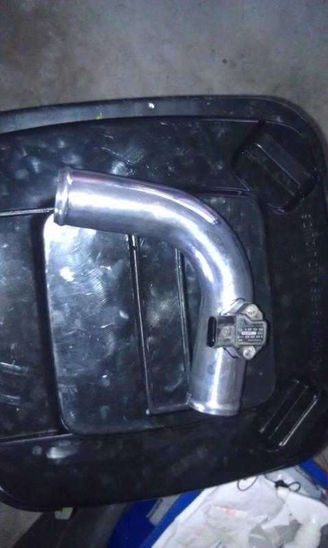

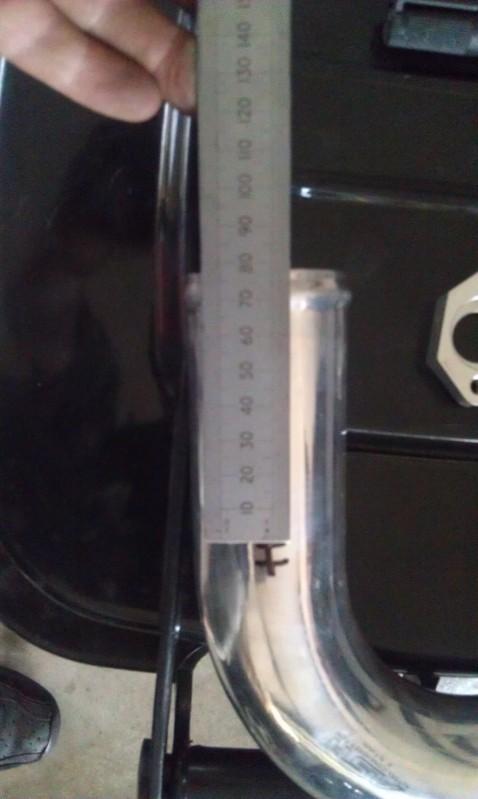

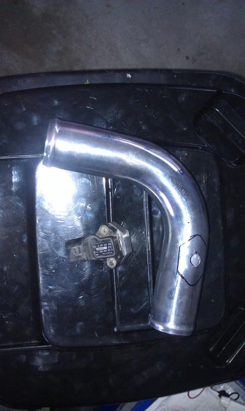

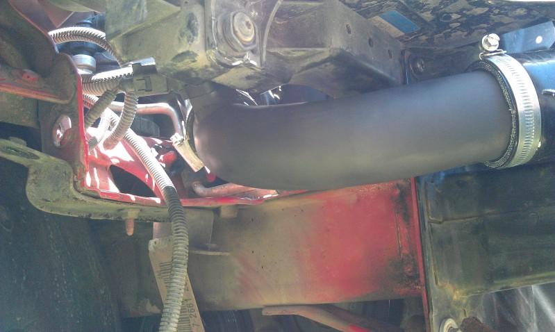

    The thing stopping the job getting finished is the mounting of the MAP sensor in the inlet pipe before the throttle body hose.
    Here's a few pictures.

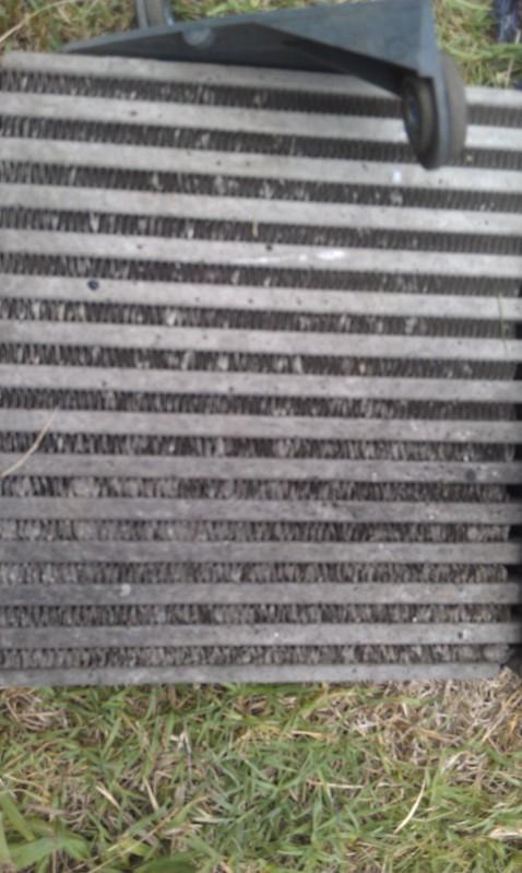

    tatty old intercooler, flattened fins on the back, from driving with now arch liner I am guessing, probably responsible for the high inlet temps I had.

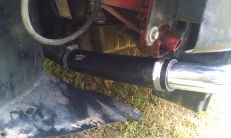

    Bottom hose

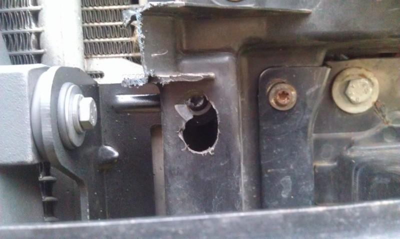

    Cutting and drilling for the mounting brackets. Easier to access the bolts this way over further dismantling the front end like I did.
    Finished job, nearly..
    MAP sensor

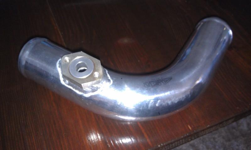

    Needs welding in for a permanent solution. Bought the mount from ebay but it comes with screws that are too short. Not a big deal though.
        Is there anything the previous owner/s did right?
                Bottom hose
                MAP sensor
                I did a write up with Ants one for those access holes, i used a hole saw, neater job but not to worry its hidden behind the bar cover suppose, i just prefer a neater deburred jobbie, still its your and not a customers hey.

                  I originally did it with no holes. But had to slacken the screws off to tweak the bracket a bit. So it would have been perfect.
                  Good to experiment on my own car though.

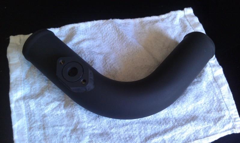

                            • All done and back together now pending engine replacement.
                              Last couple of pictures. There was trimming to do on the bumper and the driver side foglight trim.
                              Got the MAP mount welded this morning, found a local guy to do it.
                              Painted up
                              Fitted
                              • The black looks good. Stealth like
                                Did you have to shove the pipe a fair way in at the throttle body end?
