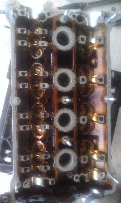

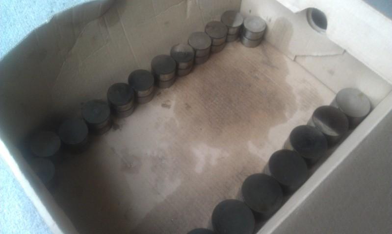

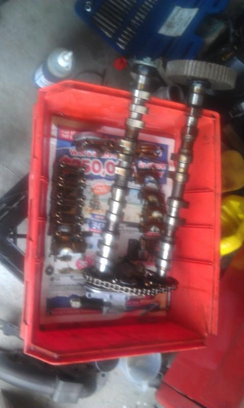

  • Head partially stripped for a check over.
    Cams
    lifters
    • What next Gavin?

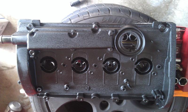

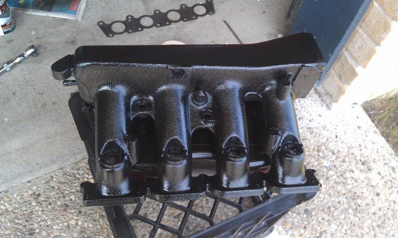

              I have started to wire brush the outside of it, so it looks like aluminium, instead of outback. At least on the bits you can see from above.
              Down some crackle black on the cam cover, very pleased how that has come out.
              Probably do the inlet manifold tomorrow to match.

                        • A bit if tidying up with some VHT wrinkle black

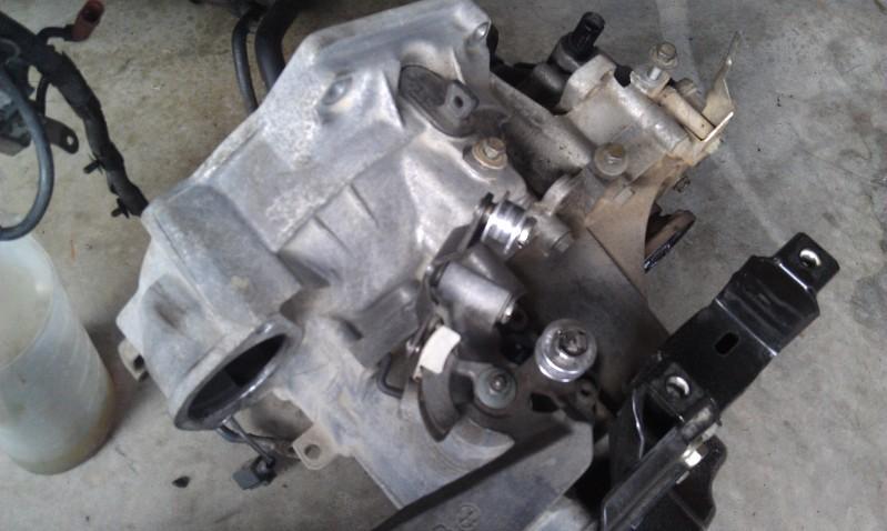

                          Gearbox gets a bit of a wash and brush up.
                          • Thats a great finish on the cam cover.
