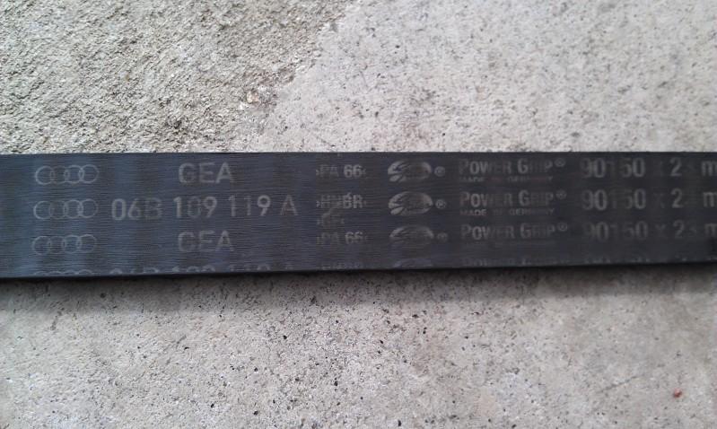

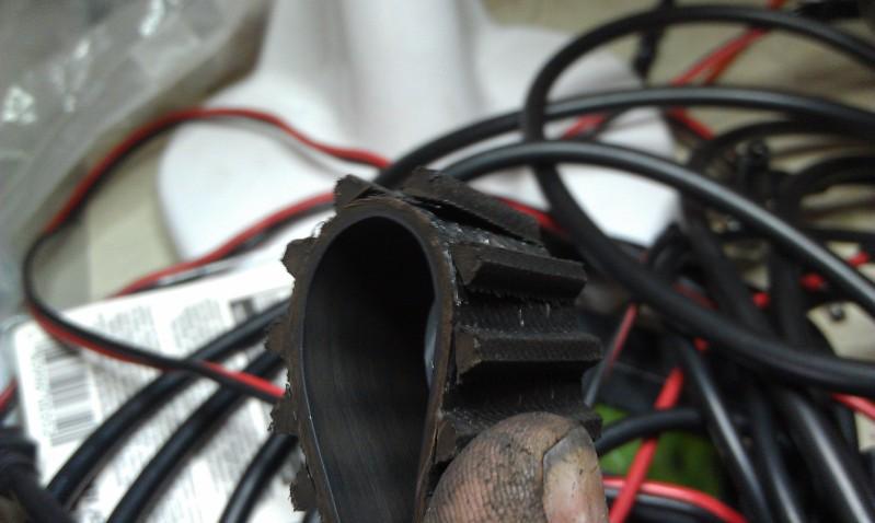

          • Well, it was a factory belt a Gates one no less. I'll do the photos tonight at work. I did wonder about something else nipping up but the starter had no trouble over coming that?? It's lightly kissed 2 exhaust valves, there's marks on one piston that would blend out.
            Damper looks ok but the tensioner was dated 2004.

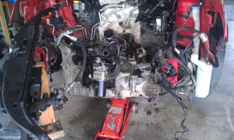

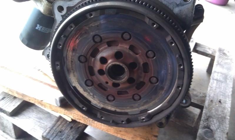

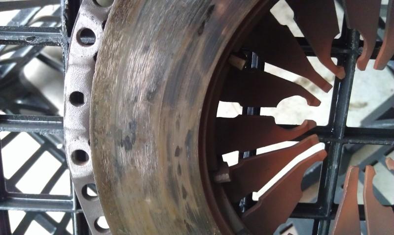

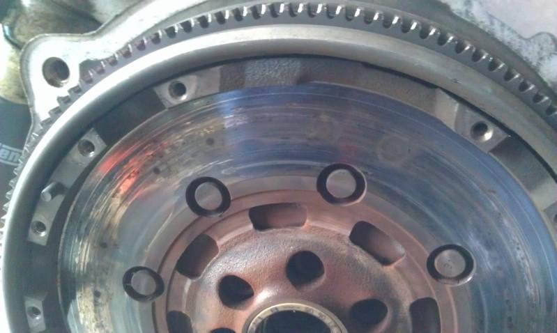

                    • Further progress today, Nothing found in the oil I dropped out of it..
                      Pulled the turbo off first, then wheel out the bottom end while connected to the gearbox. Doing it alone on stand with a trolley jack it pretty easy.

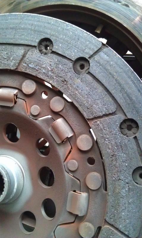

                      Pulled the gearbox off and removed the clutch as I need the tin work to fit on the other engine. Clutch was a VW one but probably wasn't going to live much longer.
