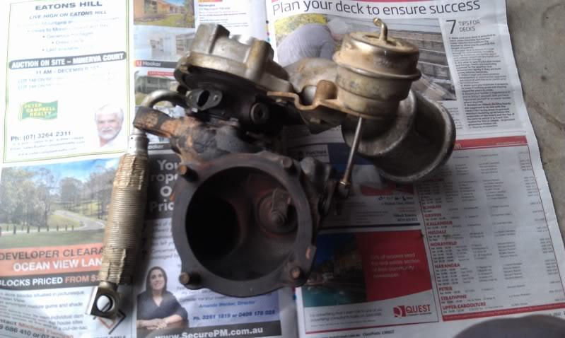

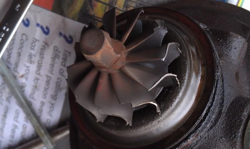

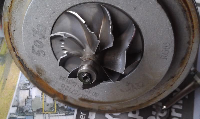

So the diagnosis went like this. TIP pulled off and the shaft had heaps of end float and wobbled all over the place. Hence my posts for a turbo on Friday.

This was the shocker I pulled off today.
