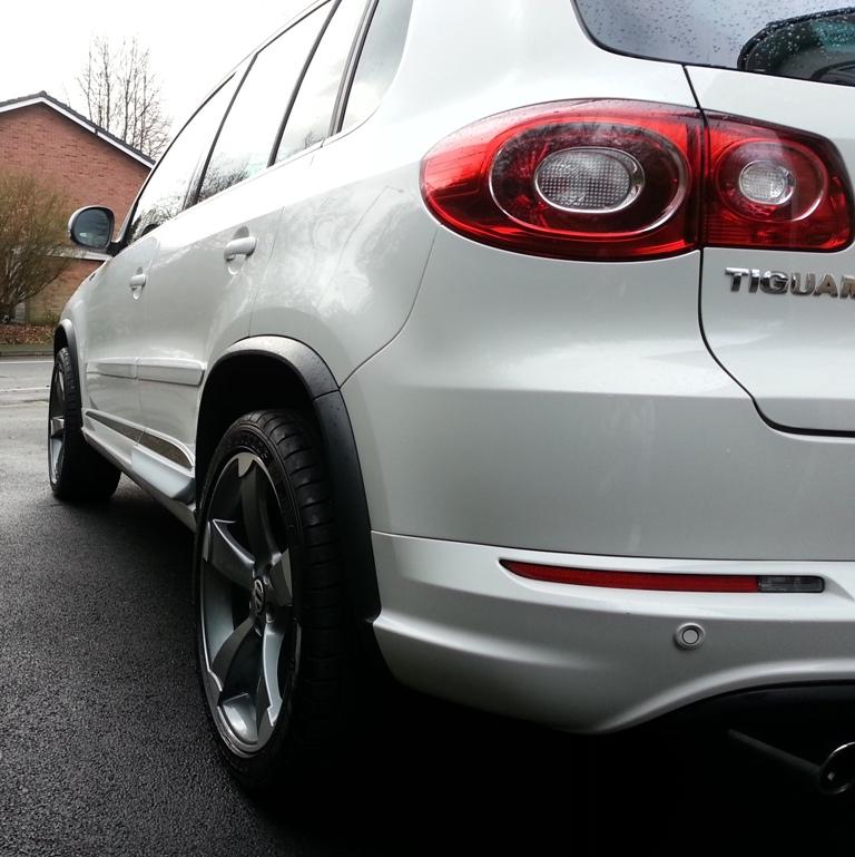

                              Sorry for the slight hijak, I just wanted to answer the questions above. Also, to confirm (without sounding arrogant) my car is a genuine R Line model, not just a bodykit.
                              My current wheels are 19x8.5 et 32 with 15mm spacers all round. No rubbing problems at all. The only time I got a few instances of arch scraping the tyres over severe bumps was a motorway run a couple of months ago, but the car had a full boot, and there were 5 of us in the car which included 3 back seat passengers each averaging 15 stone in weight. That was a VERY rare journey with the out-laws - something that won't get repeated again in a LOOOOOOOOOONG time!
                              2011 Candy White Tiguan R Line 170 TDI DSG | Pan roof | Park assist & RVC | RNS 510 | MDI | LED's | 20" RS5 Wheels| Bi-xenons & AFS | Front & Rear footwell lights | Door warning & puddle lights | Mirror puddle lights | LED Tail lamps | Eibach Pro-Kit Springs
                              • Cheers for the info mate, appreciate that. I'm looking at 19 inch wheels with 9.5 width with blank offset, they can basically machine the wheels to have offset from et15 - 45. Probably best getting the arch extension first then play around with the offset later. Your stance will be the benchmark .
