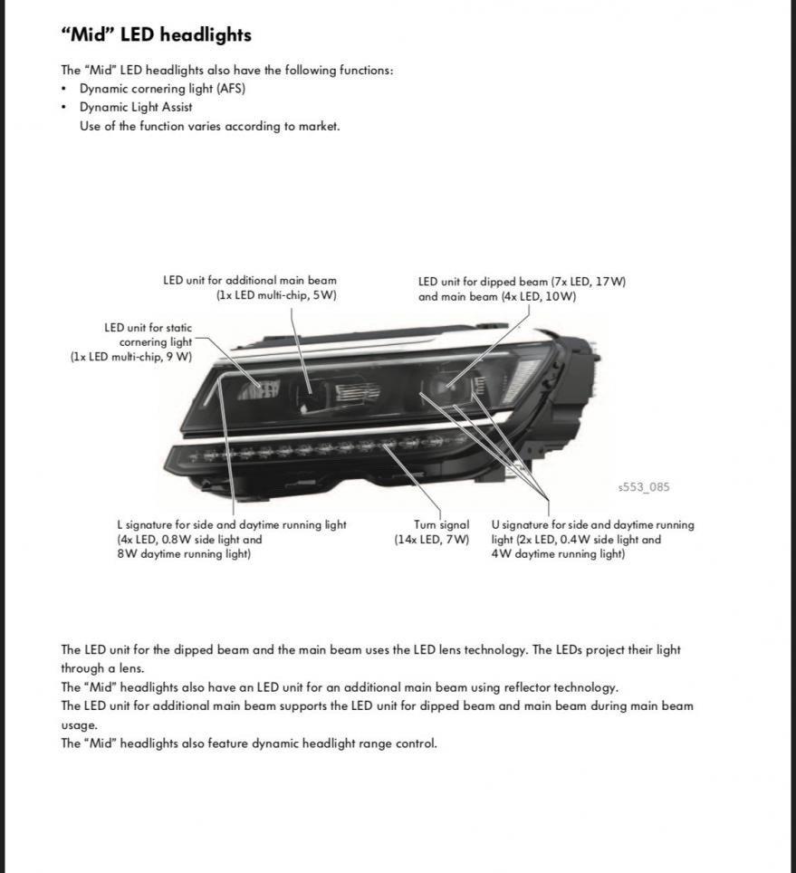

                        • DLA does not work on the Tiguan SEL Premium (NA) as the headlights do not have DLA shutter.
                          • Originally posted by kamold View Post
                            This is the headlights I have in my vehicle. According to what I’ve read there are only 3 types of headlights in the MK2 Tiguan. Also the “mid” headlights say they are capable of dynamic light assist.
                            I think it should work
