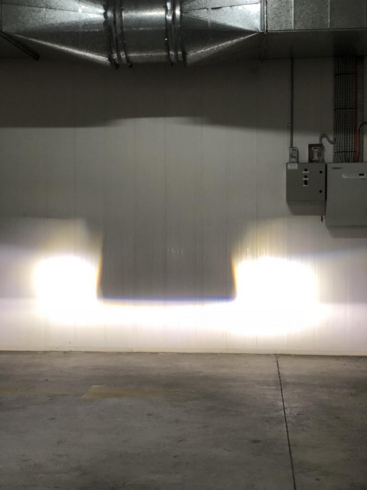

            • From some testing that a friend of mine has done with Arteon and Passat, the only way to gain factory DLA functionality is by applying the correct parameter set to the 4b or 55 control module.
              With just coding the function is not per factory spec and performance is not as it should be.
              DLA is not the same as High Beam Assist (fla in German) as it also masks oncoming vehicle rather than just controlling dipped and high beam with instructions from the front facing camera.
              I haven't seen a parameter set for Tiguan but I can look into it. There are parameter sets for Passat and Arteon. Arteon can also enable predictive light assist which uses map data to turn the headlight before the wheel is turned.
              Tiguan DLA MIGHT work with the Arteon parameter set, but again I haven't tested it.
              • Applying parameter set is necessary for DLA.
                It works but it works unsafely without the proper parameters. It has delays in response, not blocking enough area issues and the laggy responses following the front car.
                That is what I concluded in the limited tests and daily uses.

                    I had another go to see if DLA would work. Unfortunately it didn't, reintroduced an error on the driver's display. Was unable to do basic headlight settings in Module 4B, reported "(22) Function cancelled, marginal conditions have not been meet". I was allowed to do the basic headlight settings and confirmation in Module 9 but not 22.
                    In the end reverted the changes back for simple Light assist (High beam assist) and have no more errors. Able to do basic headlight settings in Module 4B.
