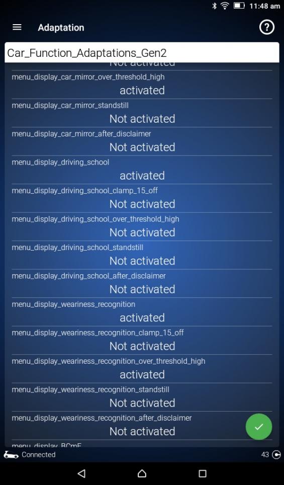

      • Stumbled across the driving school settings!
        Module 5F (Instruments)
        - Adaptation
        - Car_function_adaptations_Gen2
        - menu_display_driving_school
        - Activate

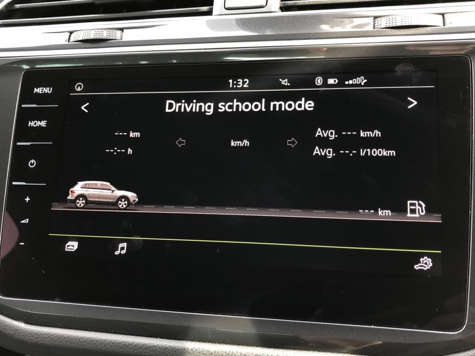

          What does the mode do? Please?
          • Originally posted by zzc2010 View Post
            If you're teaching your child to drive, then having all the relevant information on the central infotainment screen allows you to see it easily rather than having to look over at the driver's display.

            • You normally activate the threashold high setting too
              • Originally posted by Jap View Post
                What is that function? I wasn't sure so didn't activate it.

                • Originally posted by veew View Post
                  I’m assuming it either stops the learner driver from going over that speed or gives an audible warning so the instructor can get them to slow down.

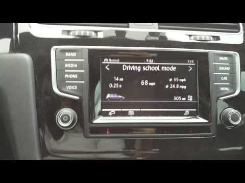

                  • I wasn't sure what it did so I found this vid..
                    Indium Grey Golf 7.5 Alltrack 135tdi Premium - all options
                    • Oh
                      The turning signals are cool.
                        Dunno but all the activated menus have it, even when you setup off road
