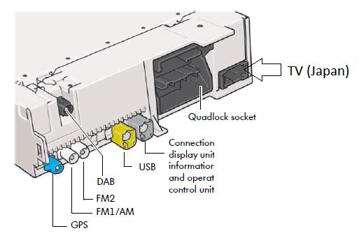

        • Does anyone know if it's possible to enable DAB? I'm guessing there will be hardware missing, but considering other countries have DAB with the same head-unit, it might be possible?
          I know in the 5F module, I saw two options for DAB in Long Coding, but neither enabled anything that I could see.
          • Originally posted by bigkyle View Post
            It's a different mib unit in the glovebox.
            Has a different part number that includes the dab tuner and aerial connector.
            Sent from my HTC 10 using Tapatalk
            • ^^^ What he said!!
              It's missing the DAB aerial connector in the picture (and the circuitry inside the housing that connects to this plug);
              Don
              • Japan gets a TV?!? I feel so ripped off.
                • Originally posted by OZROD View Post
                  OZROD: Japan clearly doesn't have our free-to-air-TV!! If it did, Japanese drivers wouldn't need TV access in their cars because there would be nothing worth watching (especially inside a moving car)
                  Don
