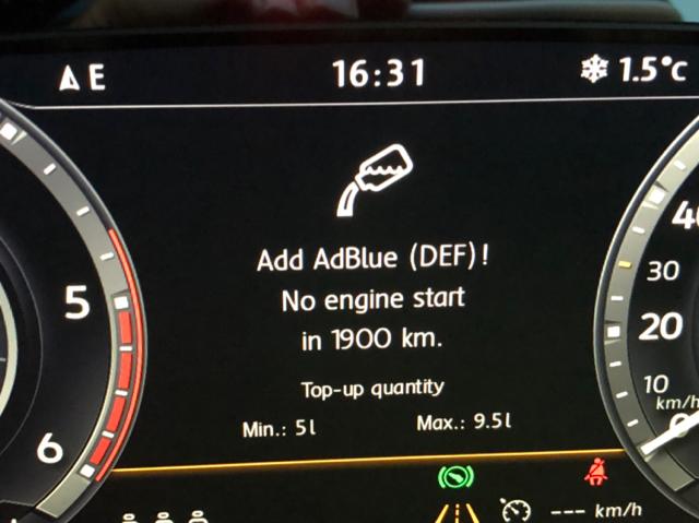

                • Originally posted by wpisdu View Post
                  I’m wondering if anyone know how to turn off or modify warnings about AdBlue level in diesel engines? They appear as soon as you hit 2500km left on AdBlue tank and they are annoying as hell to see them every time I start the car.
                  Just wondering if the instructions by DV52 (http://www.vwwatercooled.com/forums/...ml#post1253121) achieved what you needed. If so I'll add it to the original post for others to refer to.
