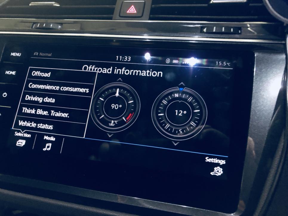

                      • Does anyone know how to enable the “performance monitor” on the Tiguan. Have seen online the golf gti can display this via the infotainment, and in my Tiguan Allspace manual it has a section that says select vehicle->selection->sport but I don’t see that option just off-road option etc
                        • Originally posted by htran View Post
                          Then hit settings on the bottom right and it will come up.
                          Tiguan Gen2 162TSI Etuners IS38 Stage 3 238.6 kw@4 wheels
                          • Sorry but I don’t see the option to bring up the performance monitor
                            • Looks like the Performance Monitor only comes with Performance Engines.
                              • No sport option? That's what gets the performance monitor
