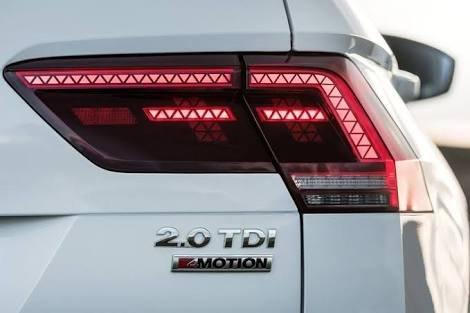

        • Hi there, has anyone figured out how to set these rear lights up as DRLs. They're too sexy to not have on 24/7!
          Sent from my SM-G965F using Tapatalk
          • Originally posted by twyat1 View Post
            Yes, I did it with mine ages ago. I will find the details for how I did it (it is either further back in this post or under one of the other posts) and re-post it again for you.
            Current Ride: 2019 CUPRA Ateca in Energy Blue with Bucket Seats
              It’s on the first page of the thread.
              Sent from my iPhone using Tapatalk Pro
                Current:
                2017 Mk2 Tiguan 162TSI, R-line, White
                2020 Mk7.5 Golf R Wagon, White
                • Originally posted by veew View Post
                  Thanks, saved me hunting through all the posts although I do have a document saved with all my coding changes on it so could have got it off there.
