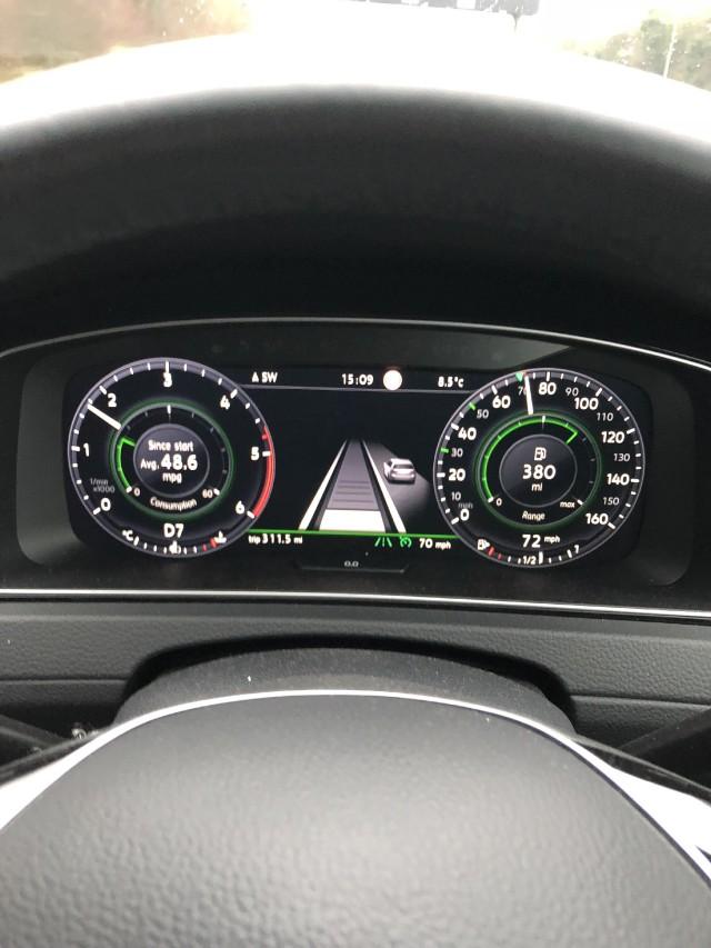

        • Originally posted by Jap View Post
          its in long coding, it’s part of the ACC, if you have the cruise set and your on a dual carriageway on the inside lane and coming up on a car in the right lane then the car slows to the speed of the car in the right lane, the mod stops you slowing allowing undertaking, it was discussed on the Passat/arteon forum a while back
          I checked and I've this option disabled by default. Quick one for you - does the other lane appear on the AID only when this feature is turned on?
