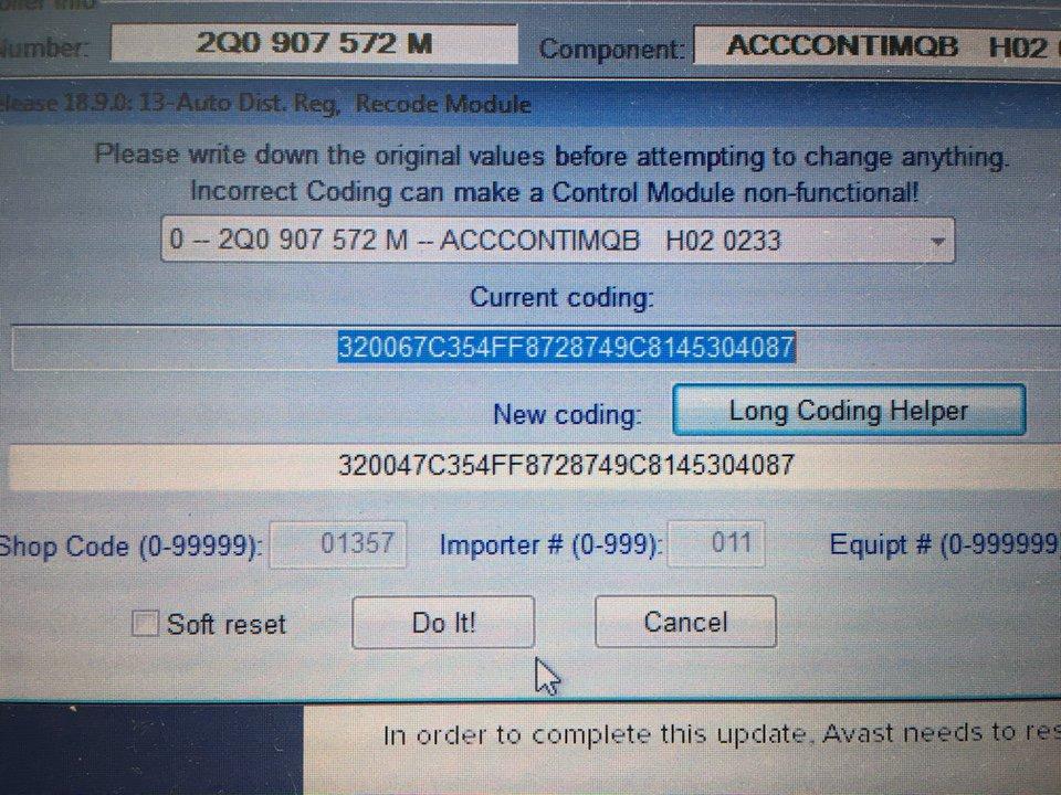

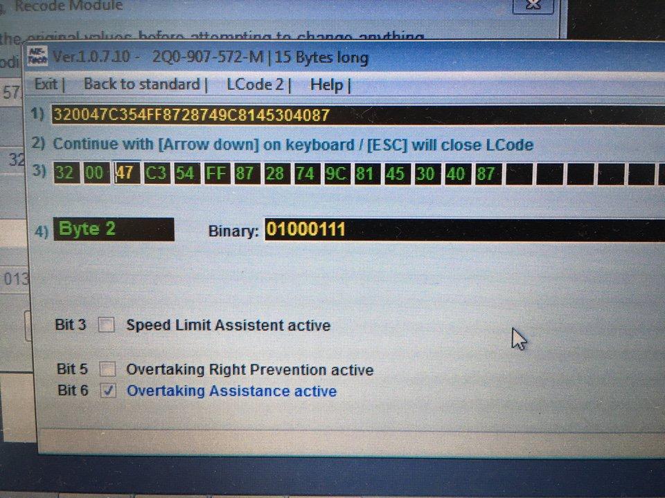

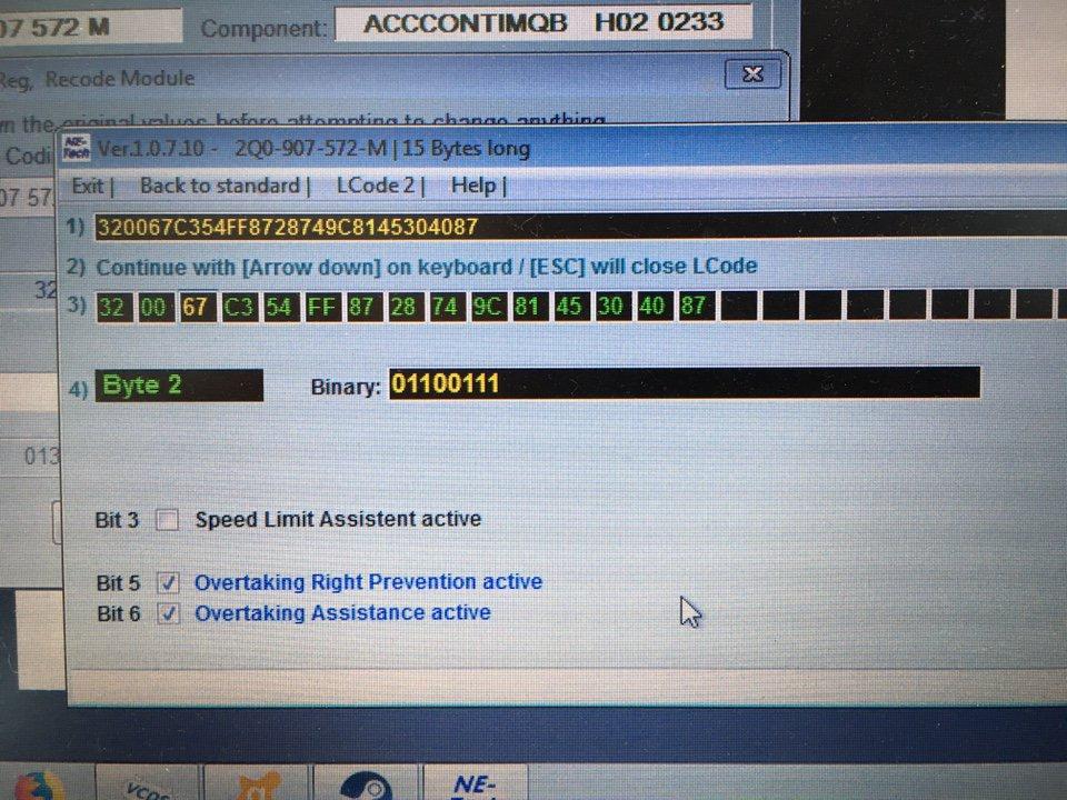

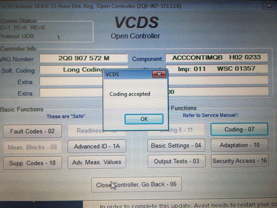

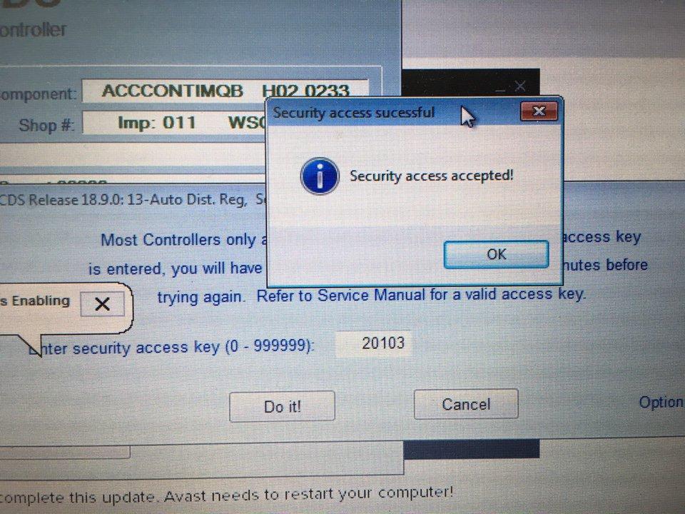

                            • Success!!!
                              It wasn’t quite as easy as I had to find which module the setting was in and then required a security access code to change the setting:
                              Module: 13. Auto Dist Reg
                              Security Access Code: 20103
                              Long Coding Byte 2: Overtaking Right Prevention Active (unselect)
                              Security:
                              Long coding Byte 2 (default settings):
                              Long Coding Byte 2 (unselect overtake prevention)
                              Module coding:
                              Do it!:
                              - Tigger73's 125TSI Build
