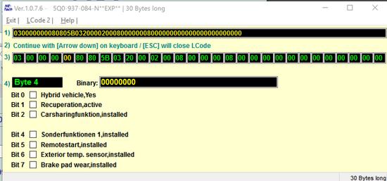

                            • Originally posted by veew View Post
                              Saw this tweak in the Golf VCDS thread, "Enabling key FOB whilst engine is running":
                              Let me know if anyone gets this working, I will get around to it eventually so will report back then.
                              No luck getting it working for me. If anyone does get it working, let me know!
                              Current:
                              2017 Mk2 Tiguan 162TSI, R-line, White
                              2020 Mk7.5 Golf R Wagon, White
                                veew: Byte 4, Bit 2???? This is the "carsharing" software switch :
                                Have you tried setting the BCM adaptation channel ENG10579-ENG115754-ZV allgemein-Funk bei Klemme 15 ein to active ?
                                Don
