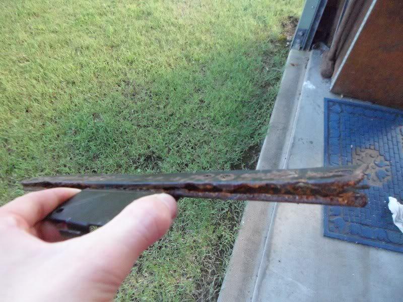

          Winding my front passenger window up today, I heard servere crunching and cracking sounds, leaving me to assume the worst.
          After I finished work, I came home, tore the trim off and found the cradle that the window sits in like this.....
          Completly rotted out with rust, allowing it to buckle and catch on the door frame as I wound it up.
          Managed to brace it with some angle aluminium and put it back togther. Works better than before!
          Anyone know where you can buy these?

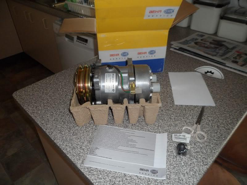

                Yep, $409 all up, including that little rubber grommet.
                Its booked in to an Auto Eleccy this Tuesday, he'll remove the old compressor/receiver dryer, flush the system, install the new receiver dryer and compressor that I supplied and gas it up. (finger crossed)

                        SUCCESS!!!!!!
                        The A/C now works, its bloody loud though haha

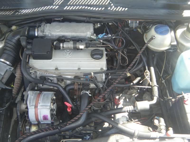

                                I think I just found a goal for the look of my engine bay.
                                This is a MK2 that Loon has for sale...(very tidy engine bay)
                                And my engine bay
                                Same engine and injection system, except i have a crows nest of messy wiring.
