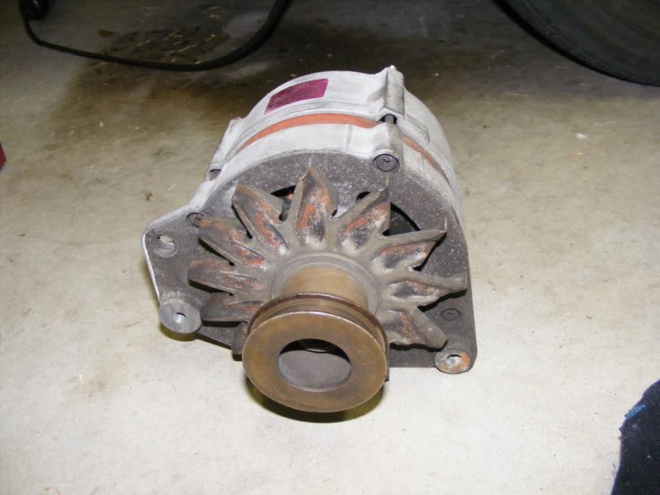

                                Was driving along nicly Monday arvo when I heard a sizzling cracking sound coming from the dash.
                                Suddenly my radio went off then came back on, then I looked at my cluster and my Tacho, Temperature Gauge and Fuel gauge has all dropped out (car was still driving fine).
                                Indicator light does not work anymore now and neither does my battery warning light.

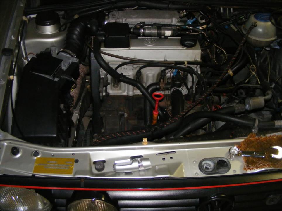

                                So went home ripped the dash apart then thought it to be a good idea to check my alternator, so I tested the voltage at the batt terminals whilst car was running and got 12.1 volts.... oh dear and if I remove a battery lead whilst the car is running it stalls.
                                As the car sits in the garage at the monent with a highly suspect alternator (removed)
                                The culprit!
                                and can you spot whats missing
                                Aiming to get the alternator rebuilt in the next week or so (really hope its just the alternator).
