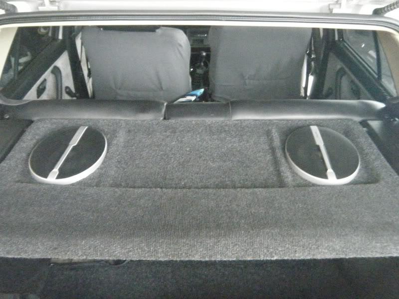

          Unfortunatly one of the previous owners before me has cut the shelf and fitted some (very very old) Alpine 6x9's.
          They did quite a ****ty job of cutting the holes too, but its been covered up with carpet so its looks respectable.
          To 'unmolester' a parcel shelf wouldn't take to much, just graft the right shape plyboard in with some epoxy then recarpet. Atleast I'd think?

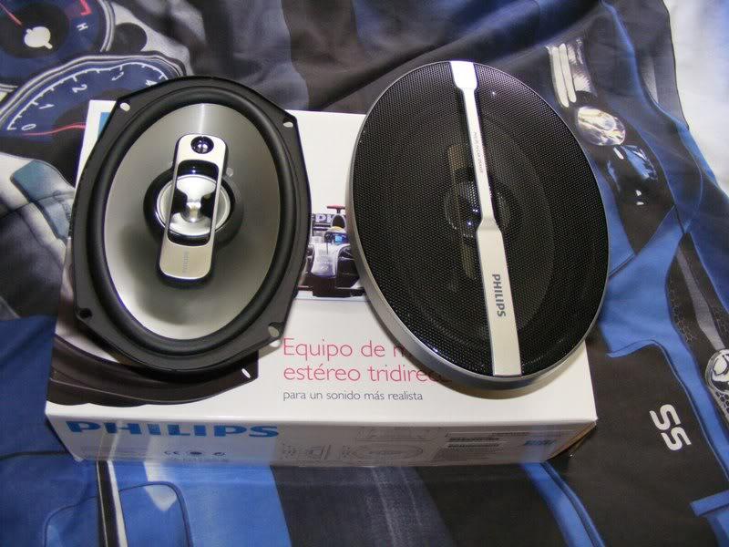

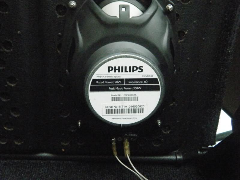

                Well today I 'casually' went into Autobarn to buy some black wrinkle paint for a gauge project that Im getting close to finishing (piccys will come)
                When I was there, I noticed some Philips 6x9's that I had found online (planned on buying) for a good price.
                Turns out they were on sale for $79!!!......so I had to get them
                300Watt Philips CSP6910 if anybody is interested.

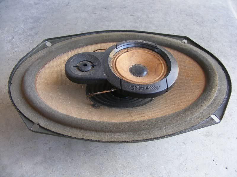

                And the descintergrating Alpines that were in my car
                I have no idea how good the Philips speakers are compared to the other major brands (Kenwood, Pioneer ect) I bought them on the frequency/audible range and because they have a nice simple look to them, nothing stupid/ricey like green Fusion speakers.

                • #68
                  I have phillips speakers in my Mk3. Have been told by a few blokes they are great bang for buck.

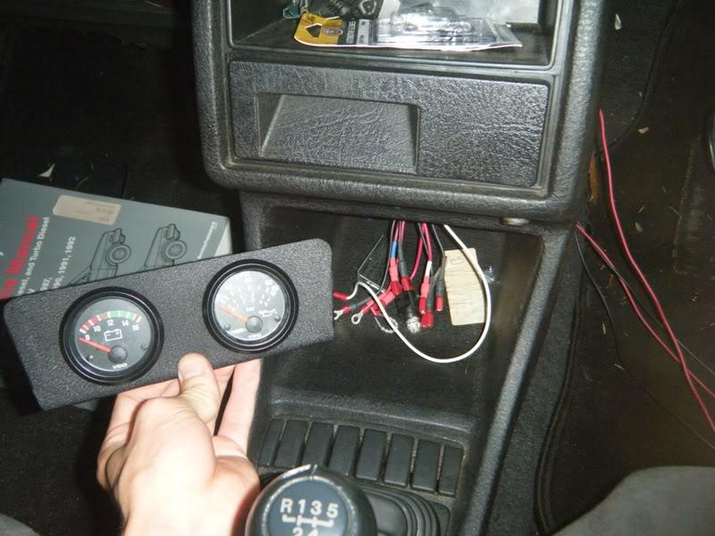

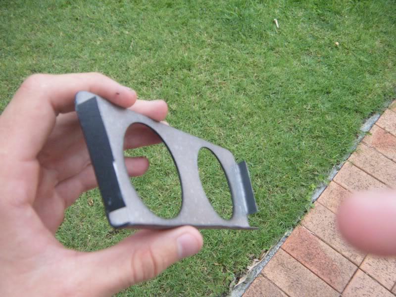

                      • #71
                        As the speakers are set up

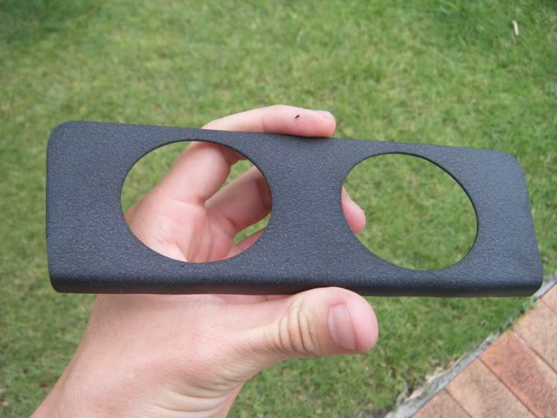

                        Now for the gauge fun, this was just a piece of aluminium and with some clever folding, etching and wrinkle paint you end up with this!
                        Mocked up

                        • #72
                          Gauge plate mod looks great. Has a good oem look. Nice car mate.

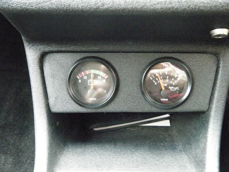

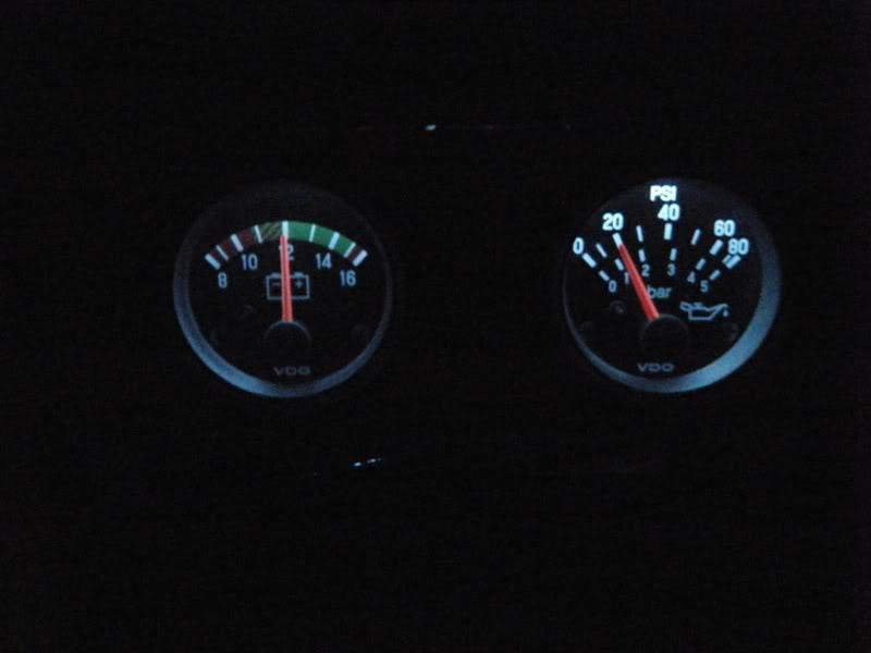

                            Gauges pretty much fully installed
                            And at night..
                            Only complaint is that the 'Voltometre' reads around 1volt out, probably due to its grounding and getting its power from the fuse box.
                            I bought these gauges to
                            1. monitor the alternator (I still don't trust it)
                            2. keep an eye on engine oil pressure, as a drop in oil pressure usually warns you somthing bad is about to happen!
                            Thanks

                            • #74
                              Looking good mate, excellent work. Looks like a stock guage panel.
                              Merry christmas too you and your MK2!!
                              • #75
                                Hey mate,
                                Gauge setup looks great. So is it the wrinkle paint that gives it the texture?
