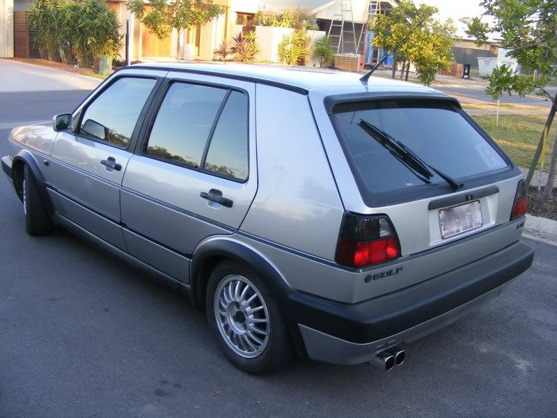

        SO the MK2 got tinted today by some good friends of ours
        Perfect excuse to take many phots
        Still a bit of a amatuer photographer.
        HAHAHA

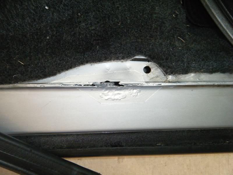

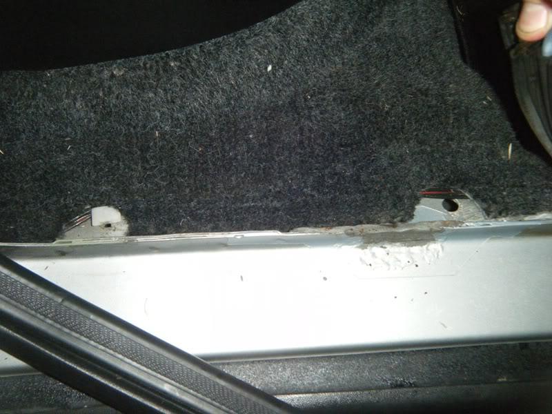

                Hit the rust with a rust converter (from Bunnings ) and let that dry over night.
                Next up I gave it 3 prime coats with kill rust (in a tin), which turned out quite well.
                Finally (paint wise), just used a old tin of touch up paint from our old Falcon, (wasn't even sure how close the colour was) gave it 5 light coats and the result was this.
                Of course I sprayed as much fish oil as possible inside the tunnel to hopefully slow any further rust (god forbid it come back!)
                Then just put some "Knead it" to fill the hole and give it a bit of water resistance.
                This hopfully won't be permanent, just until I can afford to get new metal welded in there properly.

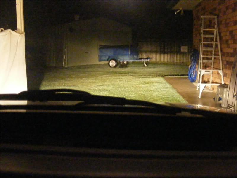

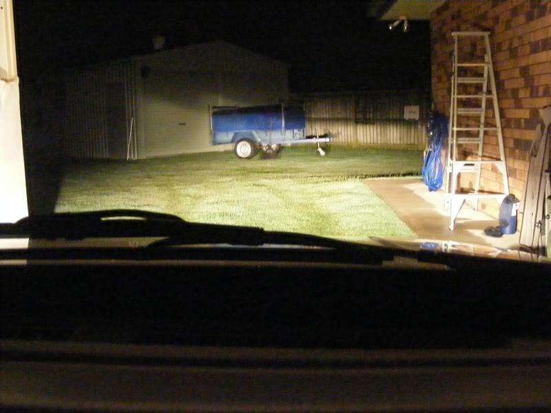

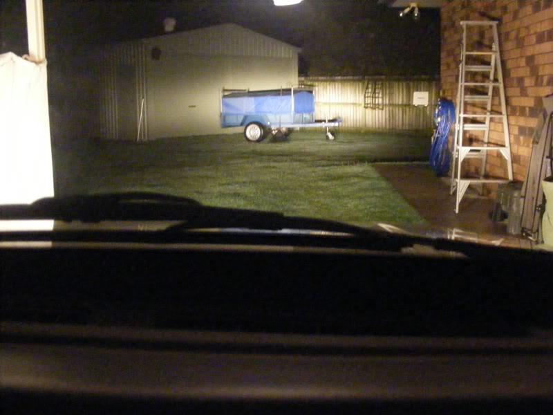

                      We'll today I did the Upgrade that Ive been planning on doing for a while....upgrading my headlights!!!
                      As any MK2 owner would know how craap their headlights are, I followed the step by step thread posted by velly_16v_cab in the 'Conversion' area of the forum
                      Now I actaully have decent low beam!!!
                      Lowbeam/Dip Before and After
                      And the High beam Before and After (Not as noticable result)
                      Planning of getting some Philips Extreme +80 Globes once I have the $$.

                        -Addressing a split steering rack boot.
                        However, we only had our friends hoist for about 5 hours in which time we only managed to do the first 2 things on the list!!!

                        • #57
                          Can I be nit picky and ask if the camera had the same settings kept for each photo?
                          Thanks
                          • #58
                            Thanks
                            Certainly did, didn't change a thing.
                            The car was also in a similar position both times aswell.
                            HAHAHA
