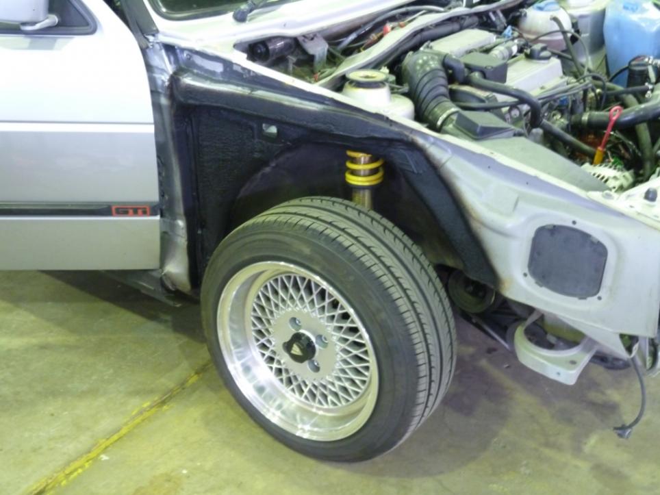

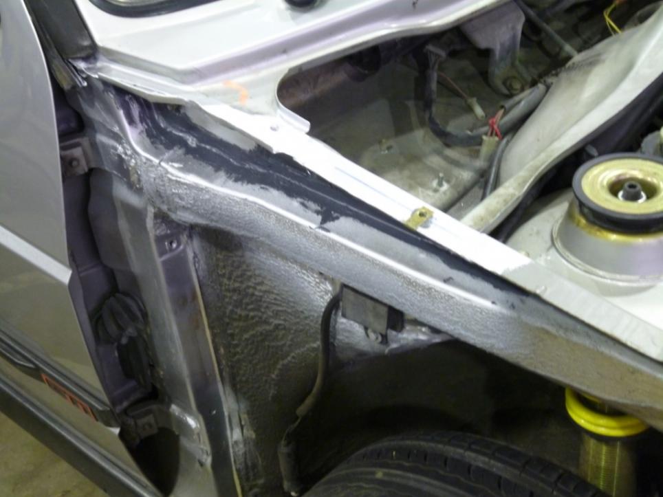

      Final Stages,
      Cold gal, primed and painted with some seam sealer.
      Bit of under-spray to neaten it up.
      Some assembly required...

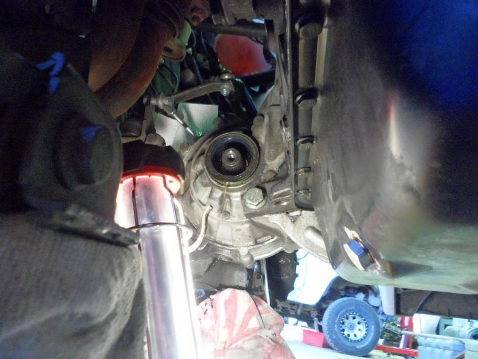

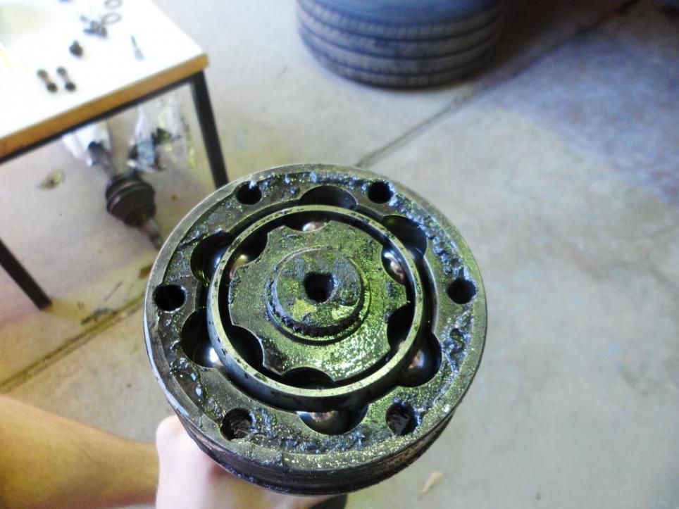

            Another CV boot split, so instead of the continuing "replace a CV boot every year trend" decided to replace both axle assemblies.

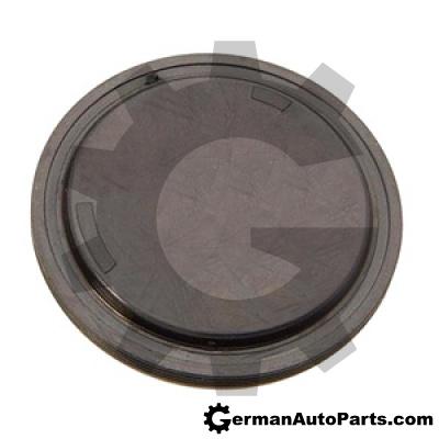

            Also redid the tranny output seals as last time forgot to put this cap in,
            Which resulted in this CV having its grease washed out....(thats straight out of the car, no cleaning lol )

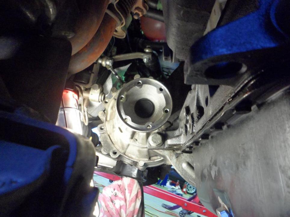

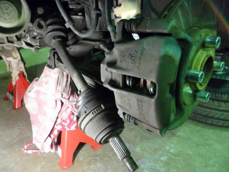

            So out comes the lower ball/rod joint (must FULLY remove pinch bolt, as I found out) and drive shaft slides out, after removing that big axle nut.
            Ahhh, young seal we meet again...
            Seals replaced and cap INSTALLED this time

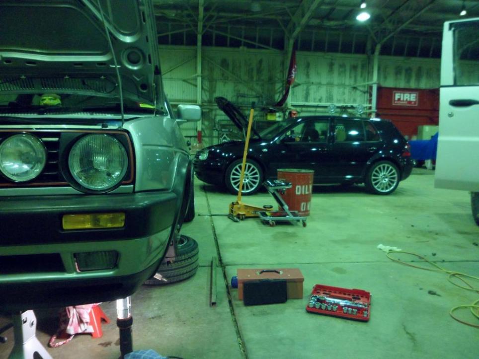

                  • I envy you have such a big workshop to work on your car
                    • Your workshop makes mine look like a wardrobe!
                      I'm certain I'll need to do cv joints soon too!
                      How long did it take you do do Ryan?

                      • Originally posted by golfmeup View Post
                        About a month because I only have access to the hangar 1 day of the week
                        Wardrobe doesn't seem to bad now....
                        Its an easy job, if you have the 'specialty' tools.
                        Spline drive
                        Retarded CV coupling compression thing
                        And a GOOD pair of circlip pliers.
