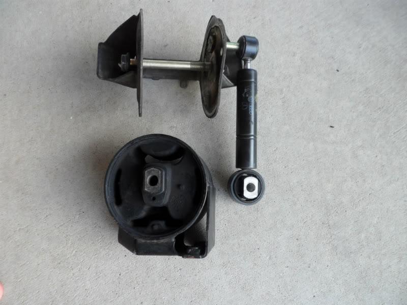

Purchased a hydraulic rear engine mount (thanks to discussion on ED38 ) and had that installed.
Again, big improvement in drive-ability when the engine isn't jumping around the bay.
^Old mount wasn't terrible but needed replacement.
The hydraulic damper was actually in good condition apart from the completely melted/FUBAR'd rubber bushing on one end!

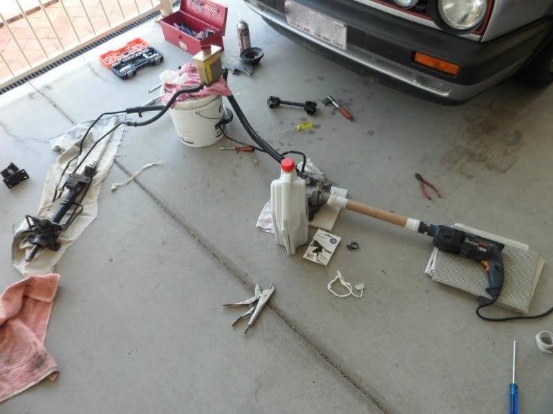

Recently acquired a 2nd hand PS setup, so I thought I'd test it out.
No leaks at 650rpm and the pump/rack 'respond' well to each other.
HAHAHA
You are very innovative, Ryan.sigpicParts for sale http://www.vwwatercooled.com.au/foru...ff-102387.html

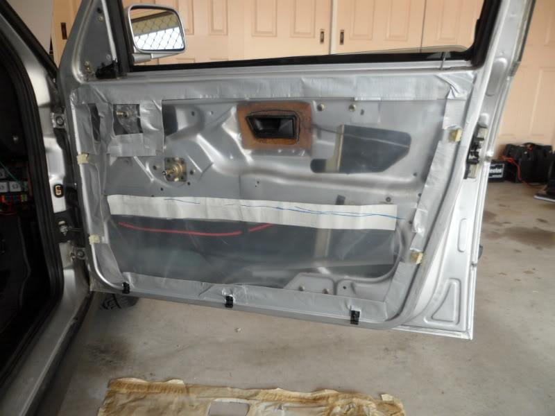

After a noisy trip to Toowoomba and back, decided it was time to finish some things.

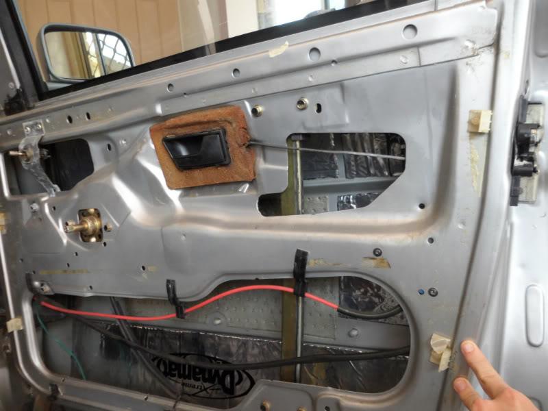

Used the rest of the leftover Dynamatt in all 4 doors,
Replaced the old vapour barriers in the doors (old yellow, mummified vapour barrier below)
And had the pov African spec door cards reupholstered,

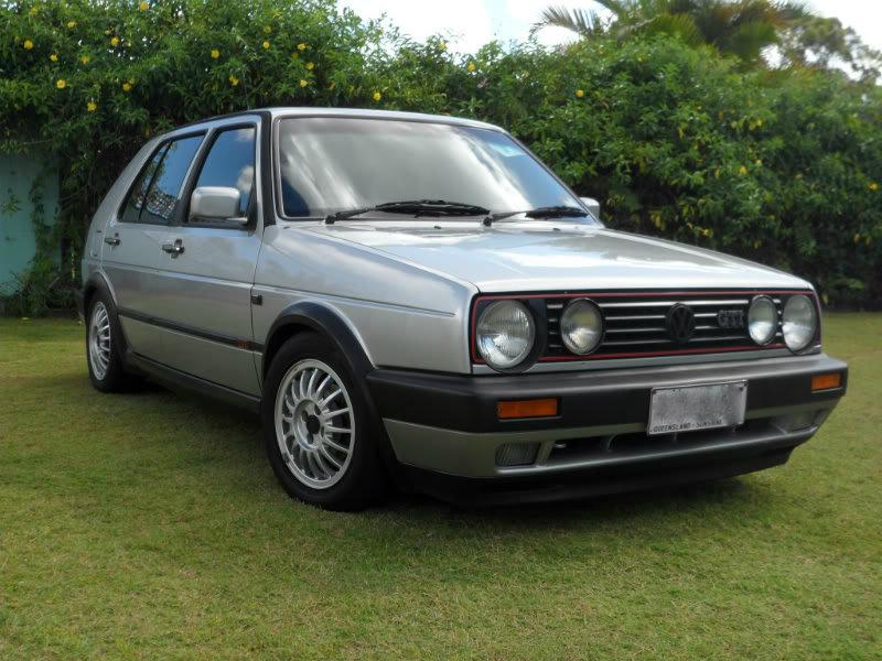

An exterior pic, just for you Water Boy
Have removed the old black vinyl that used to wrap itself around the car + new chrome door handle inserts.
