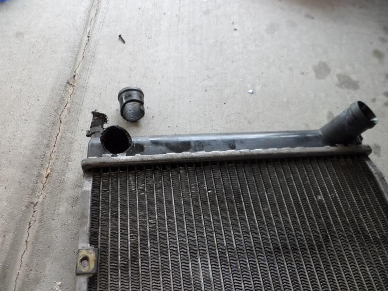

      Didn't get hot enough for any real damage, just awaiting quote's on a replacement rad.
      HAHAHA
      • My radiator did that.
        Got a German made replacement for $210
        • That must be a common weakpoint on the radiators, that's where mine went too.
          Good job MK2 front ends are so easy to disassemble.
            Assuming its because that area always receives the hottest coolant.(?)
            The front end is pretty simple, would be easier without an A/C condenser and headlight relay loom
            HAHAHA
            • WAs theer any telltale signs of impending failure like frequent coolant topups? Or its just popped suddenly?
              Got Turbo Inside
              • Originally posted by rutti View Post
                There was actually, I thought the hose was just loose, so like an idiot, kept tightning the circular clamp.
                The plastic was extremely brittle, almost like chalk, in my defence

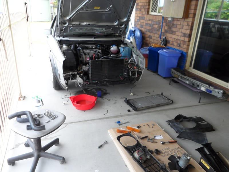

                After a quick delivery from Camden GTI, the new rad was in ASAP.

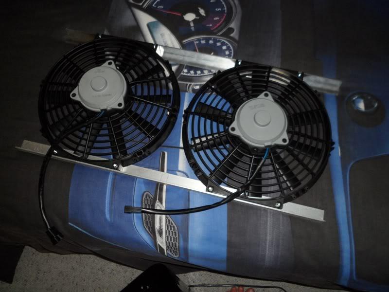

                However, refitting the OEM fan and fan shroud is rather difficult, particularly if you have AC (plus it looks dumb)
                So, dad and I put our heads together and made our own little set-up.
                Still a little bit of work left to do, but am very pleased with it.

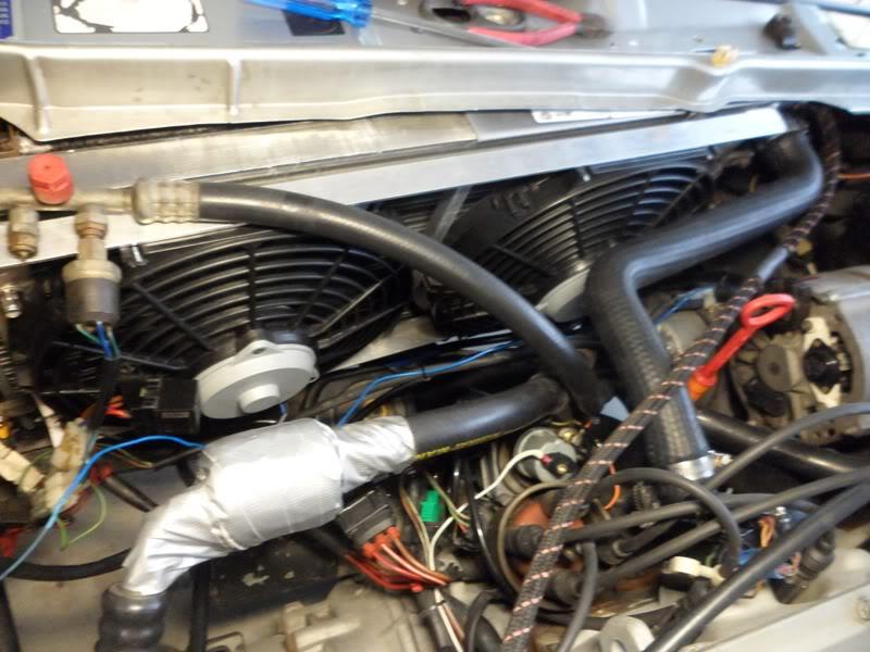

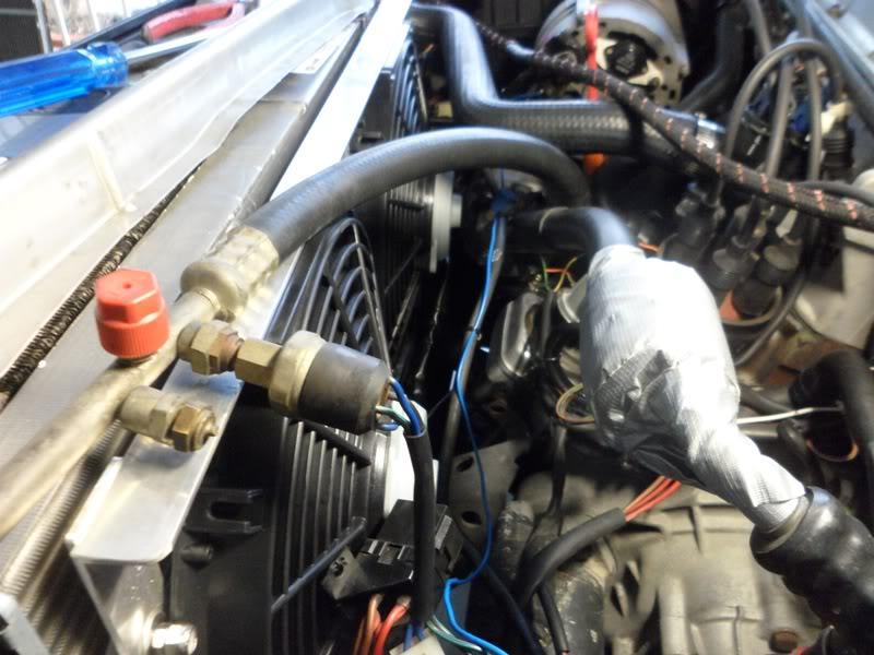

                          • What's with the tape on the A/C pipe?
                            • Thank-you all for the encouragement and kind words, really do appreciate it
                              Just a bit of insulation, with a cut up stubby cooler, wrapped in aluminum tape and then some cloth tape as a final layer.
                              Looks sus, but I've seen US guys wrap their entire A/C gas line (cold side) in proper, dual layer insulation tape.
