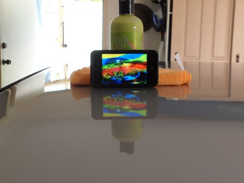

      Not very interesting so here's a piccy of my recent polishing work to the roof/bonnet.
      HAHAHA
      • Shiney!!

              • Nice work on the polishing! I have to do mine but only have the bits to do it by hand
                • Originally posted by AusScare View Post
                  Haha thanks, its nowhere near perfect, but much better than what is used to look like.
                  If you have some spare time and $$, this is the kit I used,
                  Car Care Products / Car Care Products / Car Accessories / Buffing Machines / RO Polisher DAS6 Starter Kit

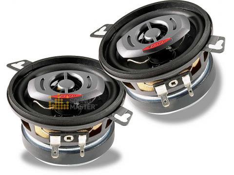

                  • I got the speakers overnight from Sydney! Very impressed by Ryda.com
                    Only 3.5inch, but very chunky little things,
                    Pretty much a direct fit into the (empty) dash holes, they're not bass monsters, but the sound from them is really crisp/clear.

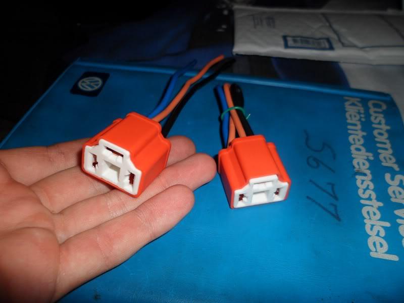

                    Also bought these ceramic H4 plugs as part of a plan to revamp the headlight loom (again), from LARRIKIN PRODUCTS -,
                    Graeme is a top bloke

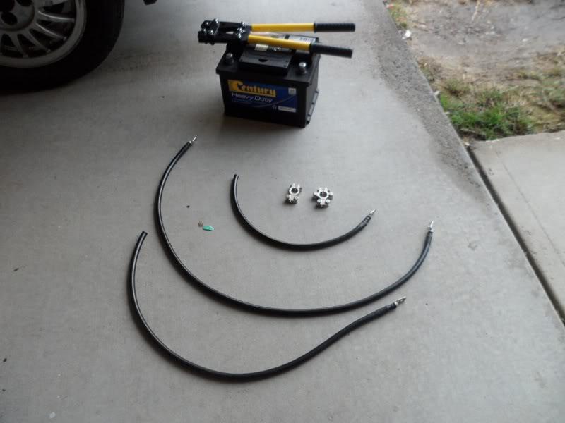

                    • After some recent pretty slow start ups and boredum, thought I'd make up some new batt/alternator leads.
                      2 gauge (35mm) wire from Jaycar, various terminals and may aswell throw in a new battery for good measure
                      I'll install it tommorrow after I recover from last night.
                      HAHAHA
                      • good work, loving the DIY.
                        useful upgrade too, for cars that are starting to get on a bit...
                        • Thanks Jarred, it certainly is a good upgrade/update.
                          I think the starter motor is more powerful than the 8v now
                          Alternator output voltage is up too.

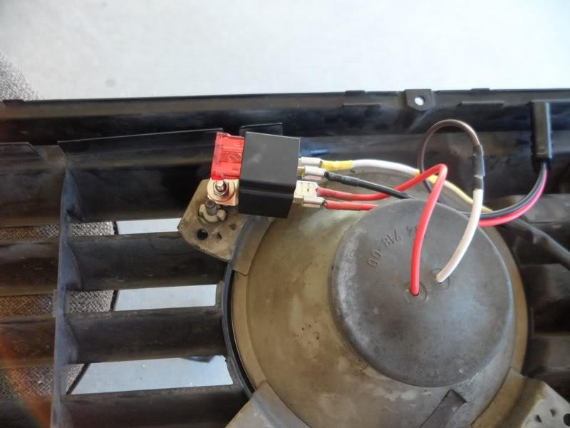

                              • Spent the last couple days re-updating the headlight loom.
                                All the connections on my initial relay upgrade (1 relay PER bulb) were all crimped.
                                This time (after removing the crimps) I crimped, soldered and heatshrinked all connections.
                                Incase anyone is looking for relay mounting points for for the high's on there MK2, I found this to be quite effective,

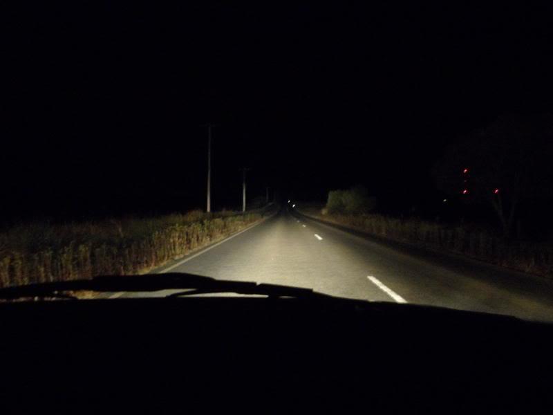

                                Since the connection's were being redone properly I also went out and bought some Philips 100w H3's for the high's.
                                Main Beam (came out blurry?)
                                High Beam (same location)
