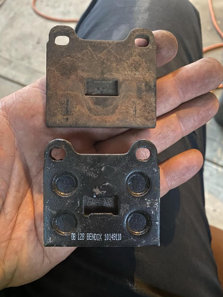

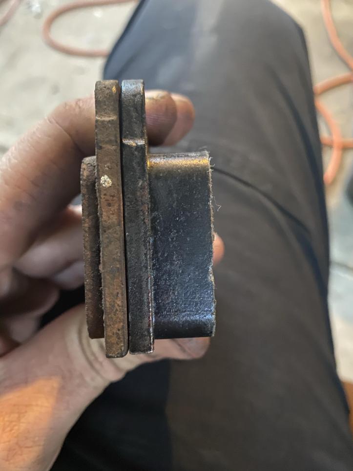

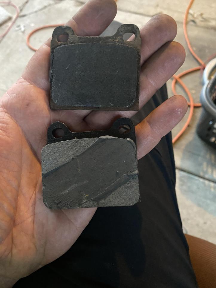

    So, I’m having problems fitting the brakes. Apparently early ‘79 and late ‘79 have different thickness rotors and from the details I found on my car I have the right rotor thickness. But the pads don’t fit.
    Here are a few pictures of the old and new pads which according to size is the exact same.

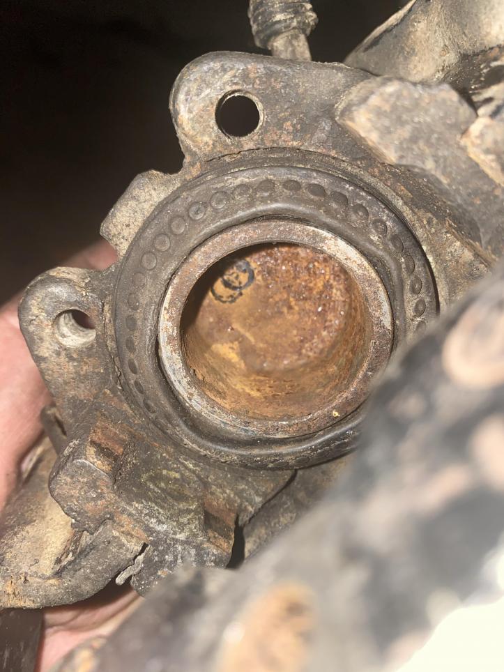

    Anyone with info or help on this issue, please share I really can’t figure this out. My last resort is, overhaul kits for the callipers and just pulling it apart, cleaning it and then fresh seals etc.
    • #62
      I had the same issue and had to reorder pads for ones that were thinner. they looked identical and I thought my calliper wasn't all the way input I eventually found it was pad thickness that was the problem...
      • #63
        Went and double checked with the shop I bought from and there are two pads listed with the exact same thickness.
        Worst case scenario, I buy overhaul kits for the callipers and maybe do the same and search for exact pad but slightly thinner. [emoji2371]
        • #64
          I just machined off the extra thickness on a set of bike pads...
          The material is the same on both types, just the thickness that’s different.

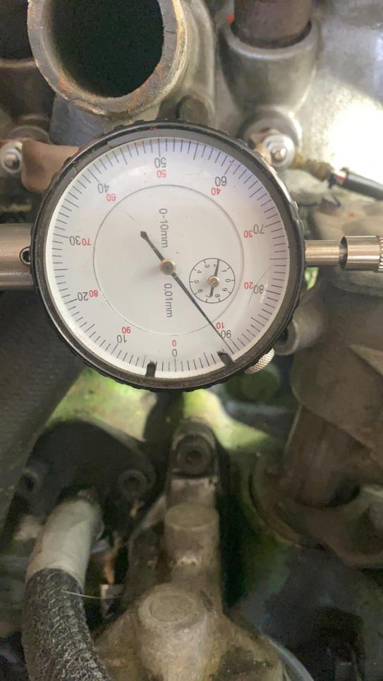

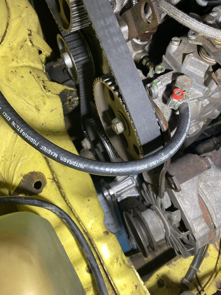

                      New Timing belt[emoji736]
                      New Timing belt tensioner[emoji736]
                      Timing adjusted to have near perfect TDC[emoji736]
                      New Water Pump[emoji736]
                      New water pump/alternator belt[emoji736]
                      New front engine mount bush[emoji736]
                      Fuel pump timing set[emoji736]

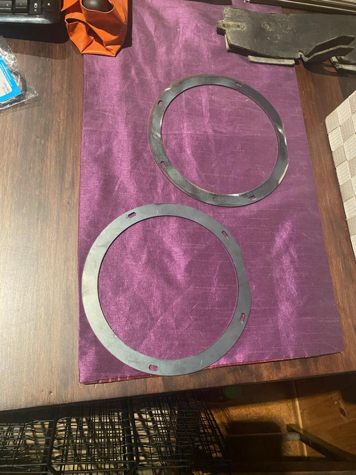

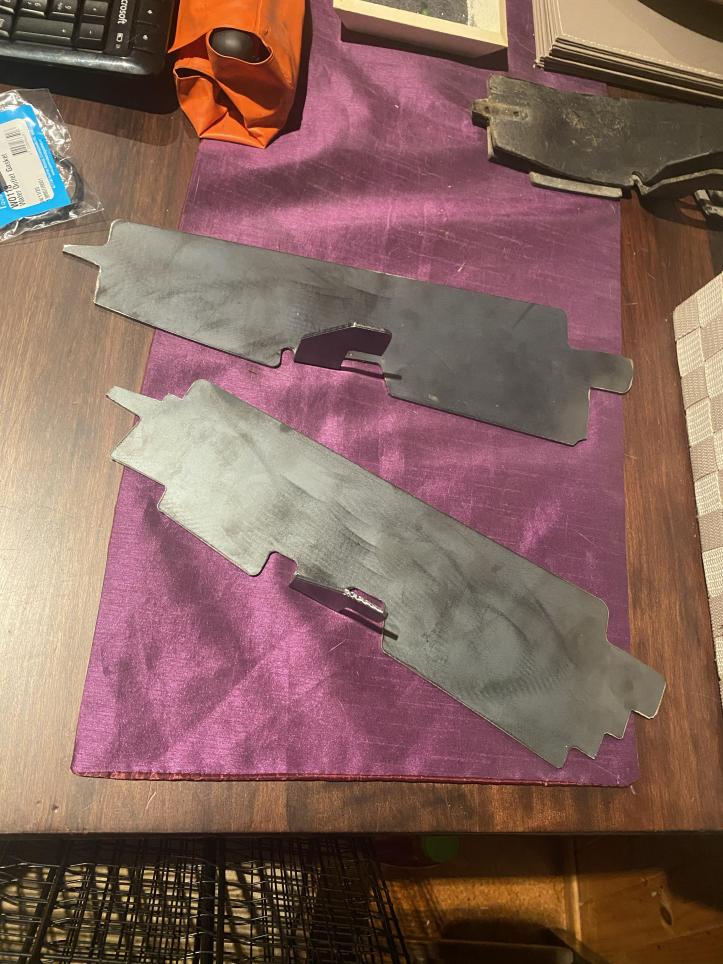

                                Received my laser cut pieces today and quite happy with the design we have come up with for the new LED headlights but also how the ar guides for the radiator turned out.
                                The first picture is the start of the LED headlight brackets which was made from a mock up I made with a cardboard box so they can see what I want and need. There might be some small mods needed here and there to have the brackets work and fit 100% as I still need to add a mounting point for the headlights on these brackets but also add the adjusting screw holes to be able to have the lights sit perfect and where they need to shine. The main part of the bracket will be bolted down with 3mm bolts and I’ll be using nylon nuts to help with extra security.
                                The second picture is the air guides for the radiator. And although they aren’t completely finished yet either, there are one or two methods of finishing them up to sit properly and work the way they should. At the moment as you can see in the picture, the very top part is not bent at a 90degree angle like the originals as I have a plan for securing them down even better, rather than using the self tapping screw and the clips to hold it in place. Once again, I’m thinking about doing 3mm bolts with nylon nuts but it all depends on whether the top part bends underneath or over. Cause I can also use rivnuts which help make things so much easier to remove but also assemble.
