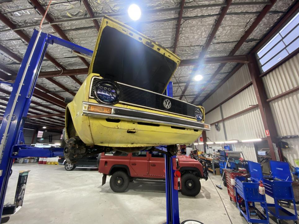

              But, looks like I might be able to try sneak her to work(the workshop I work at) and try do some other things extra to her where I have access to a hoist and pretty much any tool you can think off.
              And have some access to try and tidy up some of the new stuff I had made by sandblasting and painting etc.

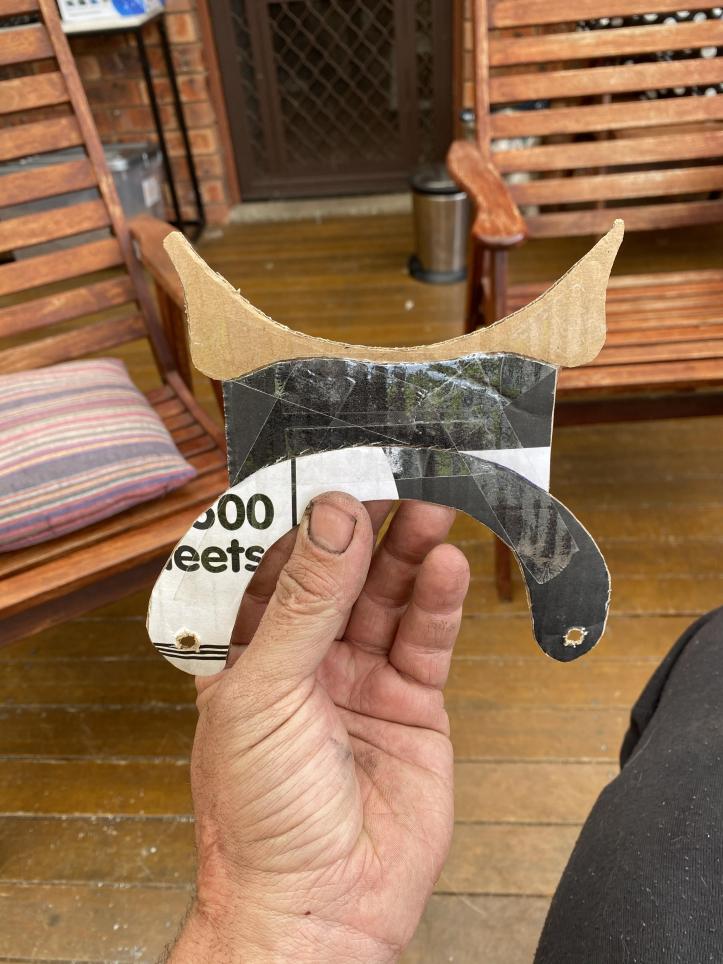

                  I didn't know you were a CAD expert.
                  Cardboard Aided Design.
                  • #99
                    Hahahahahaha...[emoji23][emoji23][emoji23]
                    I make do with what I can to try and get things done for now. At a later stage there will be proper laser cut pieces done for many of the stuff I have done and still want to do.

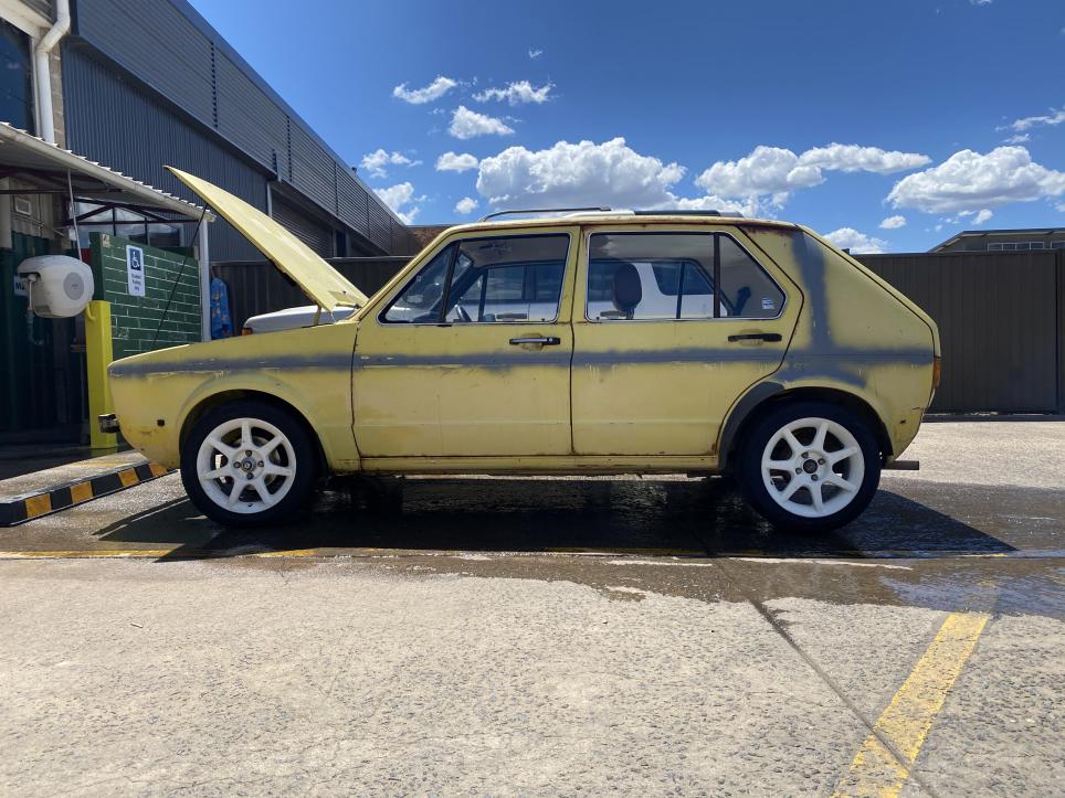

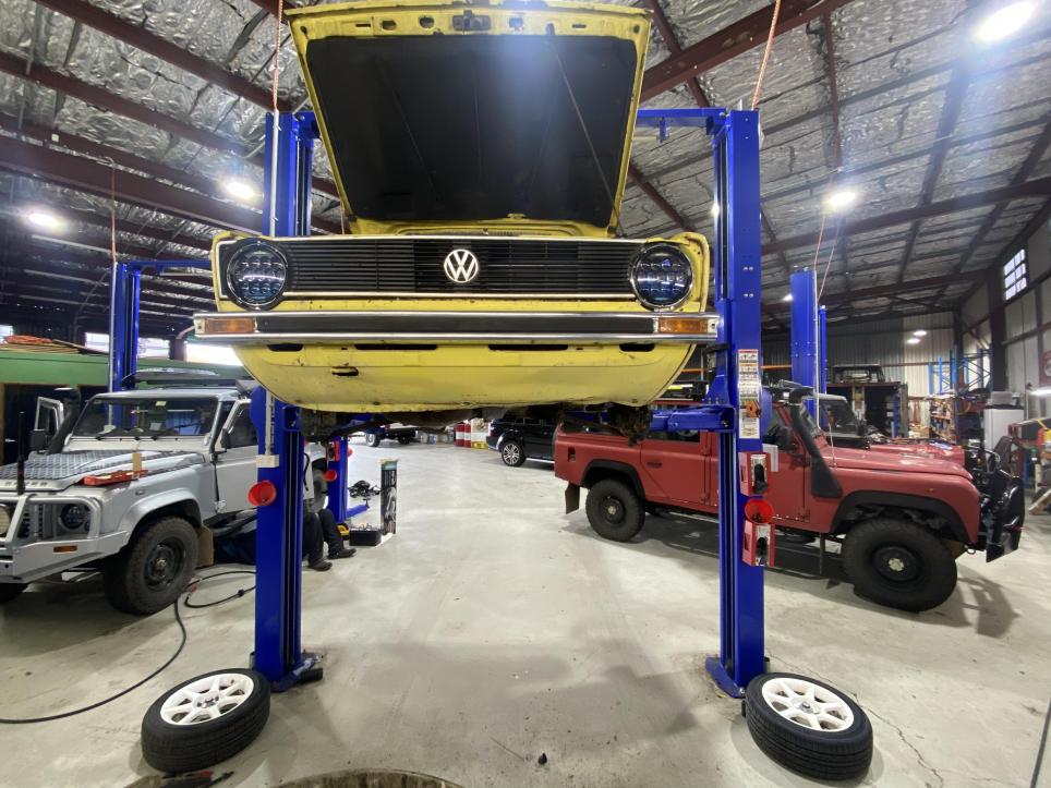

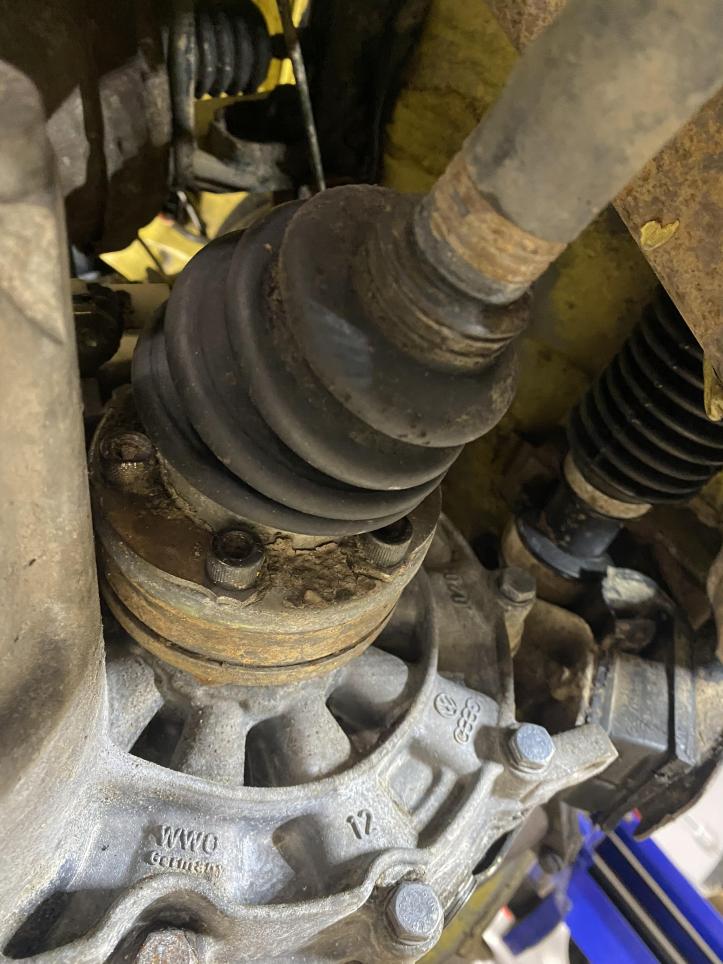

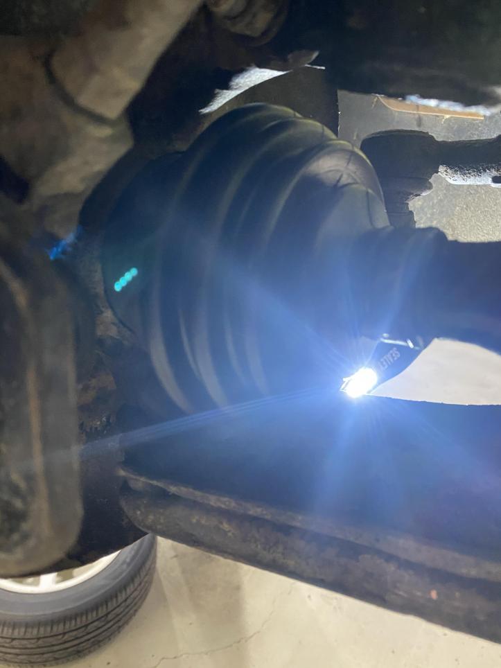

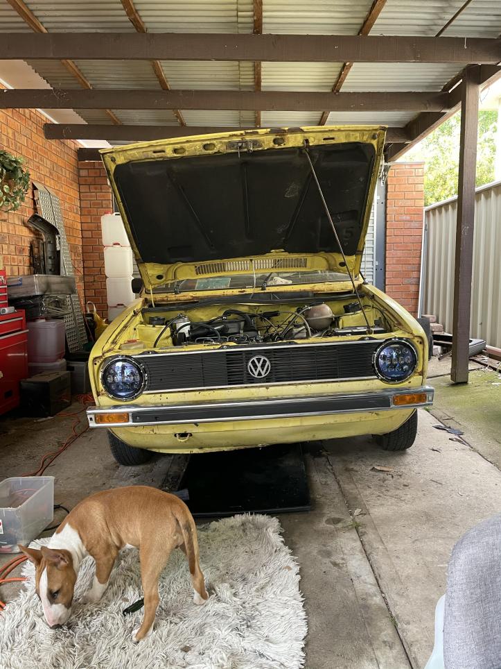

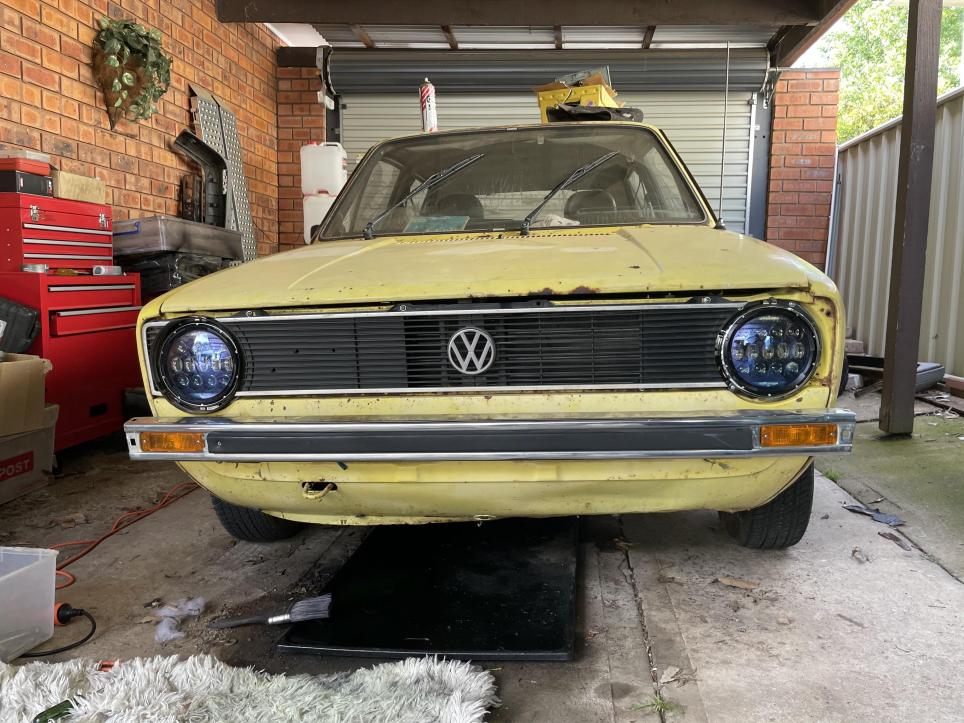

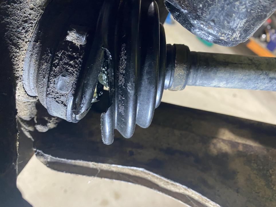

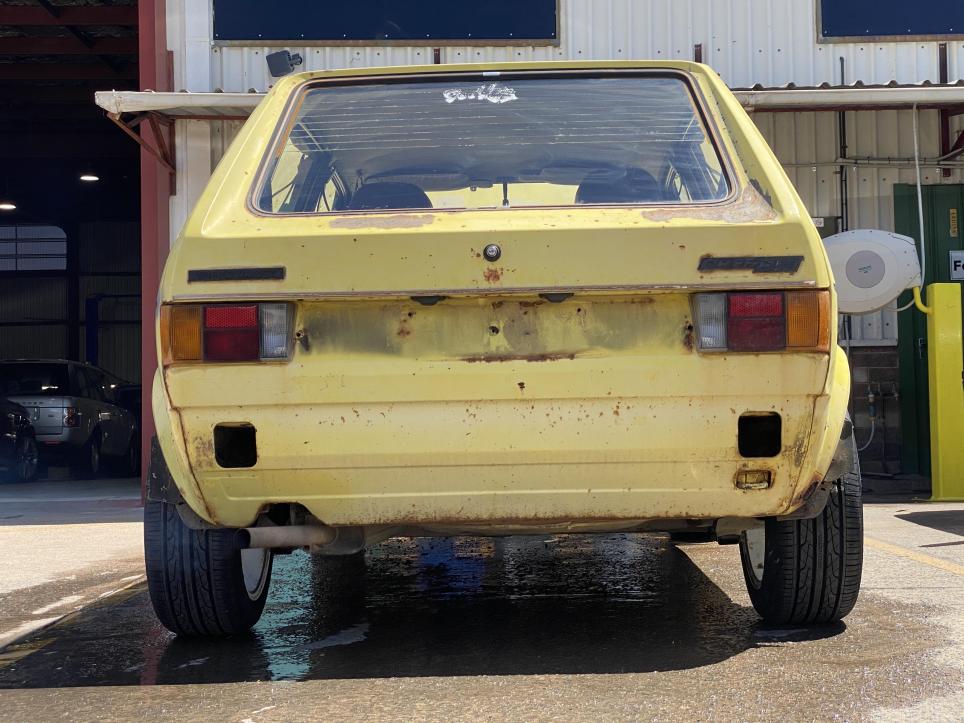

                    • Been a little quite lately, as work has been very busy, but have managed to do a couple of things. I managed to get the headlights wired in, wheel alignment do e, got new wheels and put some good tyres on it.

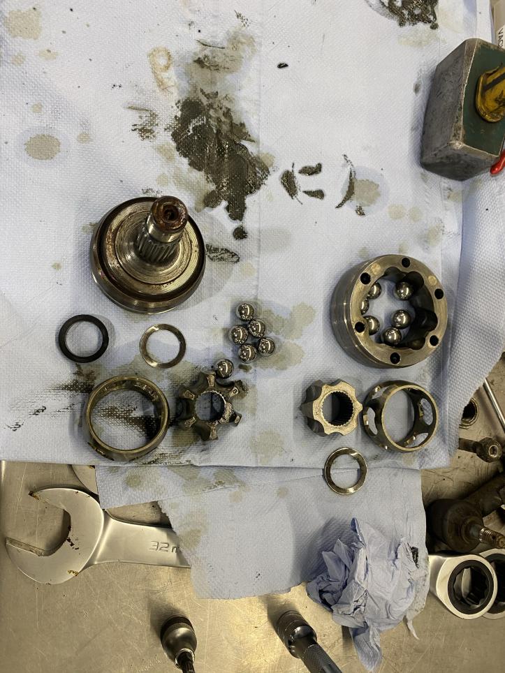

                      Still to do, fit rear bumper, install new rear view mirror with built in dash cam and also a reverse camera. I have to pull the drive shafts and repair a couple of CV boots, but while I have them out, I’m going to do a full service on the CV’s.
                      I’m also doing a good clean under neath the car for rego inspection reasons. As I think I have managed to repair all oil leaks, but have to still clean it up so I can see if there is any more.
                      But the cleaning is also for me making sure there is nothing bad hiding it any nooks and cranies.
                      Will post pictures tomorrow of what I have done of late.

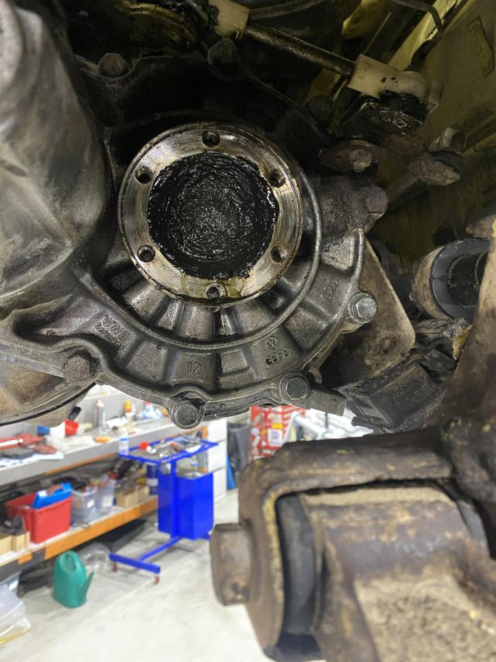

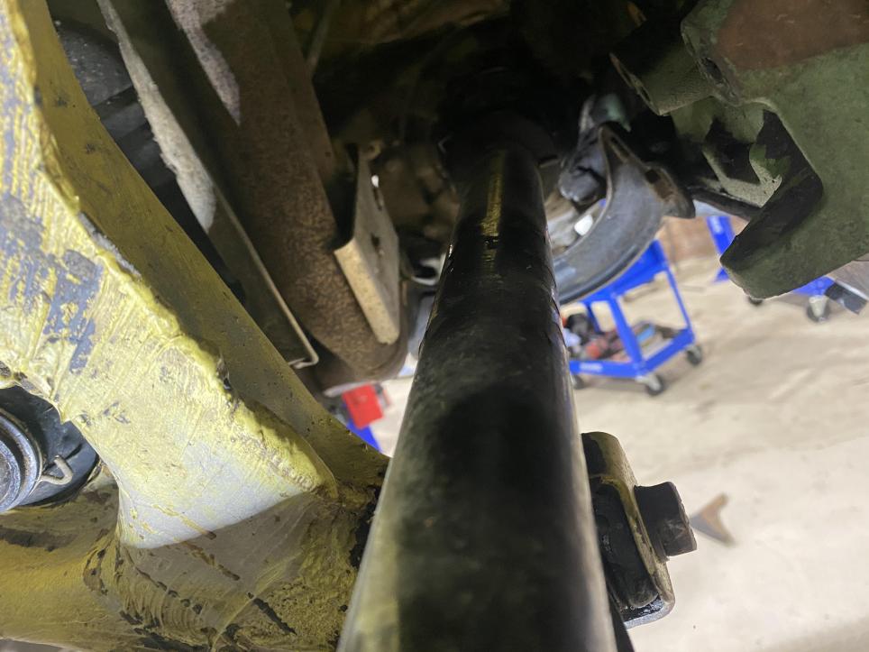

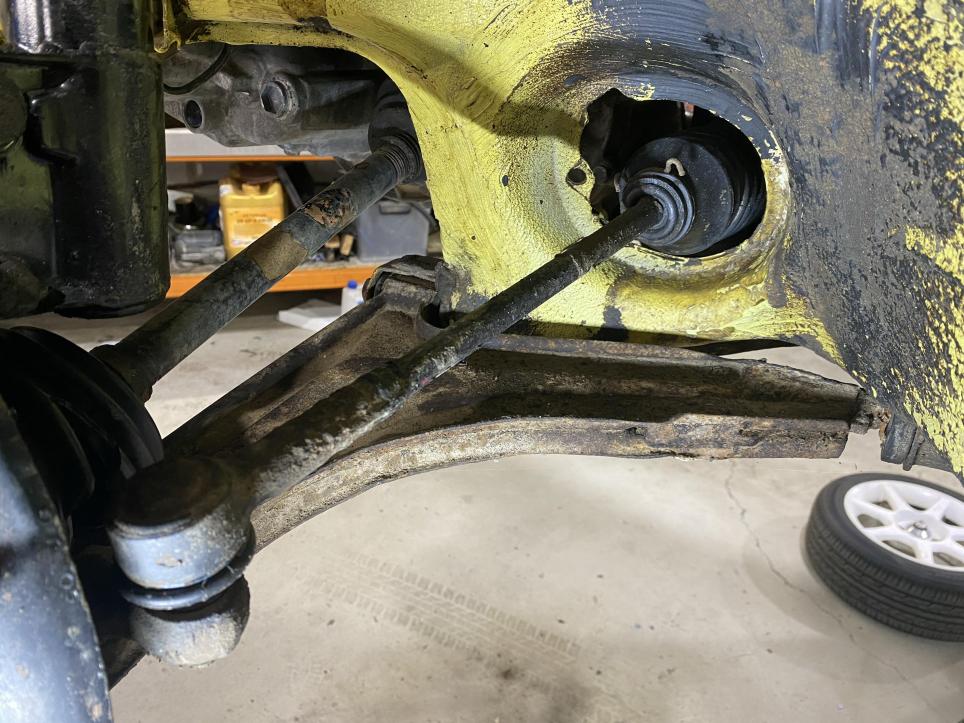

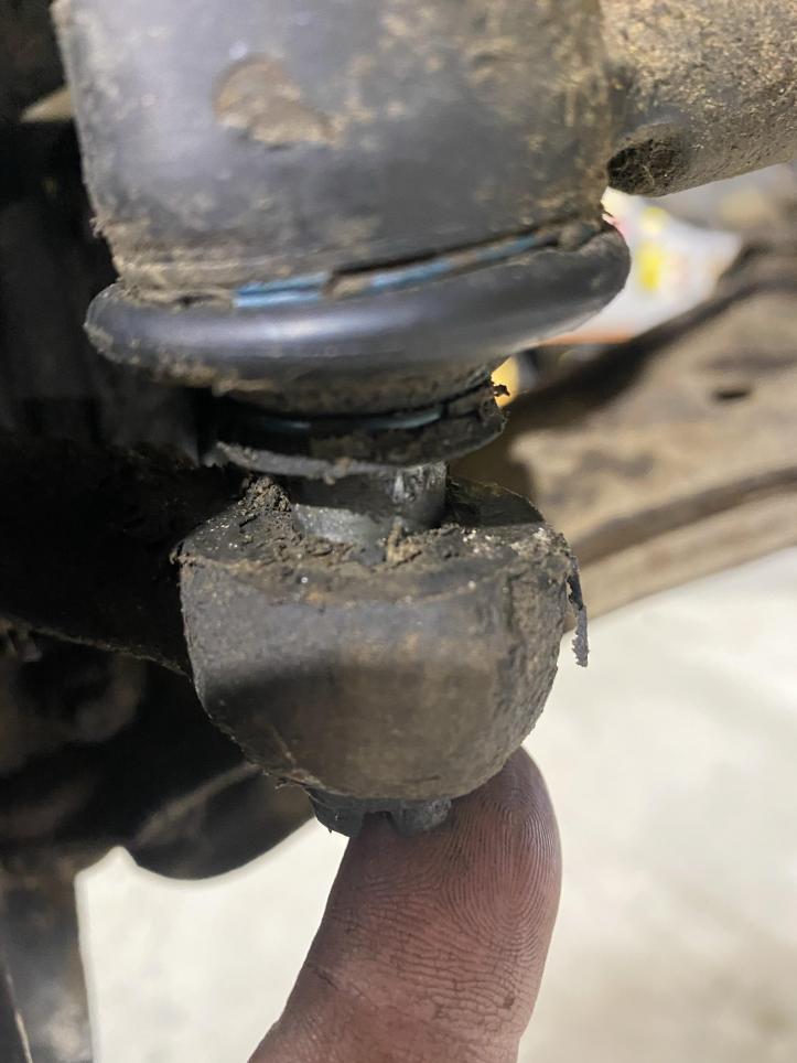

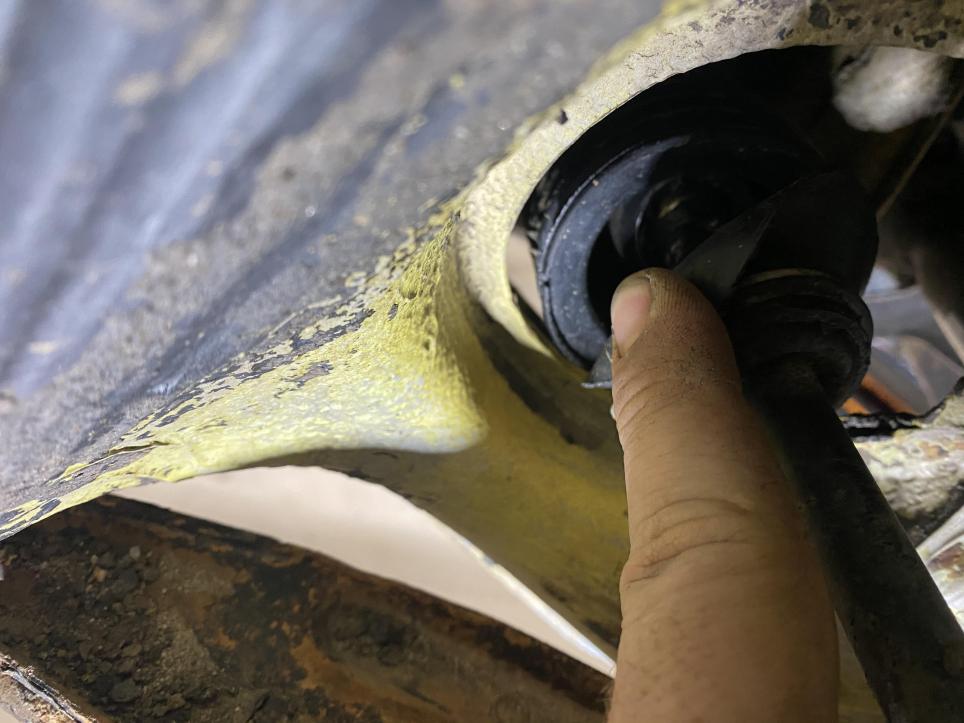

                        • Been a little quite over the last few weeks. Work has been very busy but I have sourced locally some parts from a shop in Sydney called Tooley Imports.
                          Thanks to Richard and Paul for assisting me yesterday with everything but one piece. I can now redo CV’s and rack ends between today and tomorrow.

                            • Good afternoon all,

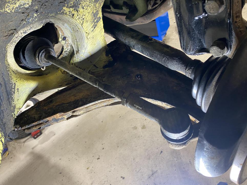

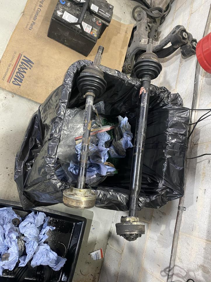

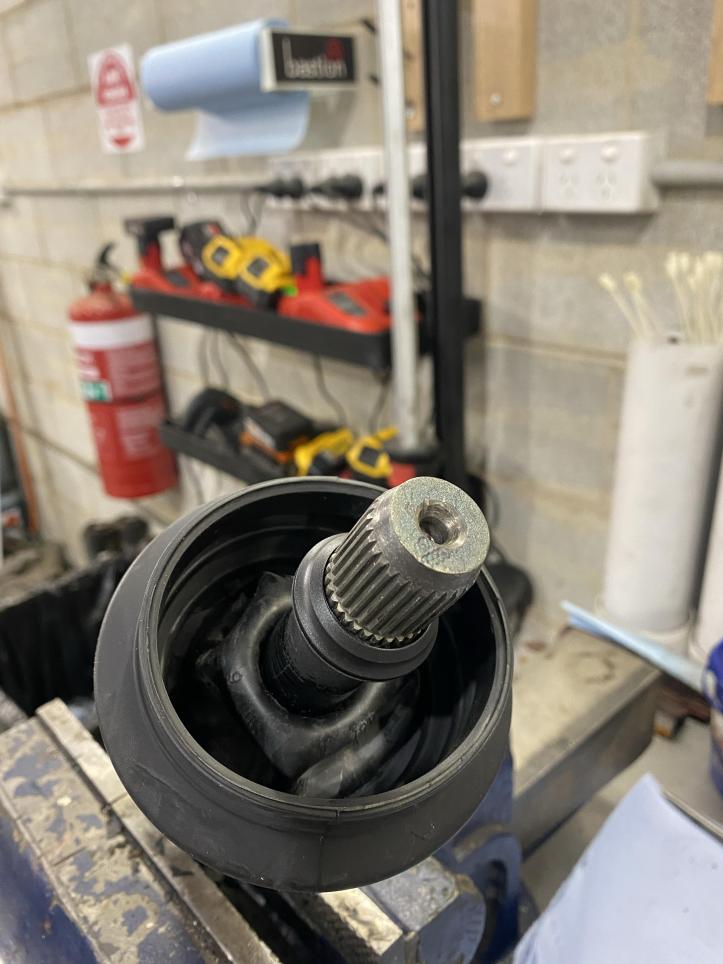

                              Life has been way to busy lately but hoping it’ll calm down in a few weeks. But I have had some time to do some work on the car. As last mentioned the service kits for the CV boots and the rack ends arrived.
                              How ever, the throttle cable is the wrong one, so, I’m still chasing that and a choke cable for the diesel. How ever, I have done the CV’s and the rack ends, but also had time over the last weekend to tidy the inside and also fit a new battery with some new cables and terminals etc.
