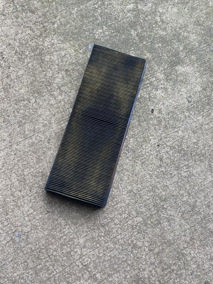

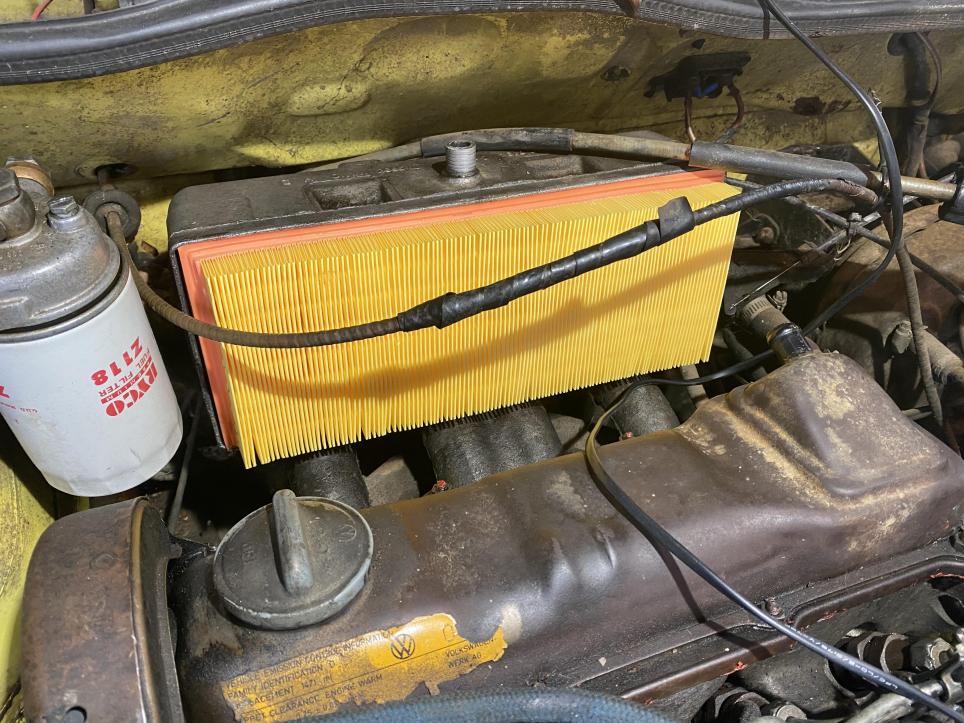

    Changed air filters out, drained all the diesel and put fresh diesel in, and my supervisor(Khaleesi) is happy with the job so far.
    • #17
      Damn that filter needed doing...
      Does she run now?
      Not uncommon for the injectors to get gummed up when sitting for a long time too.
      Whilst I’m not normally a diesel guy, happy to lend a hand...

        Yeah, that filter and intake was filthy. Nearly got her started. I’m still finding problems with start issues. Like the glowplug power supply has been bush repaired instead of putting in a new fuse.
        Going to have another crack today at it. Will ask questions when I’ll struggling. Thanks mate.
