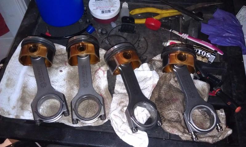

  • Done a bit this afternoon after tea.
    Rods built up
    First one in after also checking ring gaps
    And the rest
    Rods bolts torqued up the required 3 times to 50lbft

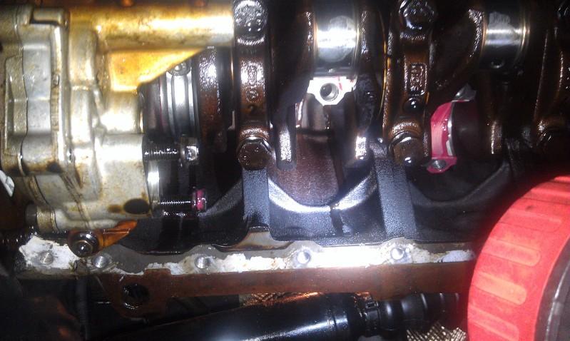

    The sump is now on. It's a spare as the drain plug was stripped in Lito's.

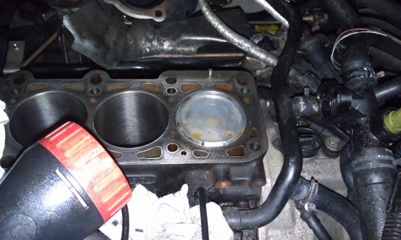

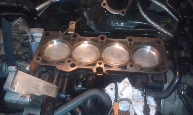

    Tomorrow morning I'll be doing the belt and water pump, as well as dropping the head back on.

            Hey mate just wanna know, how did you replace the rods ?
            Kay
            Garage:
            VR6
            XR6
            R36
            • Originally posted by KKK VR6 View Post
              Kay
              You take out one of the circlips holding in the wrist/gudgeon pin. Then you can push the pin out from the other side. Lube up the little end of the new rod and push the pin back through. Reinstall the circlip. Easy.
              Watch where you put the notches for the big end bearings, they need to be on the inlet side of the piston.
              I checked the end gaps on all the rings for all the pistons, before fitting them on the rods and installing them in the block.
              You should check the big end clearances too with plastigauge but as we were using standard sized bearings and there's hundreds of these rod in existence, I didn't bother doing this.
              There's a good 1.8T rod install on youtube in 5 parts.
              Hunt down my number and call me if you like. Anytime in business hours is ok.
              Gavin

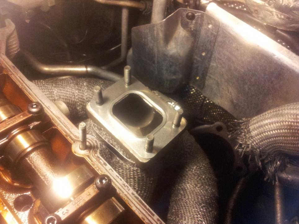

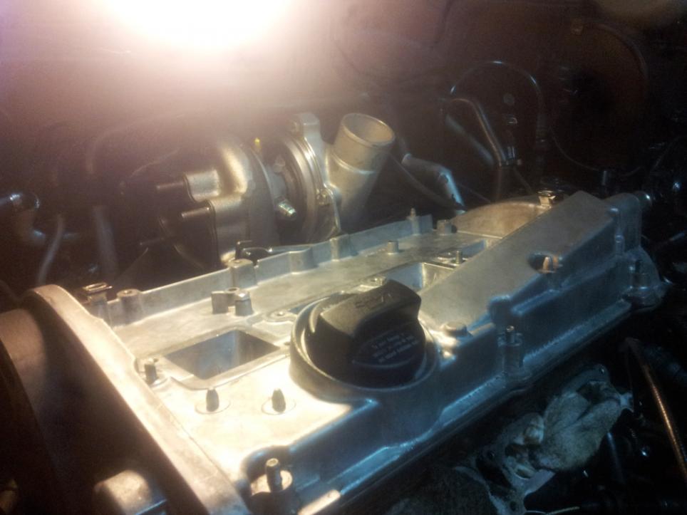

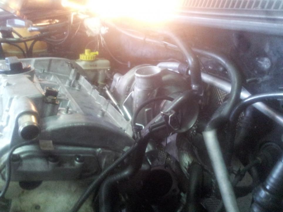

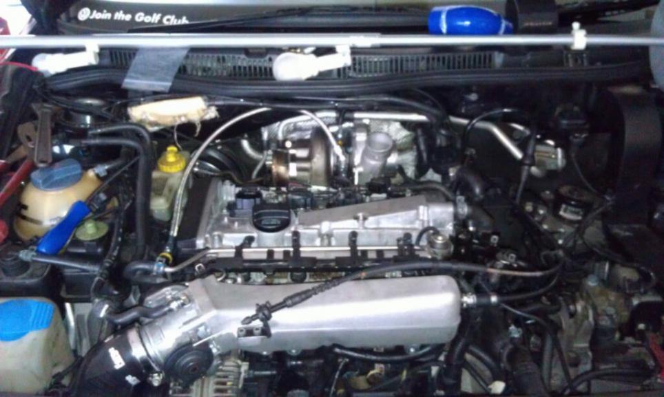

                • just a quick update from last night. turbo is bolted down and oil and coolant lines are being routed. intercooler piping will go back on with some modification as will the dump pipe
                  had to fettle with some heater hoses to get the tip to fit but all good now. all i can say is that it's snug in there but should look like it was meant to be there once it's all back together. here's a few pics...
