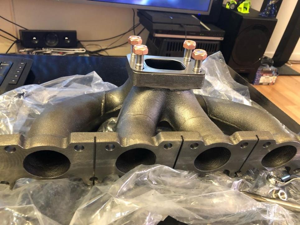

        Recently I had discovered a few cracks in the exhaust manifold and down pipe, also the turbo was leaking oil into my intake piping.
        Didn’t want to change the set up as I love the way it drives so I just bought another manifold (number 3 now [emoji2357]) and a new pulsar gtx2867r gen2 turbo
