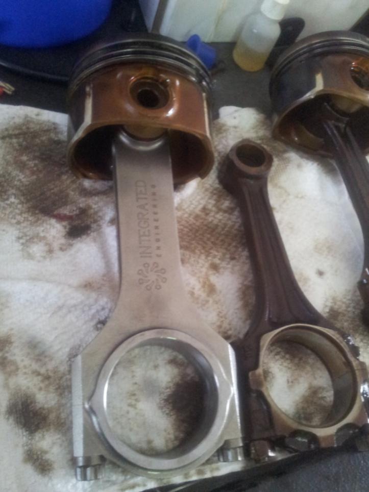

Thanks mate. Yeah the rods come with a little booklet. It says that the preffered method of tightening the rods is with a stretch gauge and they need to be tightened to 0.006" of stretch. It also states that if you dont have access to a stretch gauge to use a high quality torque wrench and tighten to 50ft/lbs 3 times per bolt using there supplied lubricantOriginally posted by KKK VR6 View PostLoving every bit !!

Torque wrench for us then.Originally posted by Lito View PostThanks mate. Yeah the rods come with a little booklet. It says that the preffered method of tightening the rods is with a stretch gauge and they need to be tightened to 0.006" of stretch. It also states that if you dont have access to a stretch gauge to use a high quality torque wrench and tighten to 50ft/lbs 3 times per bolt using there supplied lubricant

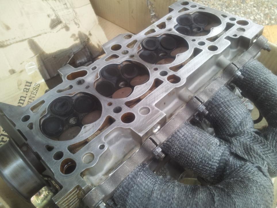

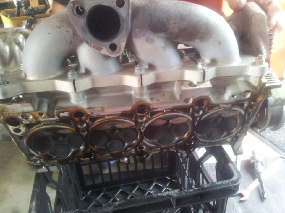

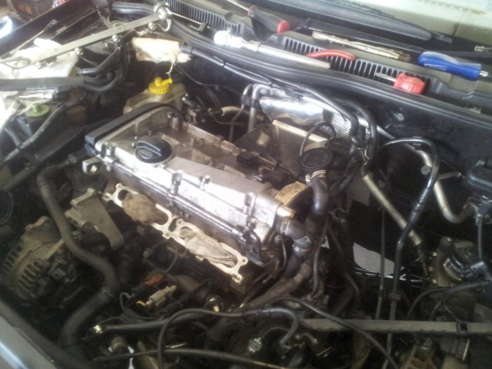

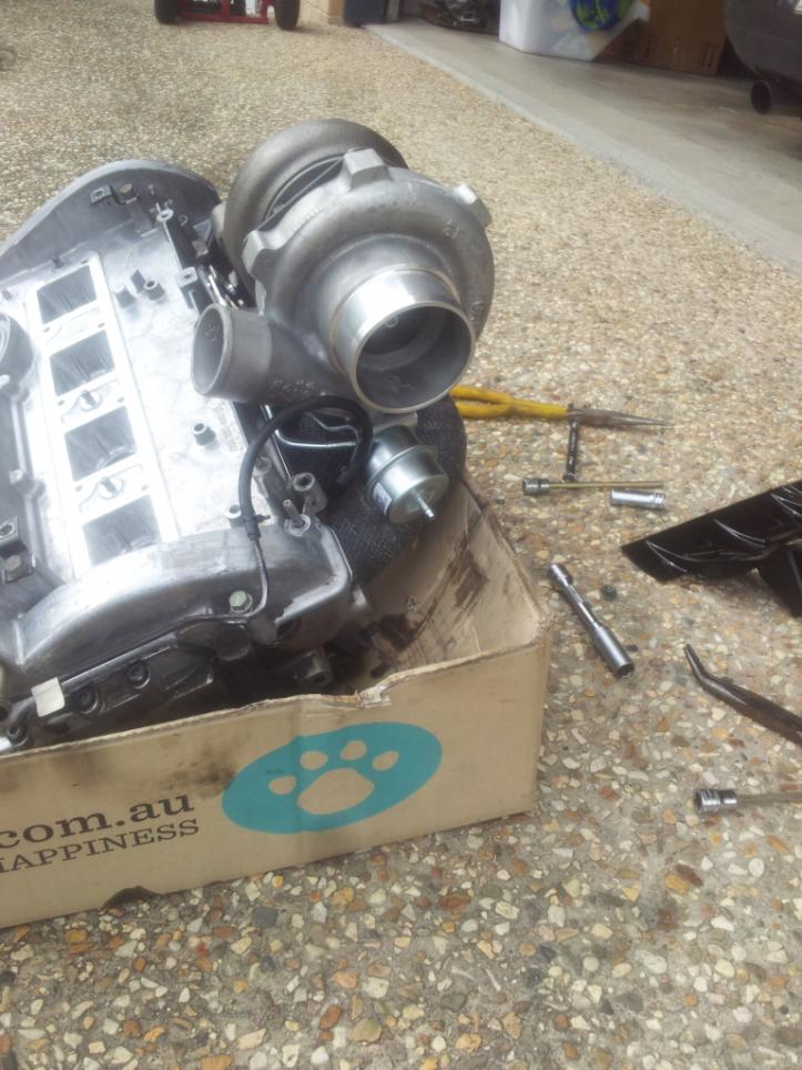

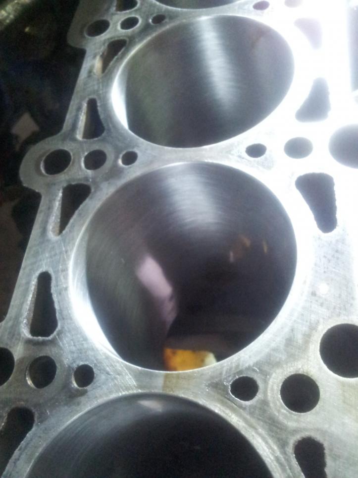

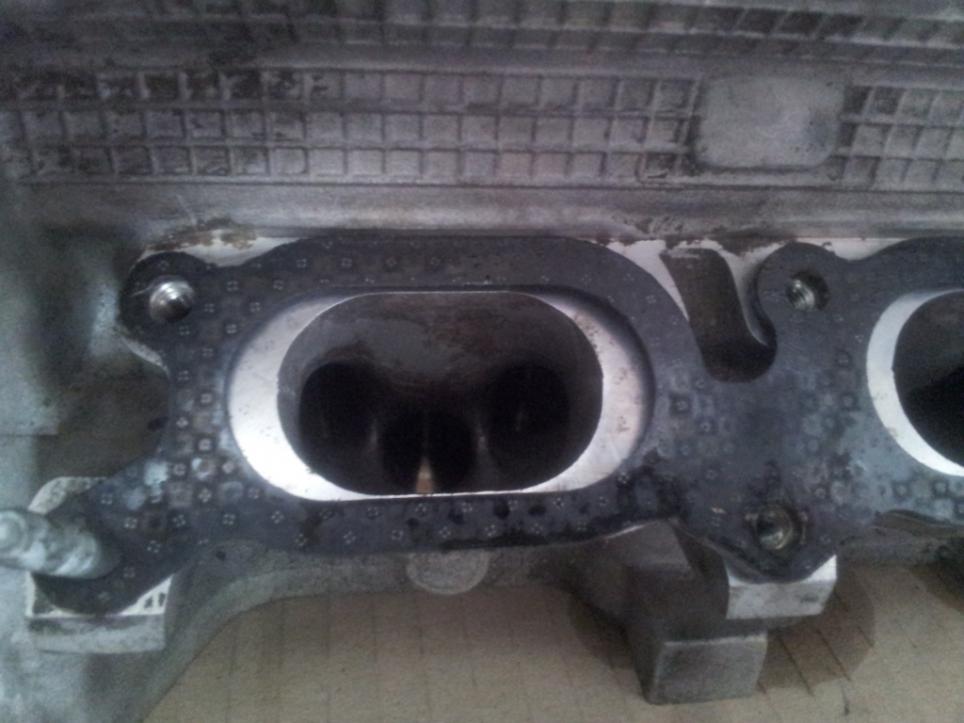

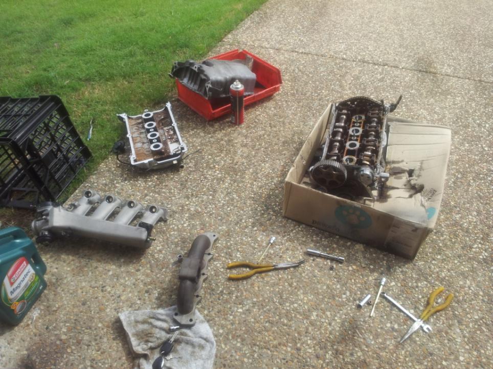

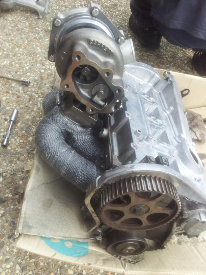

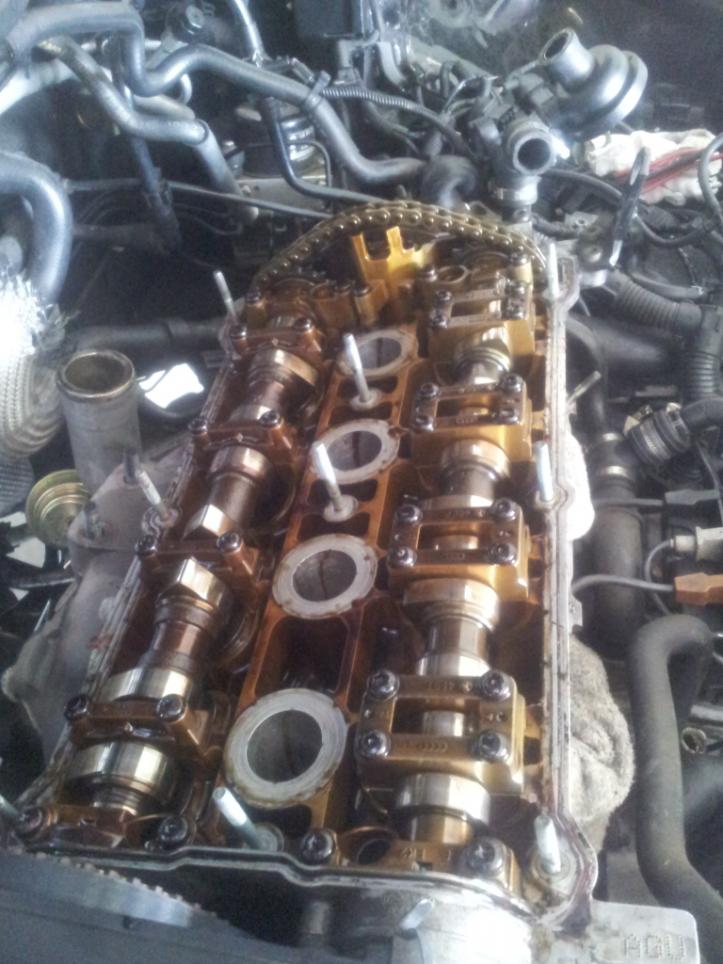

Cheers mate, just re-honed the block and dropping the rods it. Everything looked pretty tidy in there so just giving it a clean and putting it all back together. Here are some more picks from the rest of the afternoon...Originally posted by Njay View PostNice, are you just dropping in the rods or are you going to do any machine work
Sent from my HTC Desire HD A9191 using Tapatalk 2
Cracking the head bolts
Head off
Stuff ready for me to clean
Turbo mocked up on the head
Head after we cleaned it up
Cleaned and honed block.
Should be a bit stronger
Hooray for big port
Forgot to say a big thanks the Gavin and his very accommodating family. Even gave me his little red polo as a loaner!Last edited by Lito; 24-02-2013, 07:34 PM.

Hooray for big port

Will get those other rods changed over tomorrow and give the pistons a good clean up before fitting the new rings.
I'll have the bottom end back together by tuesday morning. Then the head on with manifold fitted.
There's a bit to work out with the water and oil piping. Once the sump is back on, I can do the timing belt as well.
If there's no dramas fixing up the turbo to downpipe, we'll be running thursday or friday.
