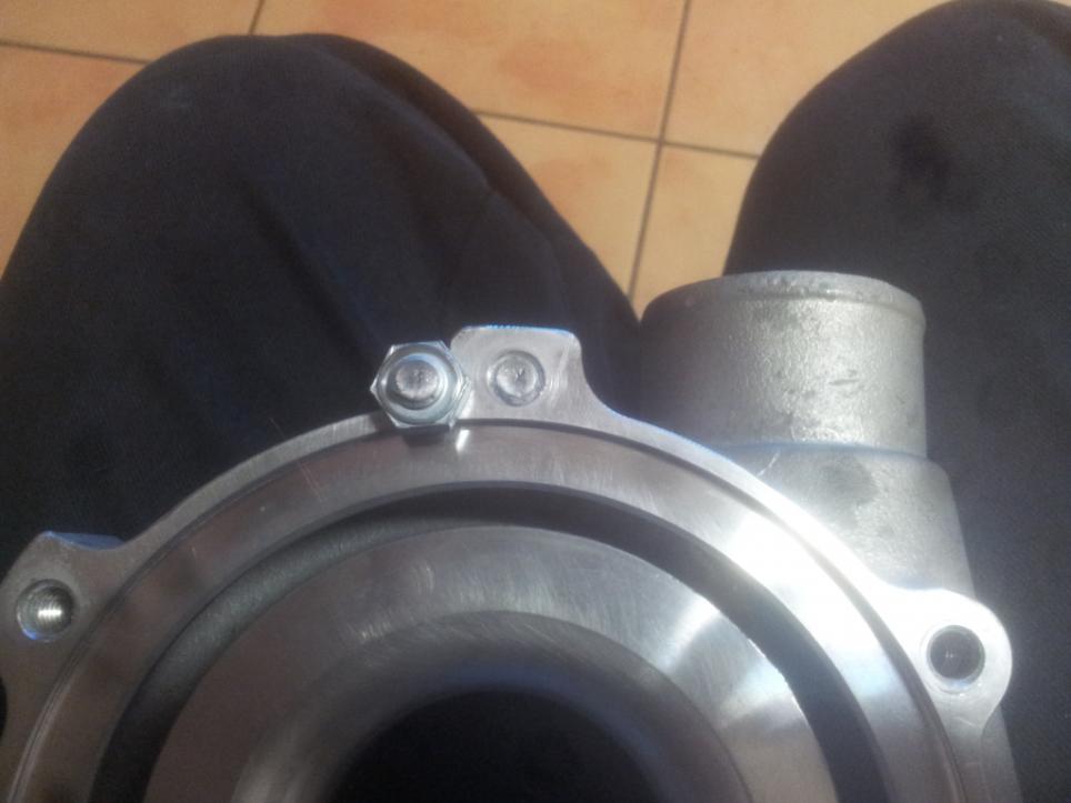

bugger, take your time and speaking from experience (i.e. i'm not a mechanic) i would drill the centre to allow the largest dia. easi-out you can use. i have used the really small ones before and snapped them off in the bolt, you really don;t want that to happen...
Drill and easy out. What's the bolt made of? Is it plain looking steel. I nearly said leave that until we get it ready to go on..... Doh!
guess i was to eager, whoops . im not sure if i should have a crack at it. might just leave it for you to do if that's okay the bolt seems to be made of a very soft steel probably to protect the threads of the aluminium housing
and damn you i now want a bigger turbo also
Is there anything sticking out the back to grab with some grips. I have found in the past that drilling through generates enough heat to loosen bolts off.
Richard is right though. The largest diameter easy out is the one to use. Snap On have some that are parallel rather than tapered, they seem to work ok in aviation.
Don't kill yourself to get it out, we can do that when the time is right.

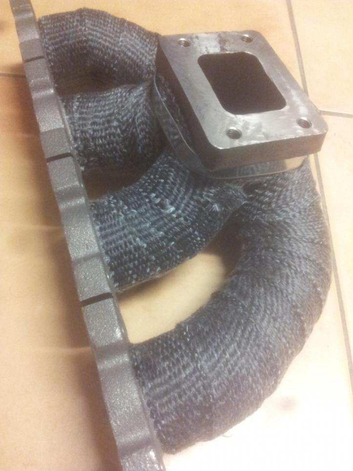

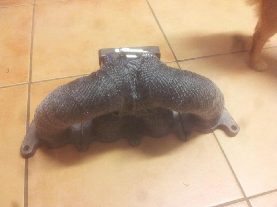

well the theory is that it keeps the heat inside the manifold which helps the exhaust gases flow faster. plus will help keep the compressor housing and wastegate actuator cooler
