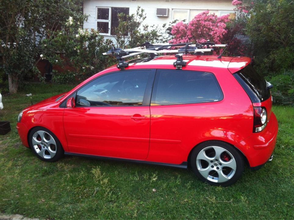

      • Got the windows tinted finally, then washed it. Shiny
