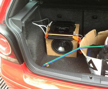

    Installed a small sub and amp, new 8", amp and materials for the box cost $200 all up. pretty good, does not take up much space.
    Nice, The std pog does lack a bit of bass

    • I found with the upgraded HU to a Fusion (Im generally a fan of their mid range and up gear), the system had a lot more presence and punch. The sub is just a toy, I needed a new audio project and I've not done much on the car recently. The rears are lame, but I don't really hear them now the lowest octave is passed.
      Needs some tidying / painting, etc, wanted to get it in and tested, was pretty unsure the system would sound much good, the box is only 9.9L, the longest length is 32cm externally. Its pretty light over all, less than 20kg, 1/2 the weight is the driver (heavy bastard for an 8") and the 16mm MDF (double thickness on the back) adds a little. The amp is cheap, I'm only using 1 channel for now.

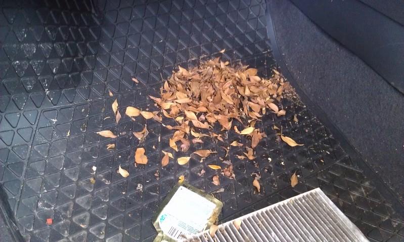

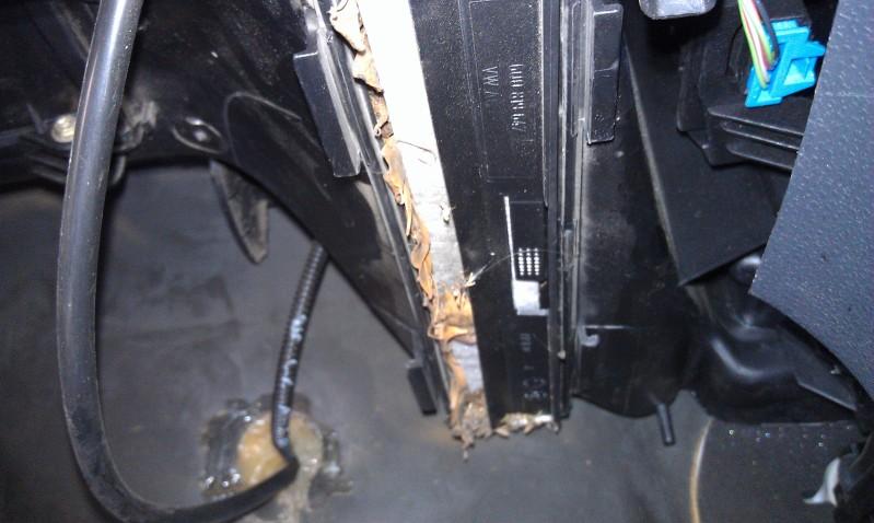

                          • New Pollen filter. I reckon it was due. Anyone disagree??

                              I pulled mine a week ago and gave it a good couple of hits against the wall to get rid of all the leaves and crud, didn't have anywhere near the amount of leaves as you had though.
                              Made the car smell significantly cleaner and should last until it gets serviced in June.
                              • Haha, mine has looked like that... Funnily enough, after twice having paid for a new one after services!!
