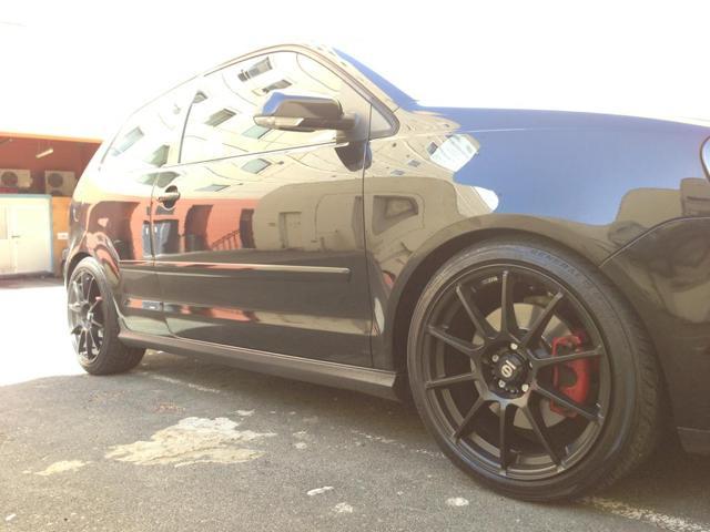

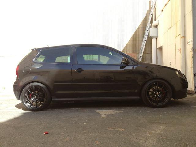

Hey All,
got my suspension and bushes done today - have a looksie
only one problem though, the workshop I went to couldn't figure out how to fit the lower rear control arm bushes (SEAT solid). I know Gavin has done them in about a hour with the right tools.
What are other people's experiences with fitting these bushes (costs & time)? I really don't want to pay for another wheel alignment, so hopefully I can tell the workshop how to fit and they can do the alignment for free.
I've read you can do without taking off the control arm and only the subframe.
All help appreciated
Thanks
Thanks
the sparco's suit well!What’s behind you doesn’t matter..
