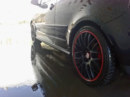

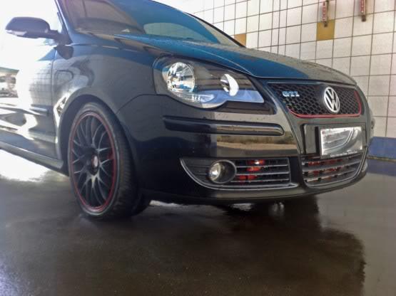

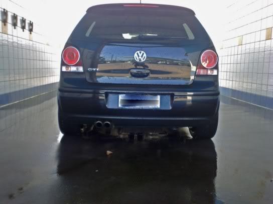

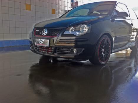

 Ill post some up if you want mate, only they are boring sitting on the road shots.
 Ok you have washed it mate, then did you cotton bud the engine bay????? Seriously people mega clean engine bay. I opened the bonnet and looked and looked, cleanest ive seen in a while.

 im a lil anal about how she looks sometimesOriginally posted by Jmac View PostIll post some up if you want mate, only they are boring sitting on the road shots.

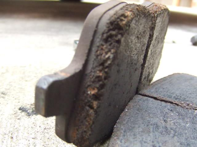

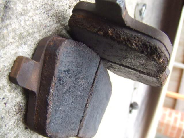

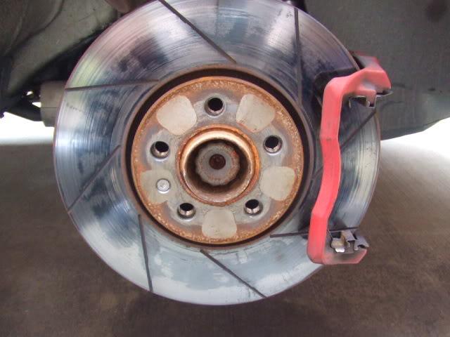

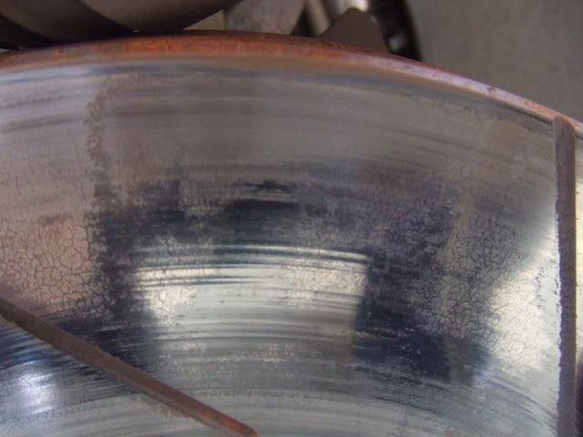

 After the track day at oran park i always new that i had cooked the ferodo ds2500 pads and ebc rotors but i decided to let them be till today when i swapped the pads back to my previous ones and
 anywho pics say a thousand words

 I'd be changing the brake fluid out too.Originally posted by bfeboi View PostAfter the track day at oran park i always new that i had cooked the ferodo ds2500 pads and ebc rotors but i decided to let them be till today when i swapped the pads back to my previous ones and

 Ive been to a few track days at wakefield, eastern creek and finally oran park but, i fitted the martini fluid, ds2500 and rotors for oran park and as you all can see they got munched hard.
 ive gone through 2 sets factory pads they were never this bad.... maybe i should go for ds3000 or red stuff.. but atm i think i'll be needing a new clutch soon. pick up is getting quite late but atm i think i'll be needing a new clutch soon. pick up is getting quite late APR V2 | APR Downpipe + custom catback | APR solid mount | FMIC | SEAT intake | BMC filter | FORGE 007DV | KW v1 | WHITELINE RSB APR V2 | APR Downpipe + custom catback | APR solid mount | FMIC | SEAT intake | BMC filter | FORGE 007DV | KW v1 | WHITELINE RSB

 I get the feeling that the ABS kills the brakes faster than normal. After my wakefield day my brakes were pretty brutalised, but I don't see the value in keeping the stock rotor size if you plan on further track days.
 Maybe a 312 upgrade will give you better results, I found the cost of the rotors / pads to be not too dissimilar so once they're on, assuming brake feel is good, can only be a win...
