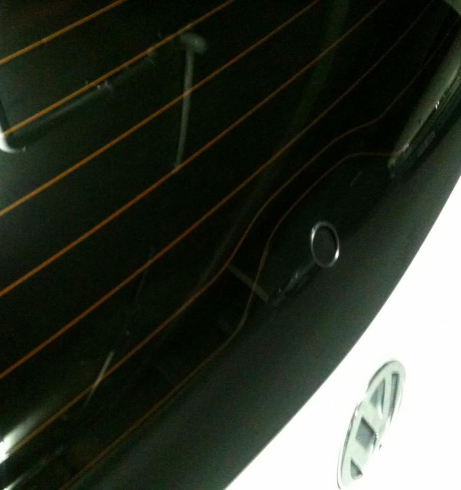

                              • Gecleant Rear Wiper Delete

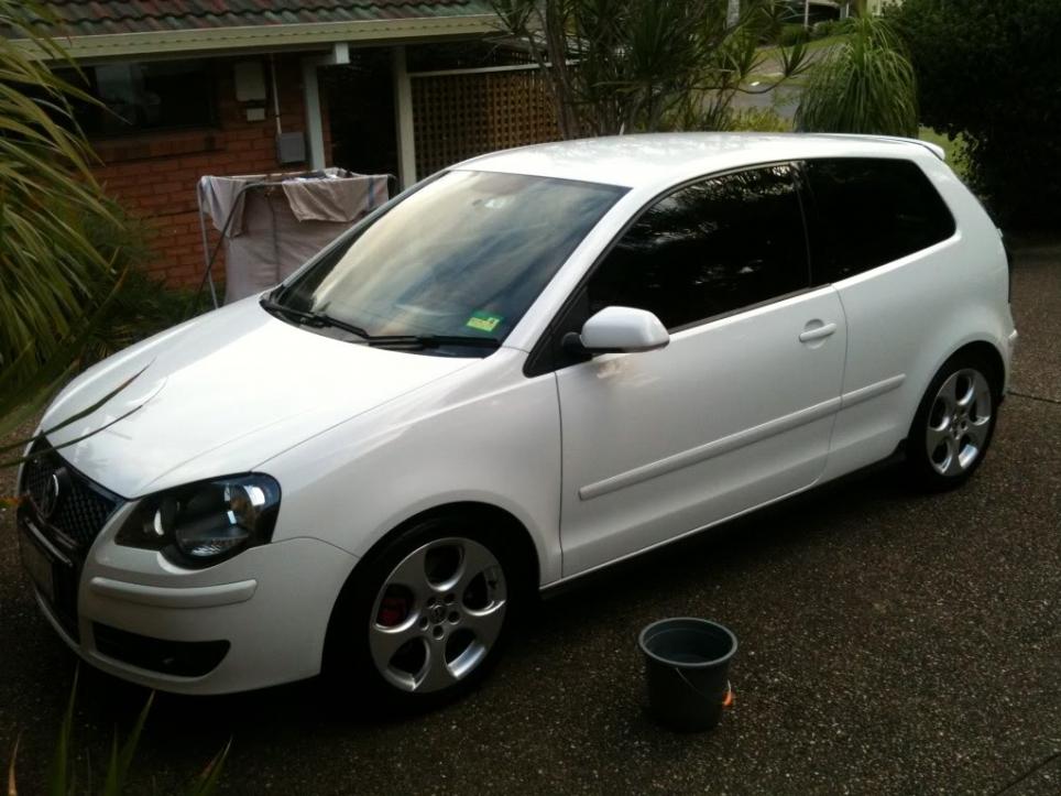

                                Finally got round to cleaning the car, pic below shows after fitting of the coilovers -

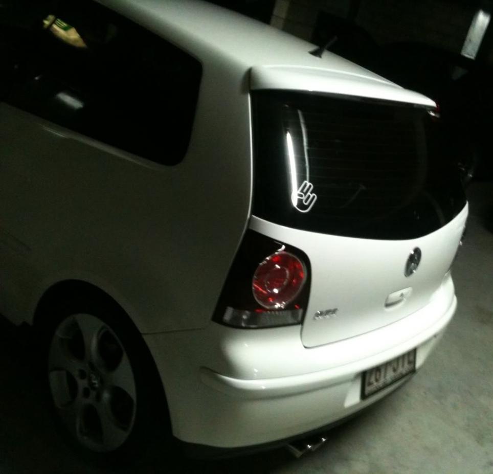

                                And rear wiper delete damm clean baby....
                                To do this you will need one of these CNC'd PLUGS and you will need to follow this 99.9% correct GUIDE. Only alteration I would make is to get the rear wiper arm off get a large shifter, grip the arm just to the left where the wiper attached and give it a few hard yanks to loosen the wiper arm off the splined shaft... Oh and yank really hard on the plastic trim to remove it. The rest is piss easy!!!
                                The express postage was super fast (~1 week) from Gecleant and would recommend ponying up the extra $10 for the glass cleaning kit and adheasive
