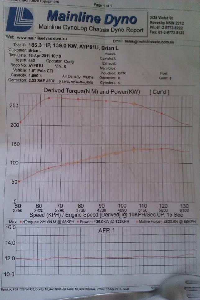

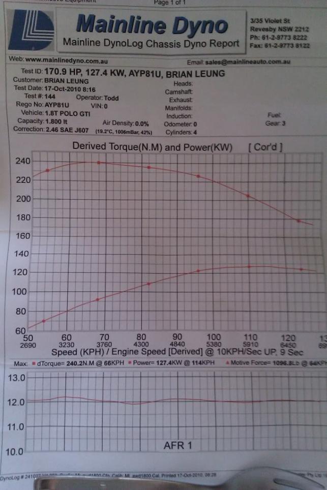

    • found old dyno sheet to compare to the recent syd dyno run
      this is the run after a custom (larger) catback
      APR V2 | APR Downpipe + custom catback | APR solid mount | FMIC | SEAT intake | BMC filter | FORGE 007DV | KW v1 | WHITELINE RSB
      139Kw | 271.8Nm atw - At a new home
      • Nice. Got a sound clip of the exhaust?
