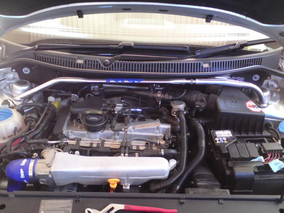

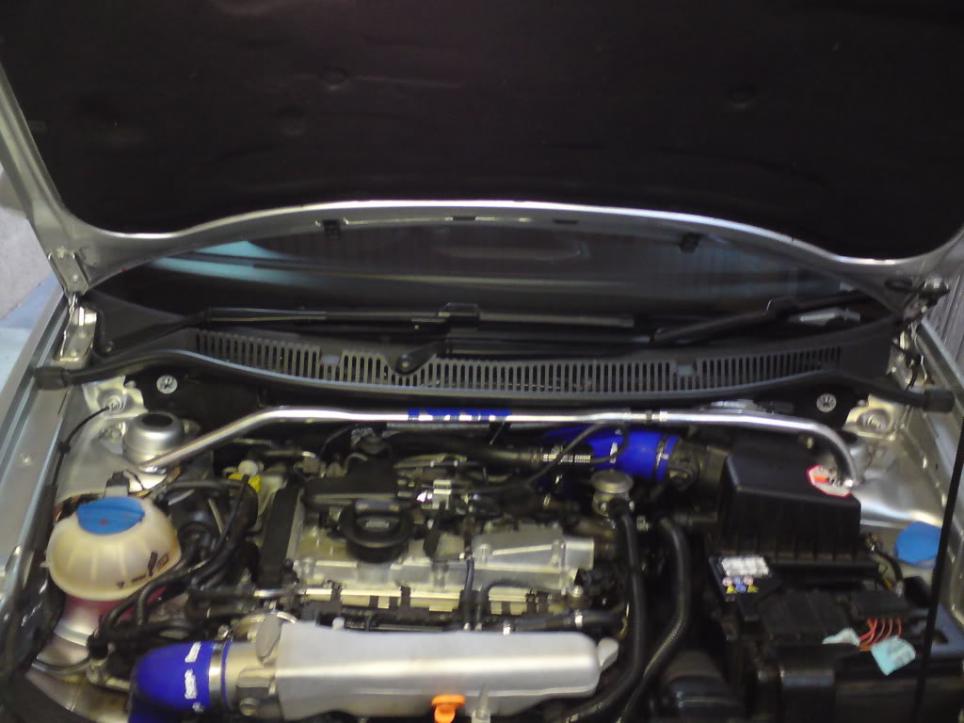

                  Thanks mike/blitzen, i didn't expect anything less, from what i've read here, it's gonna be a challege, but fortunitely i have all you experts here who can help and there are some step by step post here. I'll need to buy all the clamps first.
                  by the way, i've installed the Seat Sports front strut brace today, it's not as straight forward as i thought, i had to force it in, as the piece of plastic on top (where the air vents are) is in the way, not sure if it would cause any problems further down the track, the plastic may crack.
                  It sure does look good though and the Pog handles great

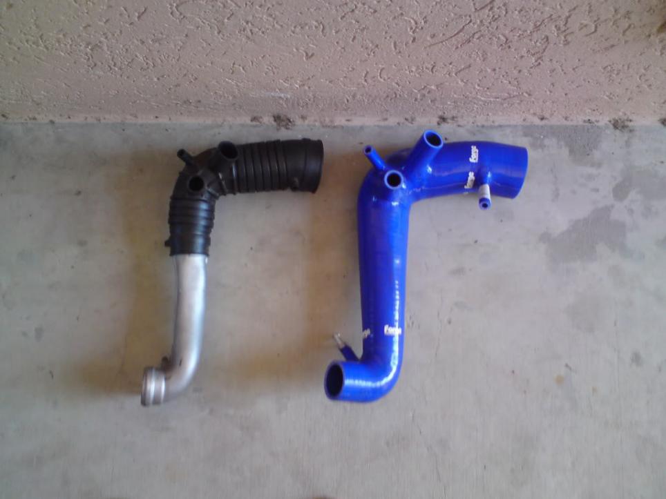

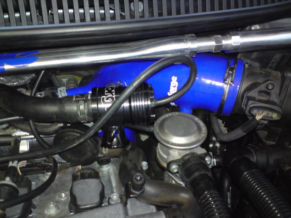

                    • This may help you with the TIP install...
                      Originally posted by Blitzen;233139
                      Before the epic voyage into annoyance...
                      [img
                      https://www.vwwatercooled.com/images/imported/2008/10/018-1.jpg[/img]
                      I then removed the engine cover, strut brace, and air intake box...While I was at it, I gave my K&N filter a good clean.
                      I disconnected all the ancillaries off the stock TIP, then pulled the top part out.
                      Then remove the allen head screw(5mm)that holds the lower metal part of the TIP on the Turbo. This is on the right side of the TIP. this will loosen the Tip so you can pull it out of the Turbo.
                      Also Remove the allen head bolt that holds the heater coolant line. This will allow you to fully remove the old TIP, and give you more room when you install the new one.
                      Old and new TIP's...
                      The lot goes back together in the reverse of how it came apart. Remember to put some soapy water on the inside edge of the turbo flange on the TIP...This helps the TIP slide onto the Turbo.
                      The TIP really needs to be persuaded. I begged with it, asked it politely, offered it drinks, then threatened violence on it before I could get it to fit, but I got it!!
                      The rest goes together easily, but I couldn't get my engine cover to go back on.

                        • Originally posted by Blitzen View Post
                          Thank you very much Blitzen, i saw this post before and i planned to refer to it when i do my, now that you've posted it here, save me having to find the original post again
                          Hope the weather's good tomorrow, so i have give it a crack.
