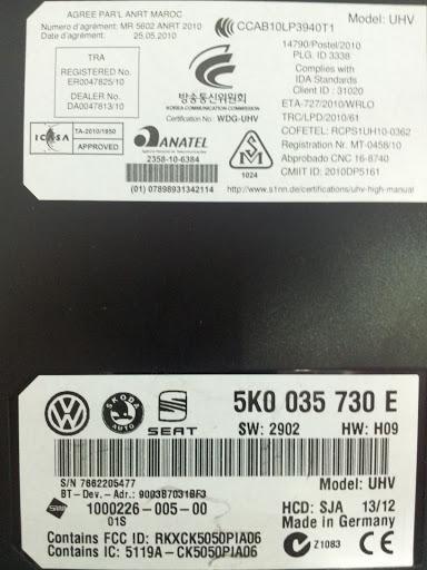

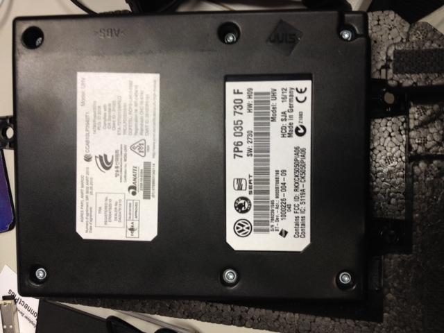

Here's a pic of the 5K0 module, which I expect to show BT Audio ID3 tags and allow track-skipping from the HU and MFSW.
The feature of track skipping and showing song names on the unit should work with all versions of the RCD510 right? Because I have a fairly early version of the RCD510 without the reverse camera plug. Think it was taken out of a MK5 golf. I was planning on maybe plugging my RCD510 into my friends golf who has an RNS with all the bluetooth fully set up. It wouldnt mess up his settings afterwards right when we plug his RNS back in?
Hmmm, just make sure you know the security code for both units.
Interesting to note the different software versions on the 7P6 v 5K0 versions:
Software version 2730 (pontif)
Software version 2902 (me). I guess the sellers who said the 7P6's are the newest unit don't know what they're on about.

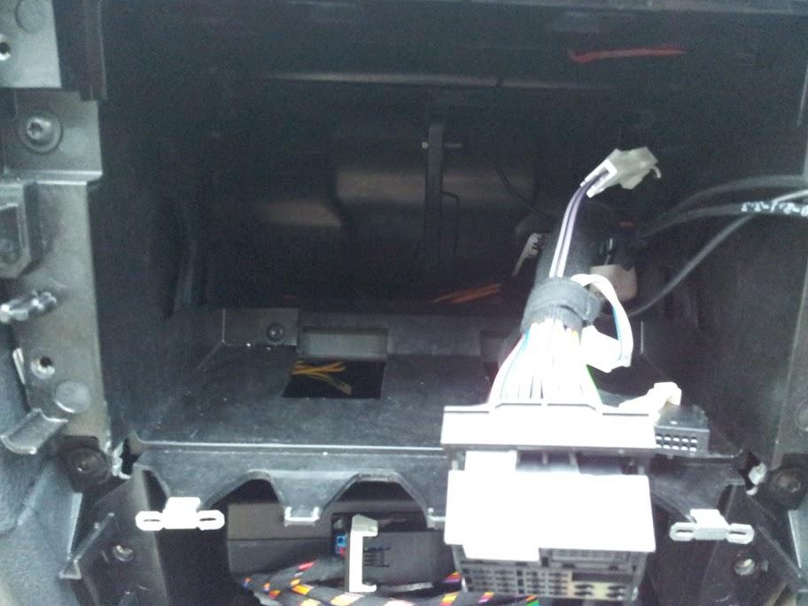

Fig 1: Remove 4x T20 screws for RNS510, and 4x T20 screws for climate control.

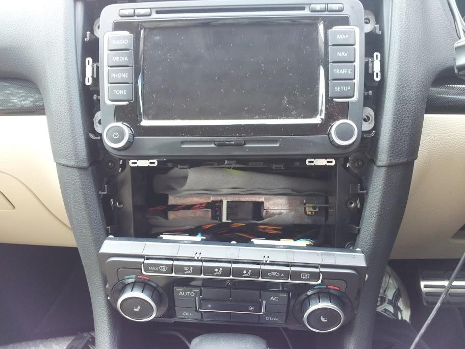

Fig 2: Pull the climate controls out a tad and the old 9W3 BT unit is revealed, surrounded in foam to prevent vibrations. Rotate and slide out, then disconnect BT.

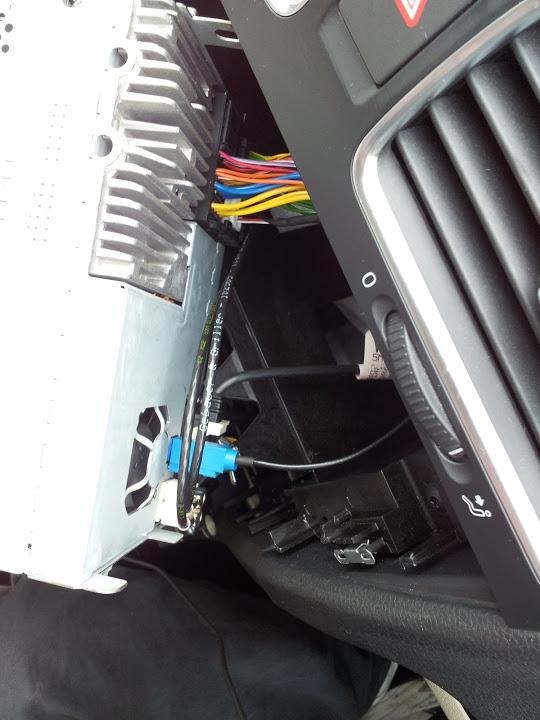

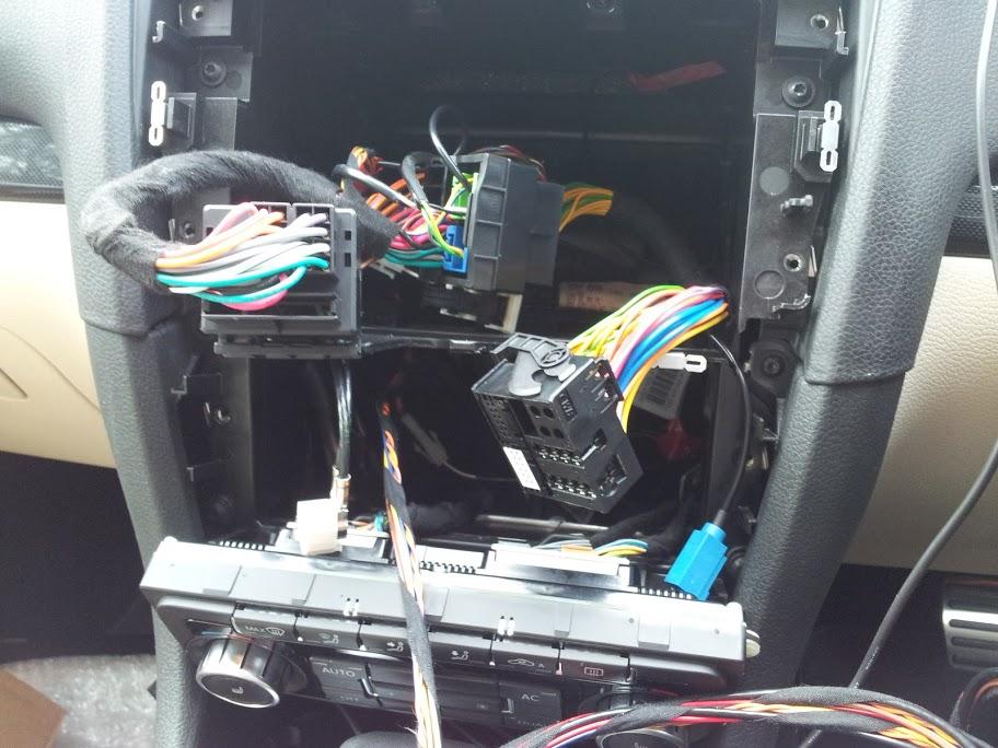

Fig 3: Some tricky locks on most of those cables to make removing them just that little bit harder (easier if you've done it before). My reverse camera video cable was short, making it even harder for me to get my hand in there. Given that that's the most recent part I installed I'm surprised I didn't give myself more room, unless the cable wasn't long enough. to start with.
Fig 4: Photo of the labels for future reference. Purchased this one nearly 2 years ago now. Now that I actually look at the label I can see the AUX pins (1, 2, and 7). That's where my AUX-IN cable is connected (3 harnesses away though).
Fig 5: Ummmm, which witch is which again? :p One is the original car connector, one is the MDI retrofit harness that I added, and another is for the BT.

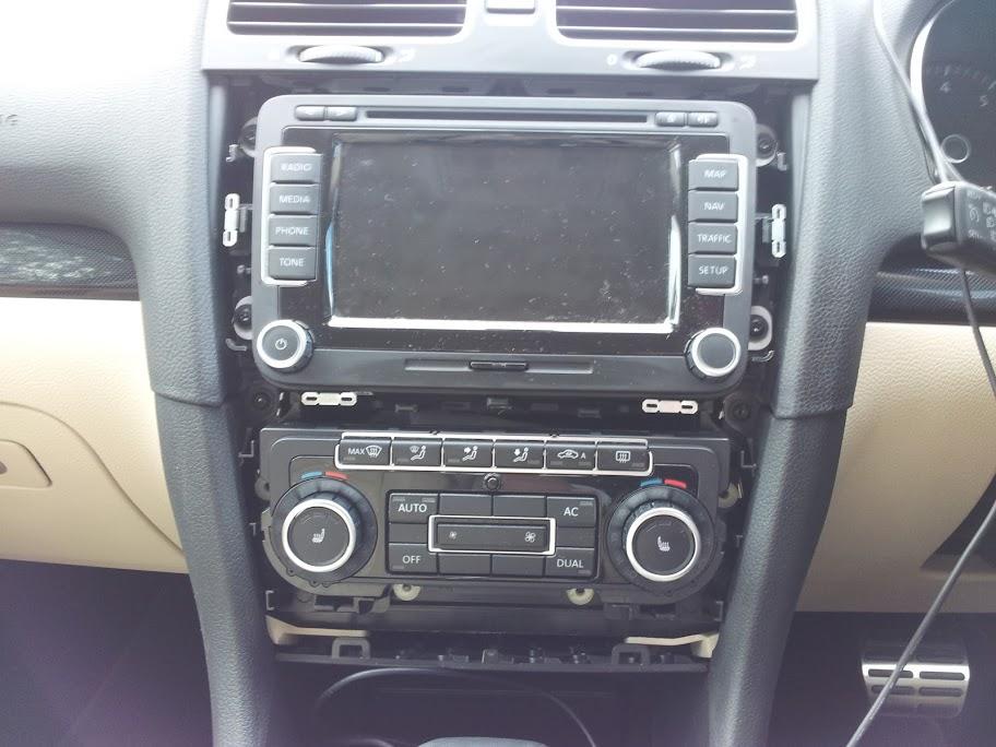

Fig 6: Got everything connected and hid the other two harnesses below the bracket that the HU rests on (otherwise you won't be able to push it back far enough). Original car QLC plugs into MDI QLC plugs into BT QLC plugs into the RNS510. I had the MDI and BT harnesses around the other way before since my old 9W3 BT harness didn't have as many wires passing through).

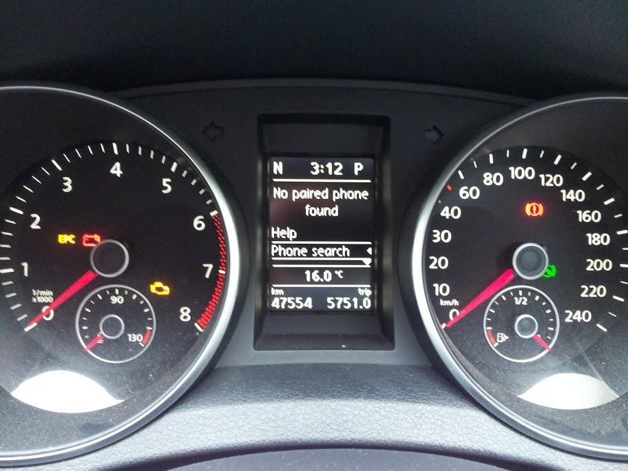

Fig 8: Finding my phone. Didn't ask for a PIN which was strange/interesting.

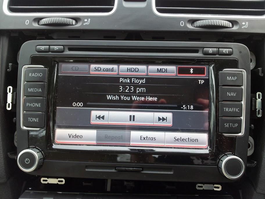

Fig 9: Verify ID3 tags are displayed and track skipping works. Brilliant. 5K0___ is the unit you want, to reconfirm.

Hehe, I had to test the track skipping feature a few times to get a decent song up before taking the photo. While it does show the song length it doesn't show track progress, no big deal for me.
